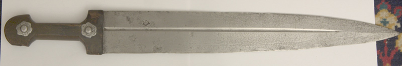

Dear All,
Here is my newest stuff - kindjal.

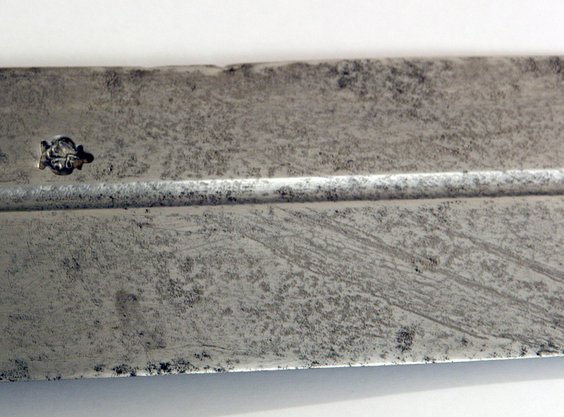

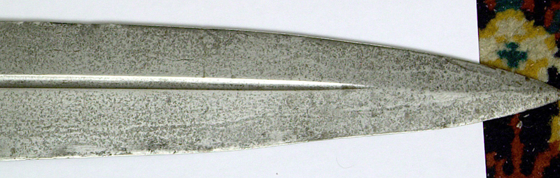

Attached - overall view, lamination lines at the tip, straight lines (what is it ??) at the base, maker's marks.
Can please someone help me with what kind of lamination/steel work it is ?
Maker's mark I think reads "Amale Shda" - made by Shda ? Oh, those who know arabic please correct me !
Should I experiment with vinegar or FeCl on this one, or the pattern is already well seen.
I also think it's really close to Astvatsaturjan page 355, on the bottom, third from the left (Transcaucasian marks).
It's unusually big (which votes for Transcaucasian origin), however it's two screws rather than 3 screws mount, and extremely unusual hilt for a Georgian kindjal (one part, lightly colored wood). Looks like an old shape.
I feel fantastic about this kindjal - it's heavy, 3 pounds, but it's so greatly balanced it moves very quickly, the only thing that gives away it's weight is that you feel tired after swinging it for a prolonged time.

Default lamellar structure of blade
From the photos, it appears as though your blade might be a tripartite construction. A central plate of high-carbon steel is sandwiched between two plates of iron or lower-carbon content steel. When the bevels are ground into the blade, the edge plate is exposed and when the blade is etched, appears as a narrow zone along each side. The gently undulating line that you see along the edge, a short distance from it, represents the demarcation between the plates. Often, the two "cheeks" on either side of the edge-plate may be laminates of iron/steel, or may fashioned from billets which are folded upon themselves, longitudinally, several times. In such case, a good polish and etch will reveal lengthwise striations between the exposed edge-plate and the central fullers.
This type of tripartite construction is quite common in a number of different cultures: China, Japan and Korea, the Philippines, parts of Europe, and other places.

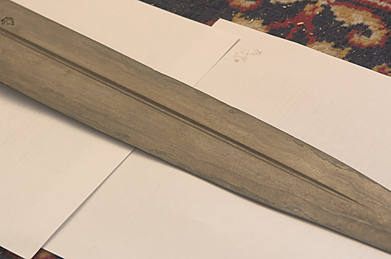

Here is the blade after FeCl etching. I've seen this structure many time but what is it - I have no idea. I thought it's tri-partite, but it's actually formed by 4 (2 at each side from the fuller) separation lines. All of these lines are actually 1-2 mm thick. You can see on the picture 3 such lines - 1 very close to the edge at the foreground, and other two surrounding the fuller. Is it tri-partite+hamon ???

It looks like an inlaid edge. Presumeably the other line occurs on both sides?....I guess it's a 5 (macro) layer situation, although both outer layers look to be more or less similar layery/fibrous material (probably wrought iron).

Thank you, that's exactly what I thought. However after staying for the last couple of weeks in "post etching" on open air, the blade started to show another two sets of lines on each of the sides.
I'm now thinking if I want to really deeply etch fuller in search for a damascus twist.
