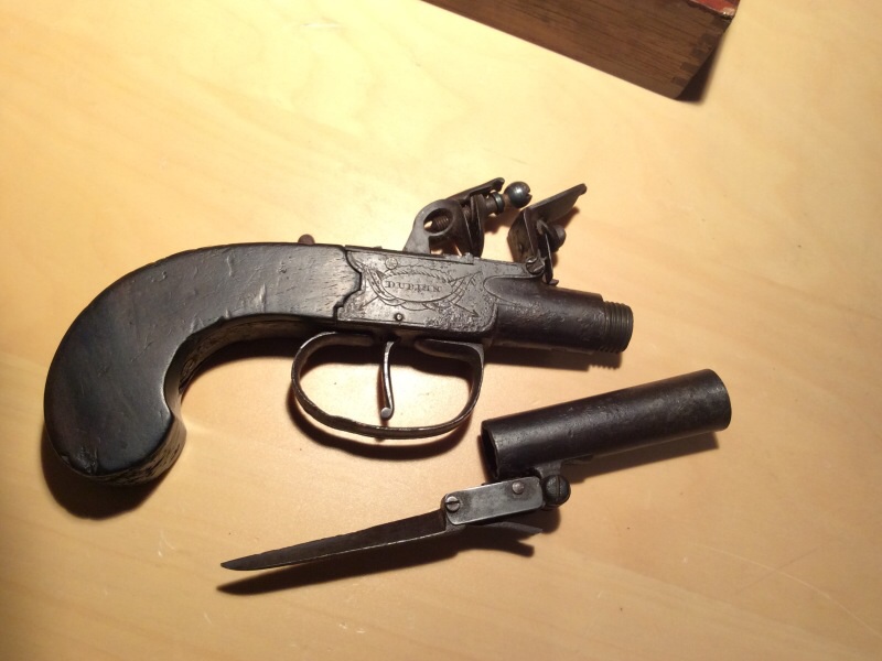

While I had the camera out I took a few photos of another gun with a bayonet
Again this is an irish one

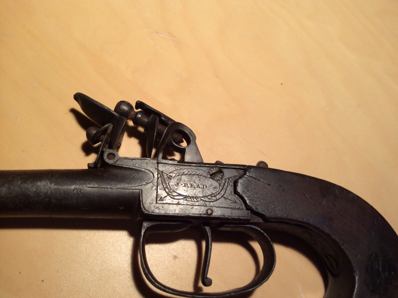

This one was made in Dublin by the prominent sword maker J Read of Parliament street

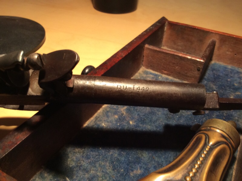

You can also see Dublin registration mark
DU 1442 on the barrel
Lovely little pistol with barrel unscrewing and all mechanism working

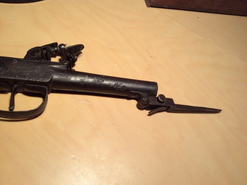

Bayonet is released by pulling back on trigger guard
Hope you like this gun, picked it up in a junk shop for less than 2 take out pizzas
All the best
K

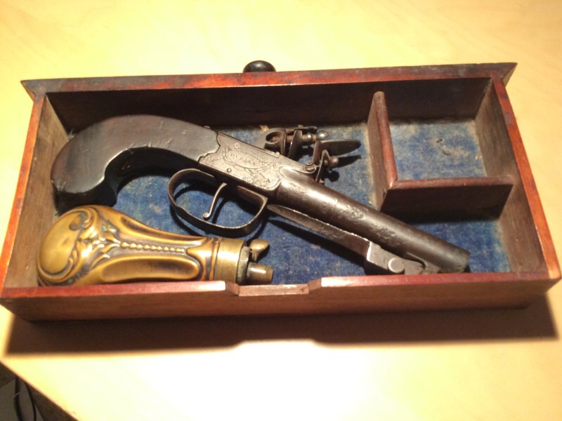

The box and powder flask are not original to the pistol, the box is an old traveling balance box, ground it in a car boot sale and reckoned it would work which it thankfully did. The flask is an auction pick up which I think matches. Bullet mould has yet to be found
