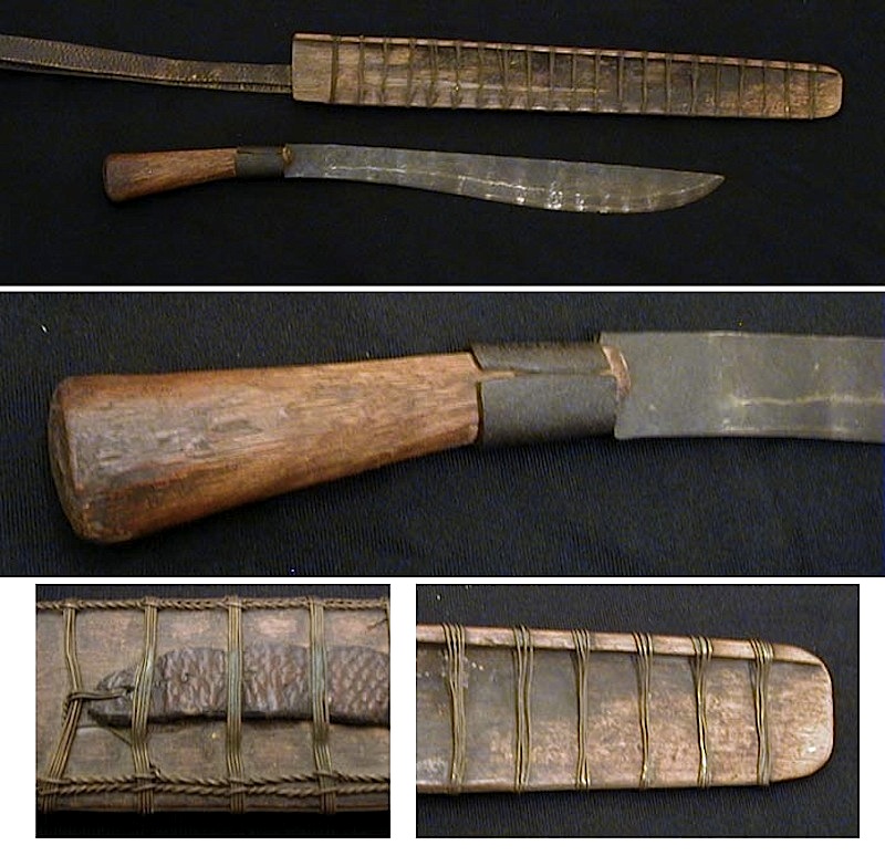

Another one that I acquired more than 15 years ago and have seen very few since then. Note that the open sheath has a single raised edge corresponding to the back of the knife--this is a typical arrangement in my limited experience.

An interesting example with interesting similarities Ian.
The Bolo shape and non flared pommel have me thinking of other influence though....so little known, so few seen...

Yes, I agree Gavin. The chisel-edged fat belly is certainly reminiscent of Visayan tenegre, for example, and the hilt does not look quite right (I got this off eBay where it was listed as a Philippine bolo). However, the scabbard is certainly distinctive, especially the bands of copper wire and the attached leather strap, and judging from the marks on this old blade it has been in that sheath for some time.
Another two examples I have seen that were provenanced from Nagaland did show the more characteristic hilt, an iron ferrule, and slimmer blades. The sheath on both had the raised edge on the backside of the blade and one was bound in copper wire while the other was bound with rattan strips. Overall length was probably about 12-15 inches, although I did not have the chance to handle them and my notes indicate only an approximate length. Unfortunately, I don't have pictures of these other two.
As you say, just not a lot of data to go by with these knives.
Ian.

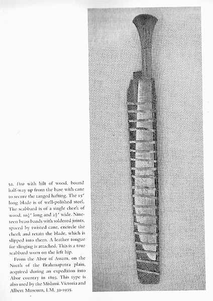

Posts: 4,738
Default One more from Rawson
This knife is attributed to the Abor people but is also found among the Mishmi. The sheath is again open-faced, wooden and with metal bands. There is again a wooden lip on the side of the sheath that corresponds to the spine of the blade.
