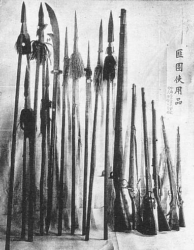

Shafts - I think Timo had a lot of good info. Also, I have seen in several period photos that waxwood appeared to be the wood being used for "commoners" spear shafts. I bet the use of one material or another was also relative availability in the area. It may also have been relative to your pocketbook so to speak. I see fancier pole arms with well finished shafts, while more village like spears have functionally finished/bumpy surfaced staffs like many Chinese martial art practitioners use today. A nice mid thickness waxwood staff has both the strength and potential flex to absorb impact shock rather than break. That is what I am using on my spear and have had good results practicing with them for years.
Butt spikes- I have seen them on other pole arm examples but not spears. I would not count it out though. From my experience variability seems to be the norm in Chinese weapons.
Length- Back to the variation being the norm comment. As you can see in the photos there are long, short, and in between.
Tassels- Good question. I have seen photos of them in use from late Qing through WW2
Pictures - 1. Presented as confiscated weapons from "Manchrian bandits". 2. I think I pulled this off a Chinese site. Looks like Warlord era to me or Spear Society. Could be wrong.

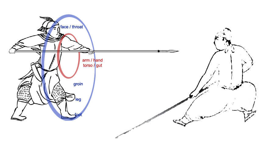

EDIT: slightly off-topic, but... for those who have read the 長鎗法選 or a translation of it, what are they referring to in terms of inner circle and outer circle? Perhaps I know what they are referring to but not their terminology...
Centre and periphery, I think. If you hold the spear with right hand forwards, the spear is to your left. A thrust coming in on the right of your spear is in your inner circle. A thrust coming in on the left of your spear (perhaps to face or left shoulder) would be in your outer circle. Think of "inner circle" as the space between your spear haft and your body. Outside that is the outer circle. For the grip above, with spear on left, I don't if outer circle includes the right side of the body (so the whole torso), or only the left side (i.e., the side closer to the spear).
