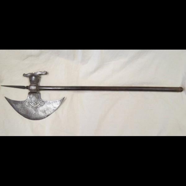

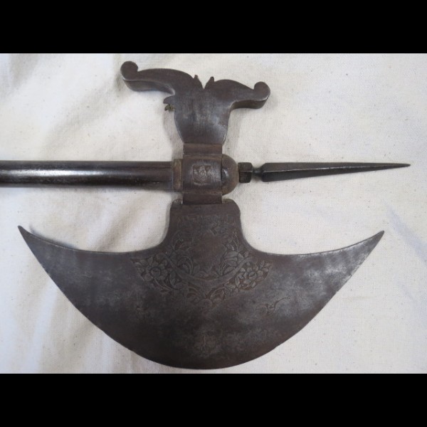

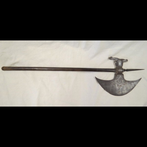

Do you think this Persian / Qajar axe is a fake?
How to reconize a good piece??
Thanks
K

How do you define fake? Modern made but in the style of Persian Qajar period axes? If that is your definition of fake, then no, this is not a fake. It is a late Qajar period axe. How do you recognize a good piece? Depends on what your definition of a good piece. What do you look for in a good piece? This could be considered a good piece for a number of collectors and this could be considered a fairly average piece for a number of other collectors. I think you have to determine what you are looking for yourself. Do you want a functional, battle worthy piece? Then this is not it. Do you want a piece that is probably of wootz steel? Then this is not it. Do you want a piece that has fine chiseling? Then this is not it. Looks to be an etched pattern. Do you want a piece that is legitimately Persian and of the Qajar period that would be used in theatre or ceremonies? Then this is a perfectly good example.
Old 3rd June 2014, 03:48 AM   #3
Oliver Pinchot
Join Date: Sep 2012
Posts: 476
Couldn't agree more, Rick.
I would add only that, like most of this type, it is assembled in three pieces. Somewhere along the line, the head was inverted.

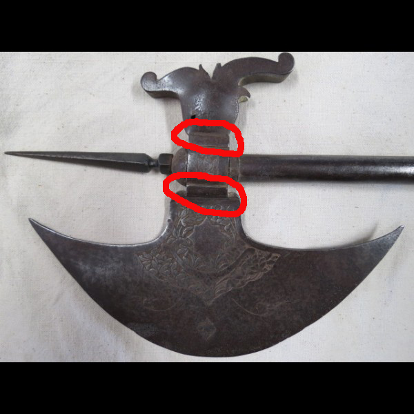

My question is related to some extensions between the pole and the blade.
In most of the Persian axes that I have seen there is no such little intermediary pieces (in red).
I'm right or wrong??

Cthulhu's observation is a good one. By the latter Qajar Dynasty, more complex construction, and by extension, imagery, usually preceded simpler work. This was driven largely by expense: if a dragon's head which was cut out of sheet looked indistinguishable from one more carefully wrought when viewed in profile, a shift in production could take place quickly. Kubur's question as to the construction of the head and the appearance of the blocks indicate workmanship of a higher grade; this is supported by the complex construction of the pean as well.
Nasr alDin Shah Qajar singlehandedly revived the arms-making industry in Iran during the second half of the 19th century. The products wrought by smiths in this period are often of excellent quality. They represented a brilliant if brief rebirth of the armorer's craft before its ultimate demise.

Currently it cannot be called a fake, because after 100 years anything becomes antique:-)
But it is certainly not a fighting example and never was. Any fighting axe has a wedge-like profile. This one is flat.
Decorative would be a better word.

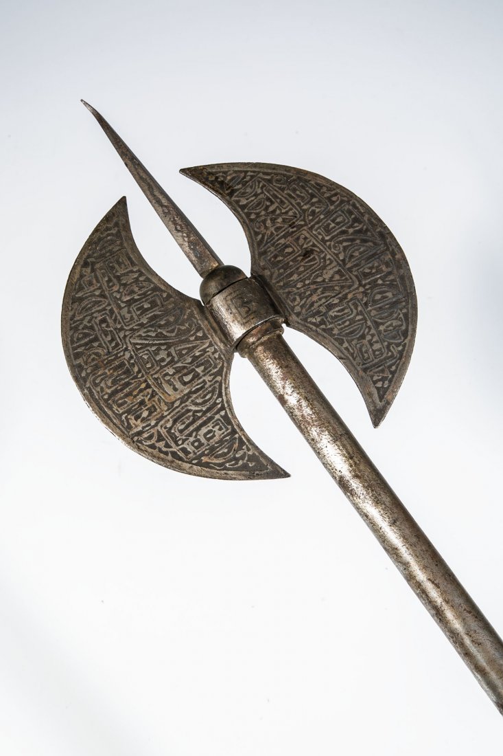

I enclose one double headed axe that I guess is from the 19th.
and connected to what I said.
Any ideas, comments or more photos??
