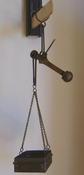

I could start by suggesting that this scale is for weighing gunpowder, to associate it with Ethno Arms & Armour Miscellania, but i wouldn't be honest . So i post it under the cape of Ethno Miscellania... in general .
What i was told by the (dubious) street fair seller is that this is a 'Garimpeiro' scale, name given to placer gold miners in Brazil. From this assumption i built a story upon this device.

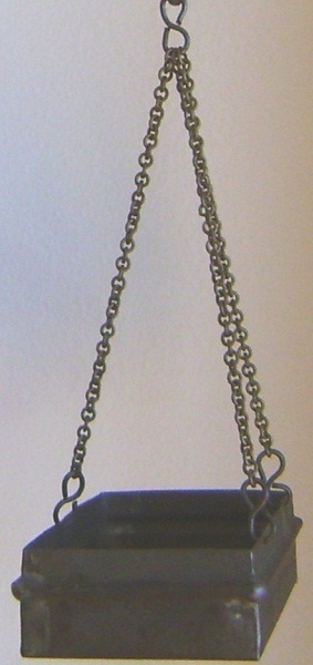

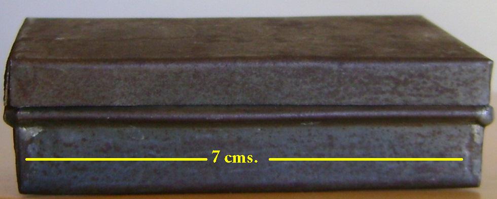

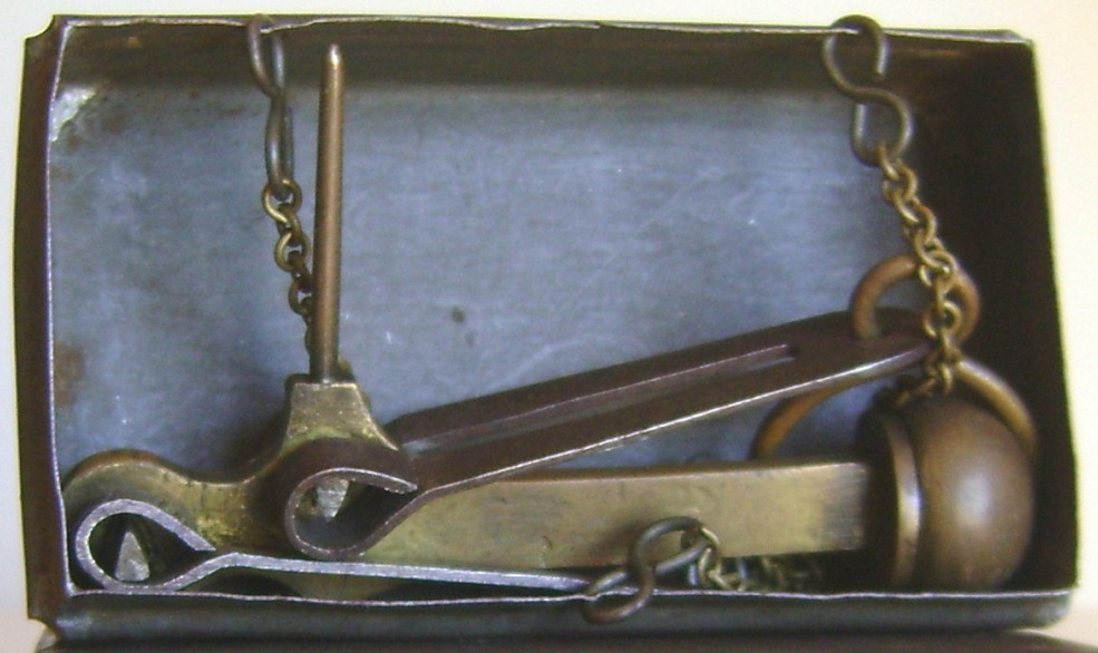

For a start it is small enough to carry in the pocket, and portable enough in that its pan is part of its case; both making sense for a wandering miner.

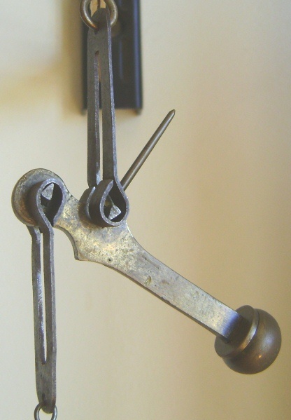

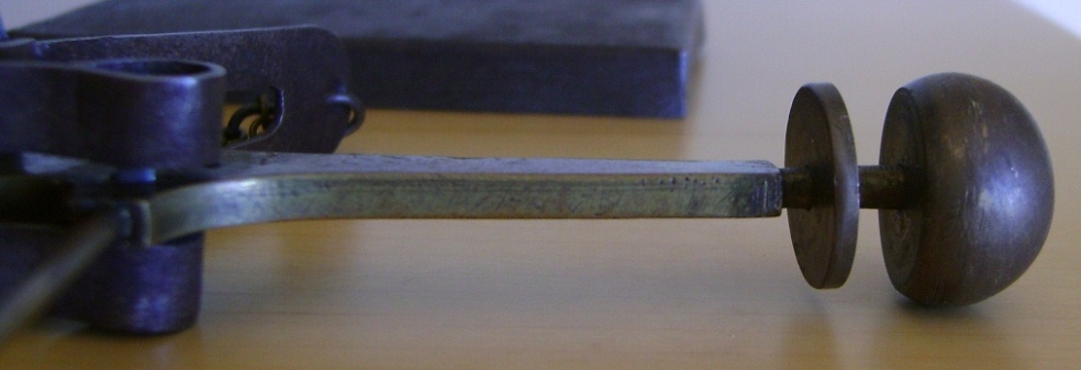

Then my research went for the 'modus operandi'. This scale has no scale, that is, it only measures a unique weight, by means of correct equilibrium of its pointer. I made a few atempts and realized that the weight to be checked is about an ounce; an ounce of gold, it would be; like the miner using it to gather gold by the pound before going to town and submit the lot to the buyer precision scale. Amazingly it has an extra 'washer' before the (dismountable) counter balance, as if it were for measuring different types of ounce... or cheating .
But one big problem arises; i have browsed a zillion times on miner scales, both in english and portuguese (brazilian) and nothing compared to this thing shows up.
Do you guys have any ideas on what this actually is?

I would guess the washer is somehow a method of calibrating the scale.
Richard

Fernando, like yourself, I'm only speculating, but if the counterweight can be moved further out from the fulcrum, and held there by placing the washer against the bar then you could weigh ounces, grams, or whatever. For example if you were to put an ounce weight in the tray, then adjust the counterweight until it is in equilibrium you would know anything subsequently put in the tray weighs an ounce. .This may have been useful to persuade customers etc, they were not being fiddled. Similarly, say for 100 grms
Initially, I thought these had a "western" look about them but now I'm not so sure. I can't see any reason why they should not be for weighing gold, but I presume could also have been used for other relatively high value materials, pearls, cosmetics, perfumes, spices, drugs (!), even tobacco etc.
Richard

However, the counterweight shaft is not threaded and the 'ball' is not so tightly secured, in that, once slightly moved out it falls off, not standing the minimum adjustment. So it either suffers from wear or the explanation would be another one.

This interesting item kept me thinking and after reading your last post i thoughed about someting. The ball can be taken out (shaft and all)?
Maybe there used to be more than one ball with shaft of different weights?
There is enough room in the box left for other weights as well.

The counterweight shaft is not removeable, Marcus; it belongs in the scale arm.
The shaft length is precisely that to lodge the present ball ... no less, no more.
