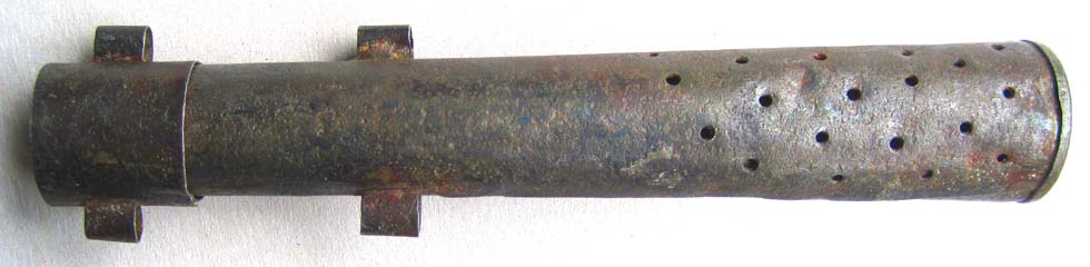

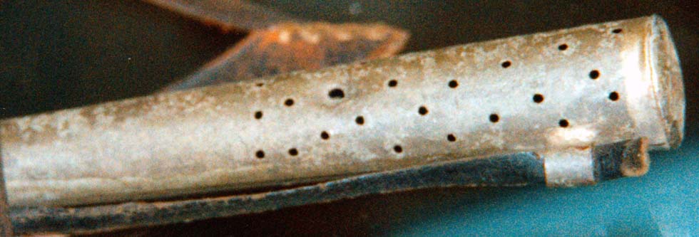

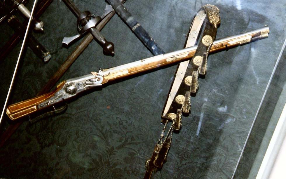

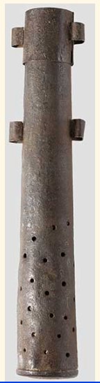

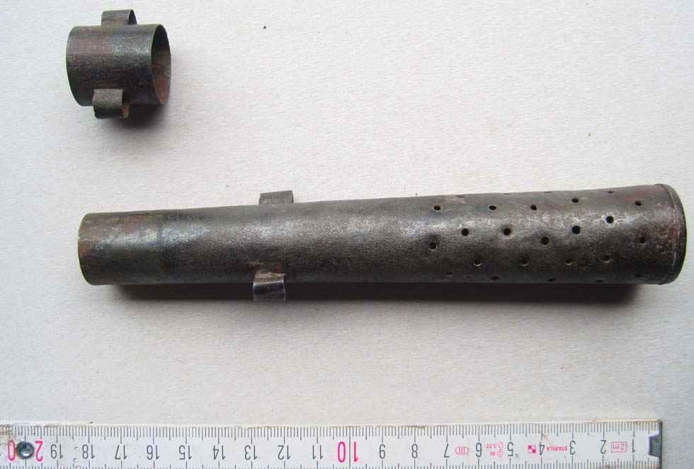

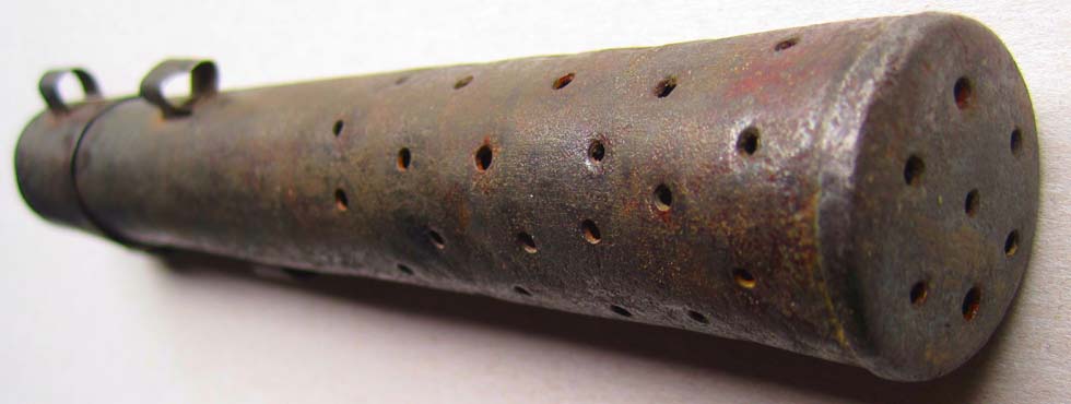

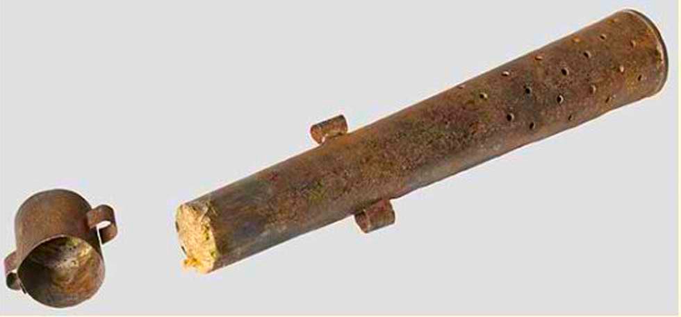

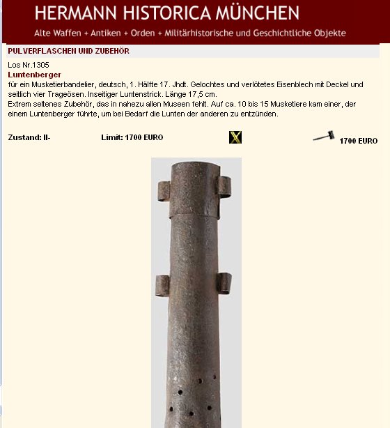

This is the only known detached late 16th or early 17th century match hider, except for a handful of them retained on some of the bandoliers of the Guard of the Electors of Saxony.
It is made of thin tinned and brazed iron with a cap and four rings for a suspension cord. In its lower section and in the bottom there are a few irregular holes for ventilation and a thick piece of hemp matchcord is preserved inside. The overall length of the piece is 17 cm.
Match hiders are recorded to have been carried by only one musketeer out of a group of 15 or 20 in order to enable the others to light their matches in case of emergency. As smoldering match would not only produce a visible glow and smoke but a traitorous smell as well, match hiders are believed to have been used especially on night marches.
The item in discussion was sold Hermann Historica, Munich, on October 5, 2009, at a hammer price of 1,700 euro.

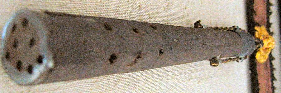

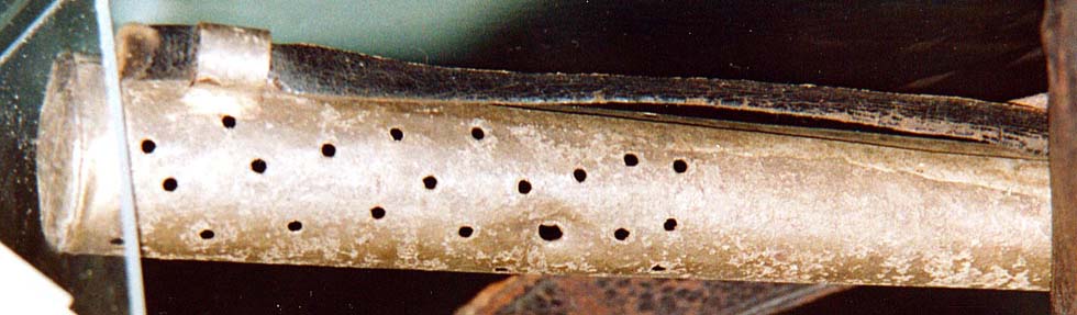

In addition to images of this rarissimum, I enclose a few photos of similar match hiders on late 16th century Saxon bandoliers that I photographed in museums over decades.

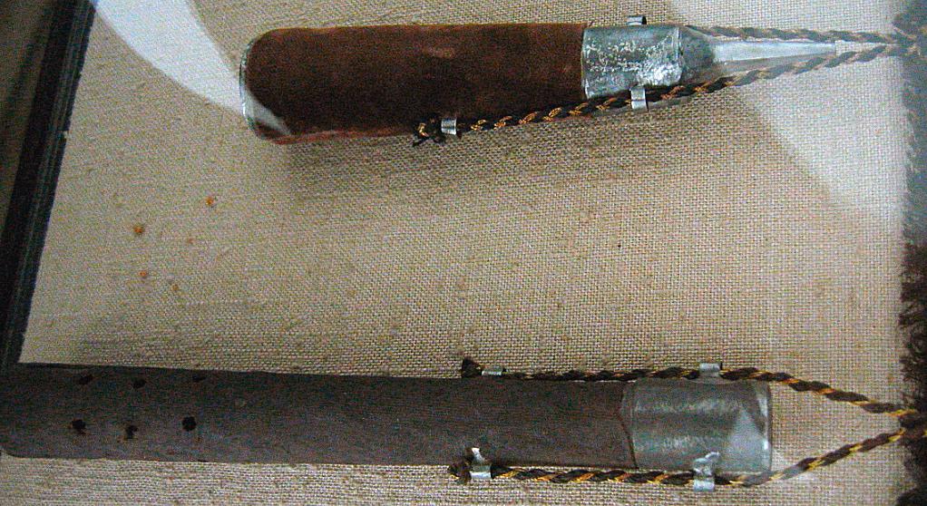

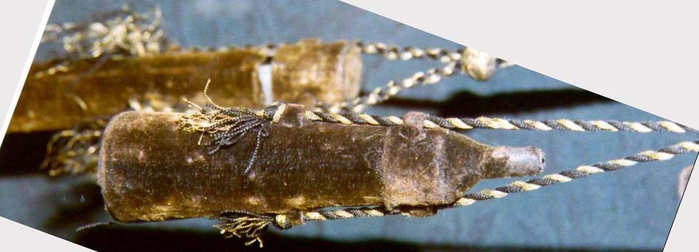

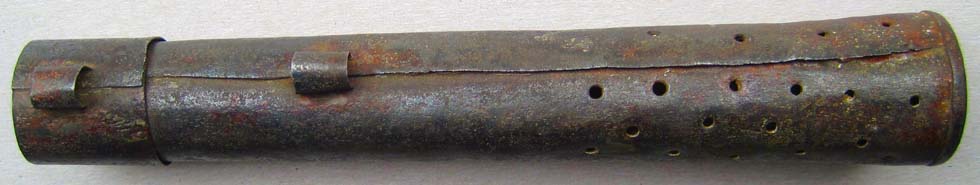

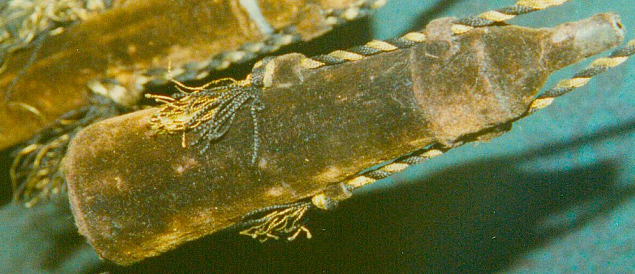

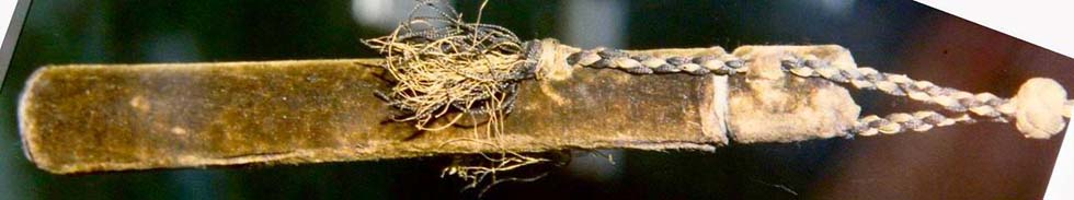

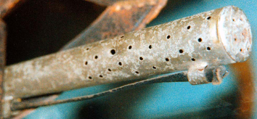

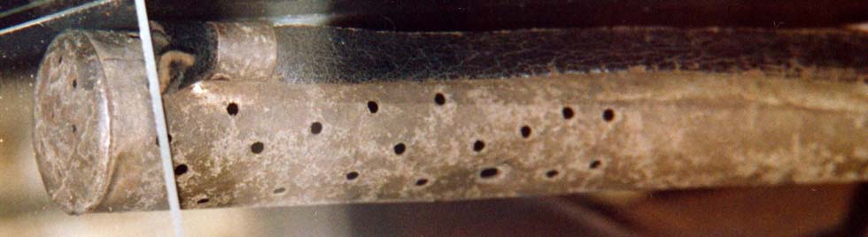

Default Match Containers on Late 16th Century Saxon Bandoliers
... in the Bavarian Army Museum Ingolstadt, the Imperial Castle Nuremberg, and the Royal Armouries Leeds.
Michael

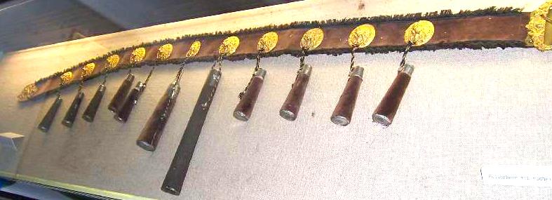

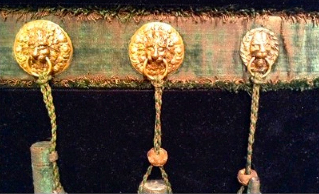

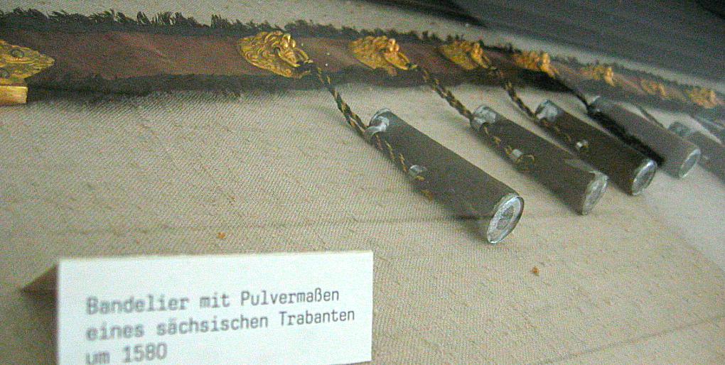

Image on top:
close-up of the cast-bronze lion heads and the top of a match hider (center of image) and a powder container, on a bandolier for a guardsman of the Leibgarde (bodyguard) of the Elector Christian I of Saxony, ca. 1590.
Detail on the extreme right:
tapering nozzle of the flask containing the priming powder.
Image from Peter Finer's site, with compliments.
Please note that the original covering consisting of rep / repp (German Rips), which is perfectly retained on the speciman in the Royal Armouries Leeds (see images in my post #2 above, plus close-up following below), is missing from the tin surface of the containers on this bandolier.
Rep is defined by Wikipedia as a fabric made of silk or wool, or of silk and wool, and having a transversely corded or ribbed surface.
Michael

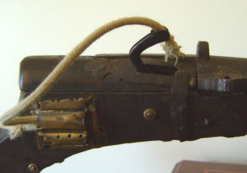

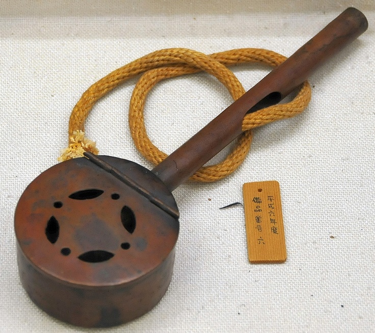

Thanks for showing us another rare item. The Japanese also used a similar item for the same purpose and they are also very rare, here is an example.
Hinawa-ire, container to transport a burning cord. It was designed to keep a match cord burning. It also dimmed or hid the glow at night so the enemy could not see the massed enemy matches.

As the match was not actually kept 'burning' I prefer the term smoldering.

I never knew the precise function of this Indian system.
A match keeper ? Something to compare with the earlier 'smolderer' addressed in this thread ?
... Obviously the match cord in this one is a mediocre solution (a shoe lace, if i remember)
Old 22nd November 2013, 01:23 PM   #10
Matchlock
Matchlock's Avatar
Join Date: Sep 2008
Posts: 4,310
Hi 'Nando,
If you mean the brass tube, that's just a lead for the matchcord.
m
Old 22nd November 2013, 07:45 PM   #11
But what is the lower perforated tube for ?
