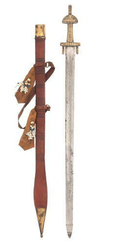

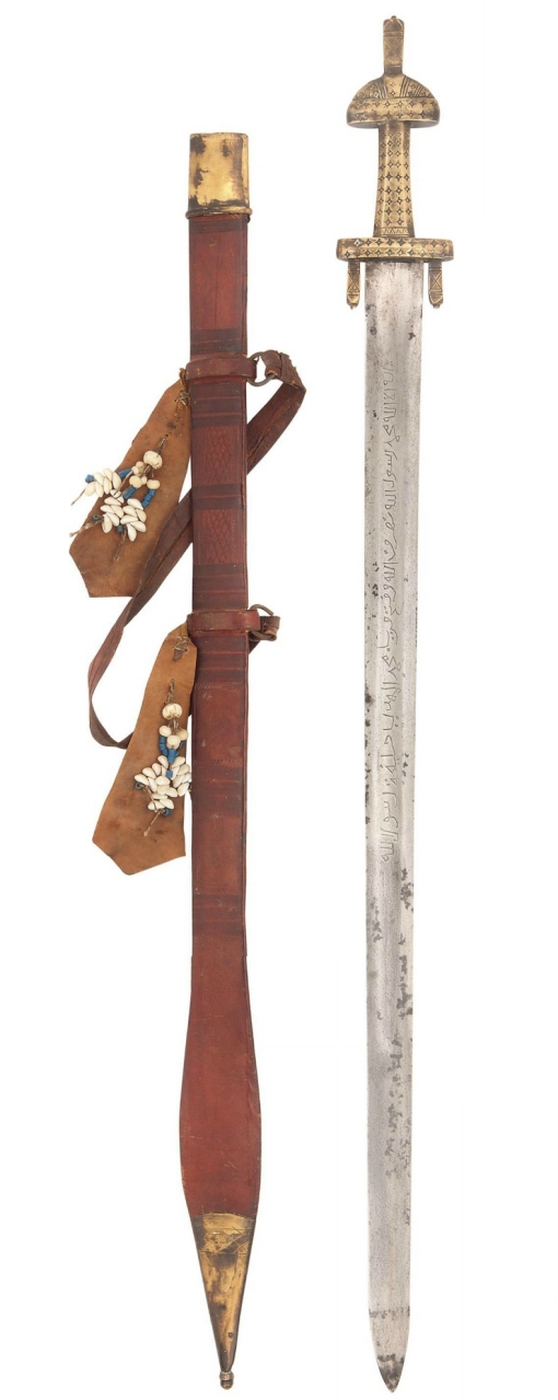

This finished recently at Christies, fetching an enormous sum well above the estimate.
It is a very unusual sword with odd finials on the pommel and guard, which if removed, would resemble very closely a viking style hilt.
Description from Christies as follows:
A LONG SWORD IN THE NAME OF MUHAMMAD AL-MAHDI
SUDAN, 19TH CENTURY
With straight blade inscribed in loose naskh script with the Profession of Faith and the name of the Sudanese leader Muhammad al-Mahdi (La Illah allah Muhammad Rasul All Nasr min allah wa Fath Qarib Muhammad al-Mahdi Khalifa Rasul Allah "There is no god but Allah, Muhammad is his Prophet, help from Allah and present Victory"), one side engraved with a lion within a roundel and pseudo-calligraphic medallions, the hilt with an engraved lattice of quatrefoils, the leather sheath with cowry tassels
43¾in. (111cm.) long
I am having trouble extracting a large image from the Christie's website, but here's the link.
http://www.christies.com/lotfinder/a...f-80e8fe6fde47
It is completely unlike the kaskara of the region and not particularly resembling anything else I can think off. There is perhaps a slight resemblance to the hilt in this thread: http://www.vikingsword.com/vb/showthread.php?t=12979

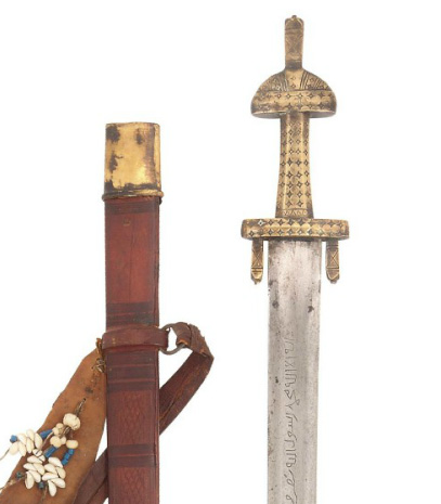

This is the highest res image I can upload directly.
Very interesting sword. The blade seems to have dimensions and shape typical of the kaskara trade blades, but of course the inscription is very interesting. The highly decorated and oddly styled hilt is extremely unusual to say the least. I'm having a little difficulty fitting the inscription and the rich hilt together since richly decorated swords are not a general feature of that era as far as I'm aware - but pretty much anything is possible if it was a gift.
Shame we cannot see the other side. I asked Christies for more pictures, but they never came - maybe they knew I did not have 15,000 GBP to spend

EDIT: Thanks Chris for the higher resolution image! Very helpful. I had also requested more images from Christies but never received any. I particularly wanted to see the lion mark.

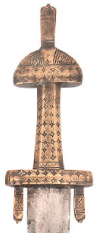

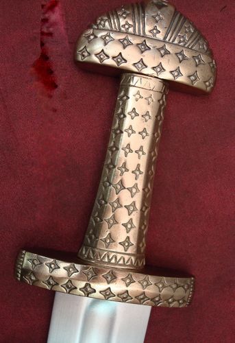

My first thought was that it appears to be built from a sword like this one.
(There are some swords like this made in India that are much cheaper than the Del Tin one above.)
A very good point.

That certainly looks like the Del Tin hilt dressed up with a few little extra knobs. The decorative motif is identicle.

I would say this is a composite sword. The scabbard has thin rings which indicates it was made post 1950 or so. The older scabbards had wide flattened rings. Looks like someone copied a Viking hilt and added some extra tidbits .

I think that the inspiration for the Del Tin is the sword shown on pages 44=45 of Ian Peirce, "Swords of the Viking Age", Boydell Press 2002. The sword is C1572, Nationalmuseet, Copenhagen. The hilt is bronze or brass over iron. There are some other metal hilted (i.e., with metal grip as will as metal pommel and guard) Viking swords known, often with silver or gold. This particular sword is nice for reproduction since brass is actually authentic (or close) rather than a substitute for gold.
The blade doesn't look like the Del Tin. But it does like like it might come from a modern repro. In particular, the blade past the fuller is diamond-section - I don't recall seeing this geometry on any authentic kaskara or kaskara0like sword. But it is very common on modern repros, since it's what you get when you start with a diamond section blade and cut a fuller into it. Usually, this makes a bad blade, since this means that the blade becomes thicker just where you want it to become thinner.
There are clones of the Del Tin, so if somebody doesn't want to invest Del Tin level money in a gamble like this, there might be alternatives. If it's a non-Del Tin, then the blade might be original to the hilt. On the side-by-side photos above, the edge of the Del Tin looks more rounded than the "antique".
