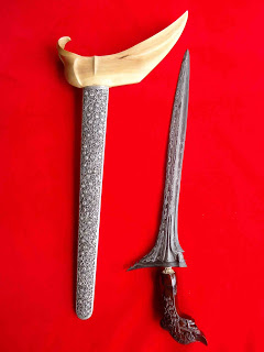

Default Pamor Kris (Heritage Kris)
Prestige of the keris world has three (3 ) kinds of sense .
The first concerns the material of manufacture ; for example : meteorite pamor Luwu , nickel prestige , and prestige relatives .
Second sense it comes to form a picture or pattern forms. For example : prestige Ngulit Watermelon , Rice Wutah , Ri Wader , Adeg , and so on .
Third , concerns about manufacturing techniques , for example : mlumah prestige , prestige oblique , and the prestige of torsion .
In addition, the terms of the master's intentions , prestige pattern which could still be subdivided into two groups . If the master makes fame kris no pattern, then the pattern is called pamor prestige tiban . One would assume the shape of the pattern prestige a gift from God .
Conversely , if the master had designed the pla prominence , called prestige colleagues [ rékan is derived from the word réka = engineering ] . Example tiban prestige , for example : Rice wutah , Ngulit Watermelon , Pulo Tirta . Examples of peer prestige , for example : Udan Mas , Ron Genduru , Blarak Sinered , and Untu Walang .
There is another called surrogate or prestige prestige ceblokan , namely pamor following its manufacture , after a keris completed 90 percent . Pamor pattern following the end of the process of making the keris .
