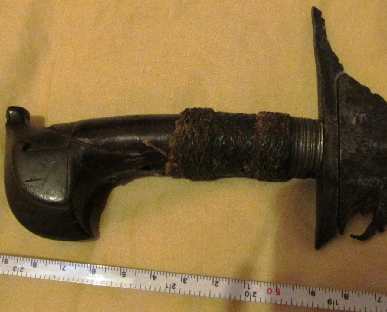

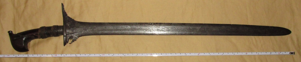

Can anyone tell me more information with regards to type of weapon, pamor, metallic composition, and possible age? It is approximately 24 inches and tapers towards the end, Thank you for your time!

IMHO this is Moro: a Sulu kalis - mid-late 19th c., I'd guess. The lower asang-asang is obviously missing; not sure wether there ever was an upper one.

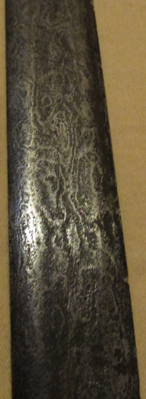

Not twistcore but an even rarer Moro type of pattern-welded blades. I'd love to see it cleaned and stained!

I agree with Kai on it being Sulu (and that it needs to be etched and cleaned ).
However I think it is a little earlier, say the early 1800s.

It seems to me that this blade looks like it has a lot more malay influence to it than moro. even the pamor looks pretty much Indonesian..........Dave.

It is possible that it is a Malay blade, although early Moro kris blades look similar to Malay sundang.

Hello Apolaki, Wonderful piece. I am not experienced enough with these to be able to make an expert judgement call on who or where this was made but, the overall appearance looks more Moro to me than Malay. Either way it is a beautiful piece and I too would love to see it cleaned and etched.

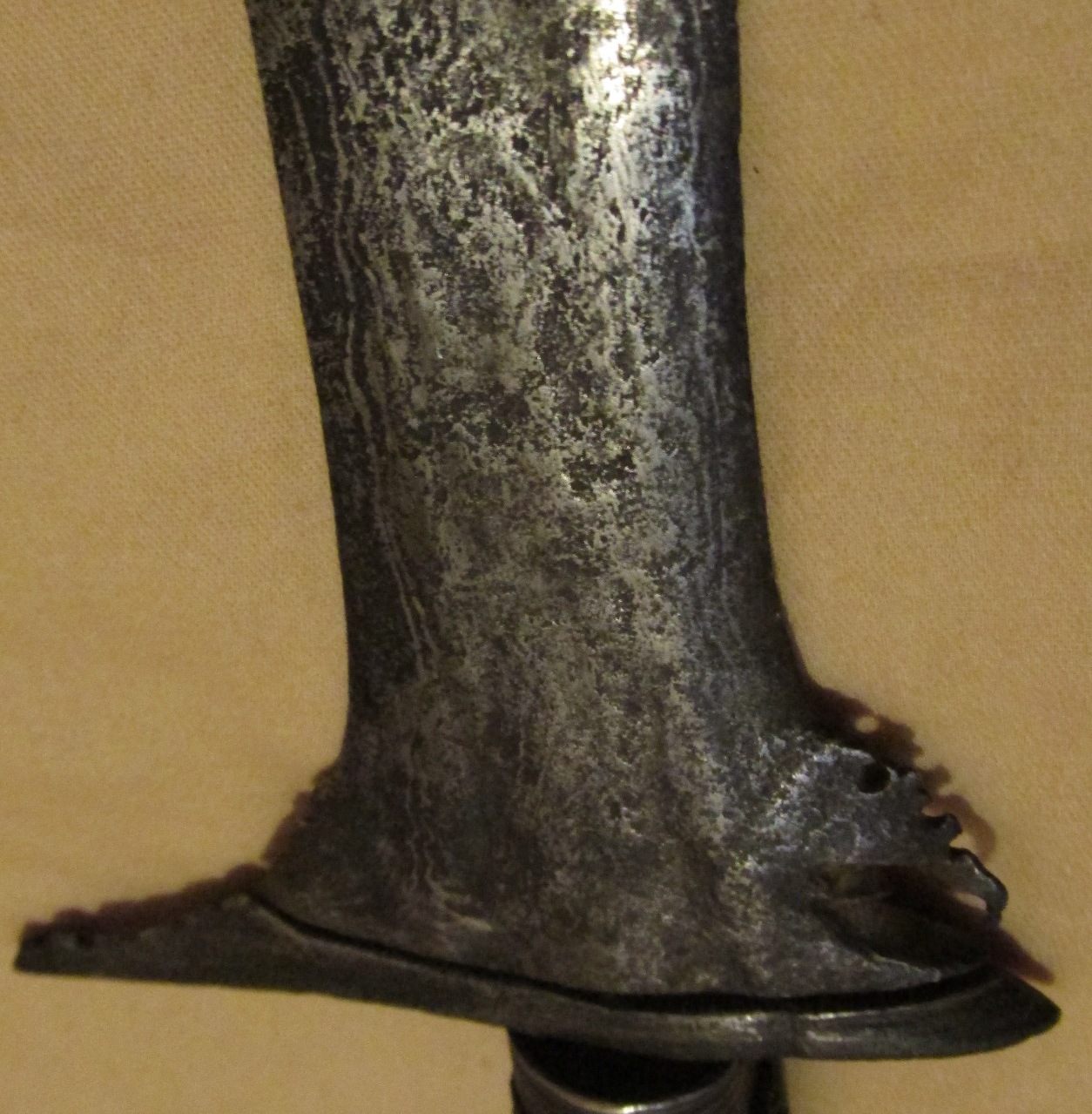

I agree that this blade has a few odd features like the pretty feeble gangya.
However, the scrollwork at the base of the blade does look Moro rather than Malay to me. Also the hilt and, especially, the grip braiding seems textbook Moro to me.
I'd suggest that this is probably because we're not used to see this kind of surface manipulated pamor from Moro blades; examples are rare, indeed.
BTW, Malay sundang don't show this kind of pamor construction any more often either...

Kai: Yes, the scrollwork does look more moro than malay, but the pamor just doesn't look moro to me at all. I think this is a definite hybrid. Not surprising, given the close proximity of these two groups..........Dave.

I have to admit that my mid-late 19th c. timeframe may be a bit too cautious. However, when looking at the scrollwork I just don't see the quality I'd expect from early 19th c. pieces. While there may have been "village quality" examples in all periods, the combination of above-average pamor with sub-par scrollwork just doesn't parse with me though.
