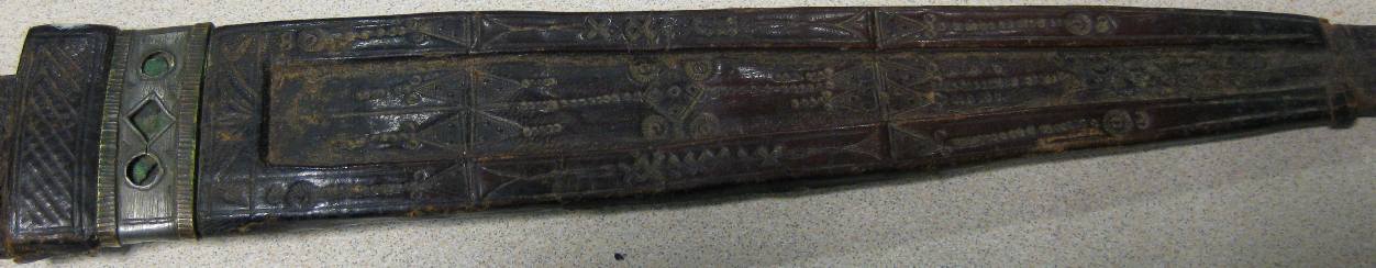

The sheath and the patterns on it are nearly identical to the Takouba scabbard I have, which I believe is Tuareg. But I've only seen the tebu style Tuareg daggers, never one of this shape. Any thoughts?

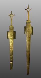

Salaams Blue lander ..I think the type of bulbous pommel must be one of the common Tuareg styles perhaps as a direct result of the Khoumya Berber style and the other is probably the cross shaped pommel.(designed onto the Tuareg weapon from the famous Southern Cross star form)..
I have placed a few different types for perusal....and comment.

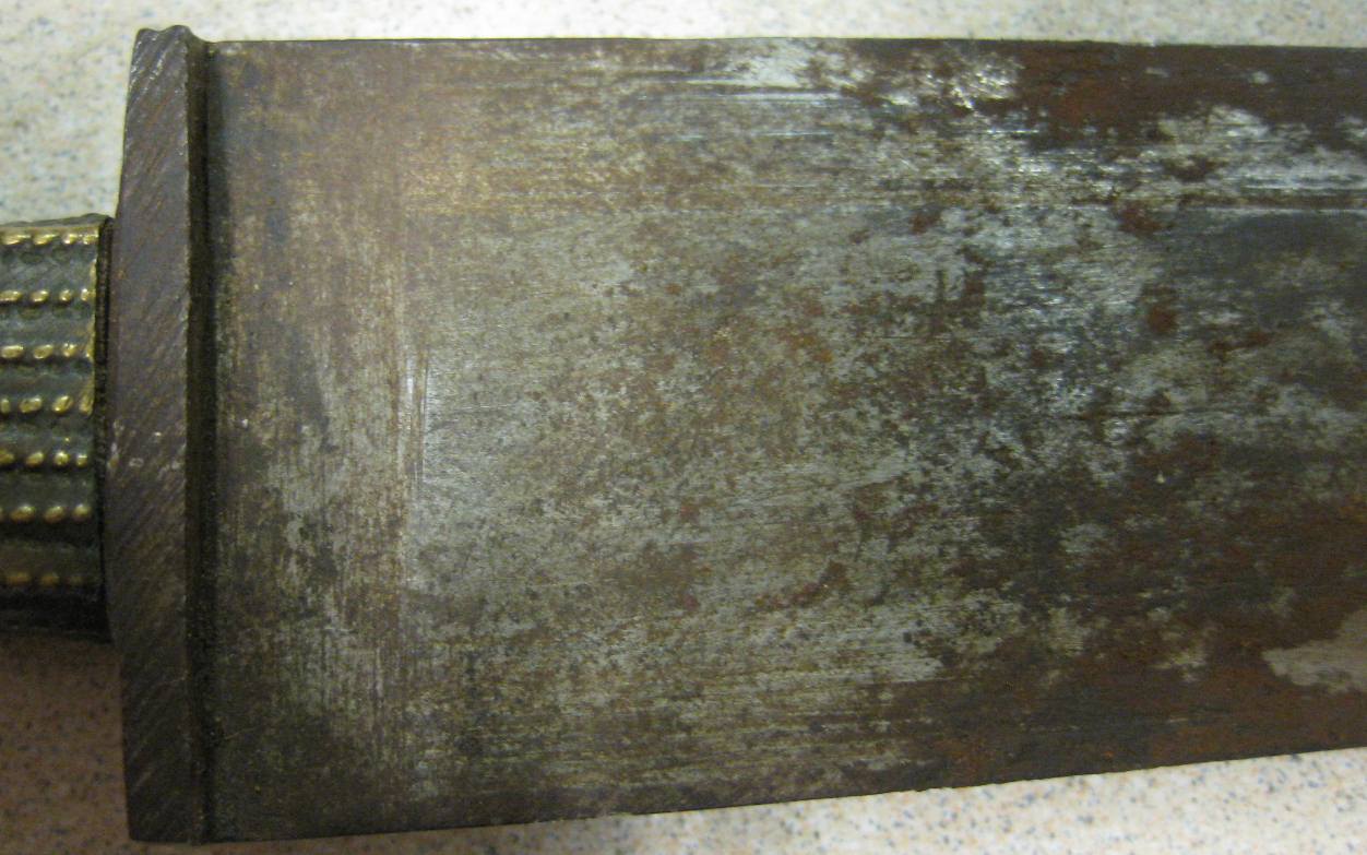

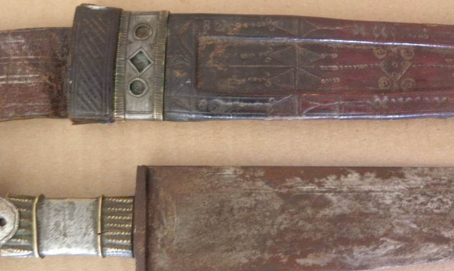

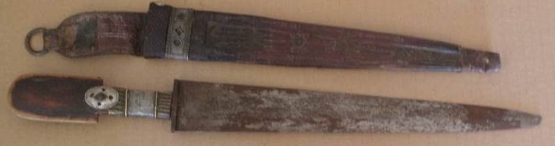

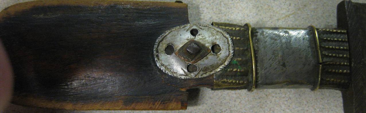

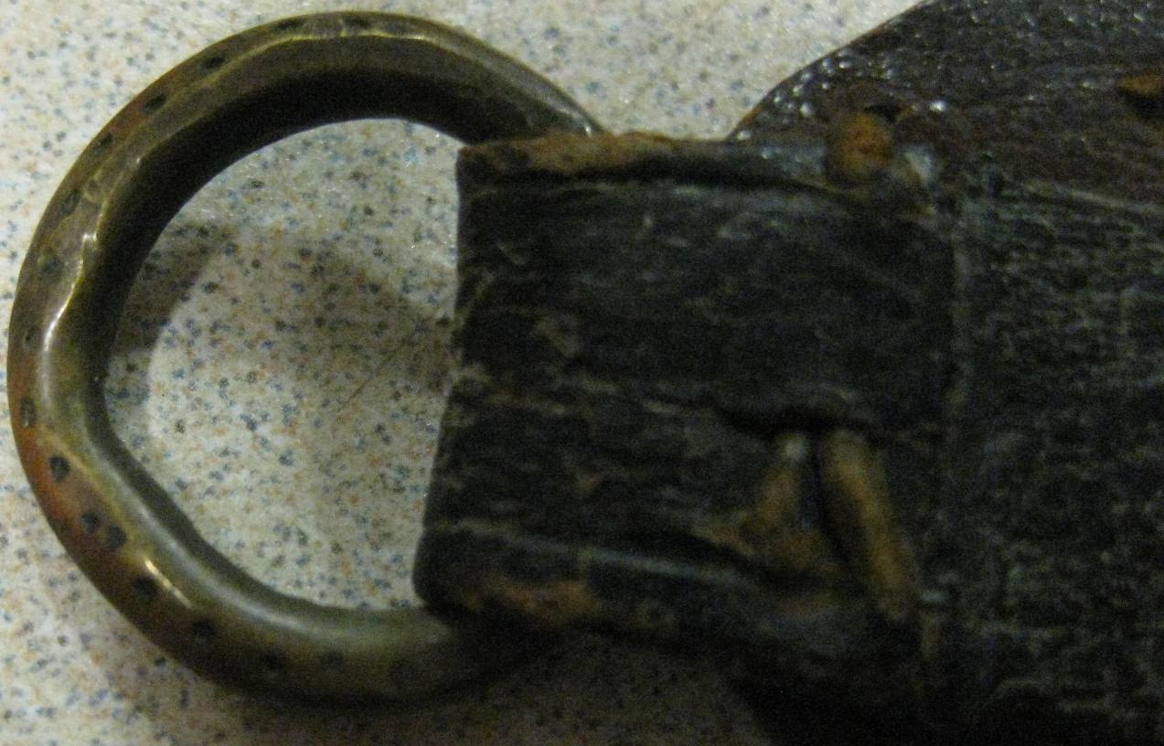

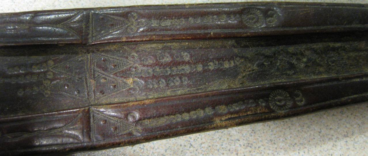

It finally arrived today. It looks like there used to be another piece going around the end of the hilt. The blade's definitely of the scrap metal variety, but it's pretty sharp and there's a pattern etched around the edges. The tip looks broken off and the area around the tip is bent. The sheath looks just like my takouba sheath. The green bits behind that metal band are just a green color piece of fabric. I assume there was a metal end piece to it at some point.There's odd dots on the brass belt ring. Considering the amount of wear and tear on the sheath I'd be suprised to hear it's a tourist dagger. Besides the usual signs of wear there's a couple cuts on the leather. Unless it was aged intentionally.

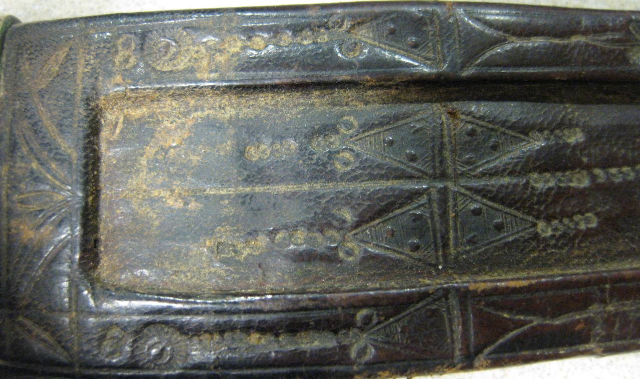

Unless I see evidence otherwise I'm happy to consider this a legit but very modern piece. Comparing the sheath to my Takouba scabbard, the leather on the dagger sheath is much shinier. I guess it spent less time in the desert.

Maybe I am wrong, but I am of the opinion it is not a very modern piece. I think it is what we could call "contemporary", maybe from seventies. As Sajen already wrote, very modern (and touristic) would really be more fancy. This was made for use. The shining scabbard could also mean, that it was used extensively (again as Sajen mentioned; polished by contact with clothing and unwashed hands), not only that it is new. Shinier scabbard should be a "positive" sign. You have authentic artefact, not a souvenier.

To add to Martin's points, the heavy brass ring on the scabbard is a very good sign this is not entirely new. 21st century items typically have white metal or aluminium instead.
While this is certainly a 20th century item, it is authentic I think as well.
