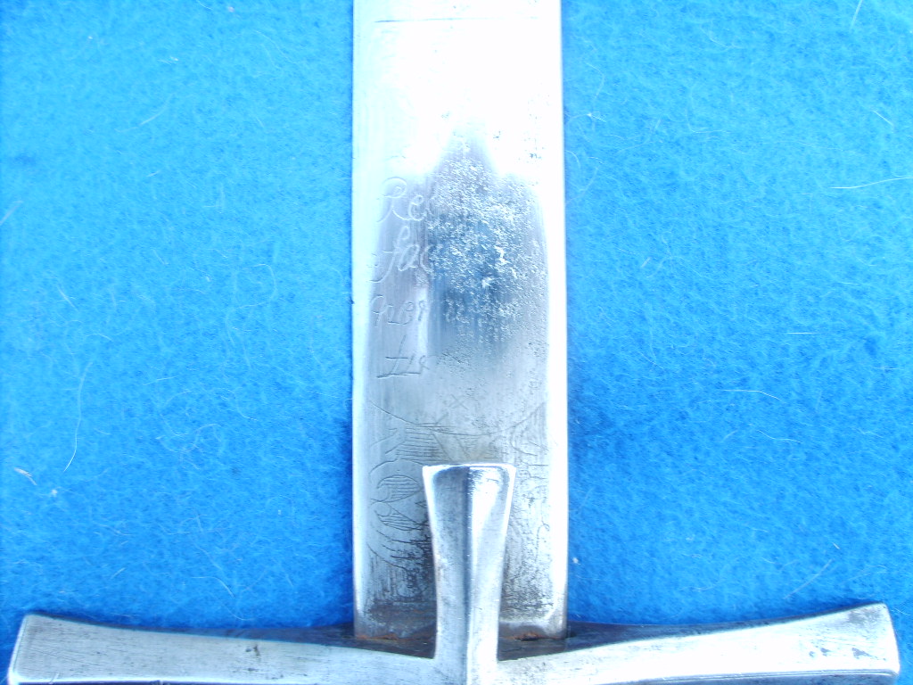

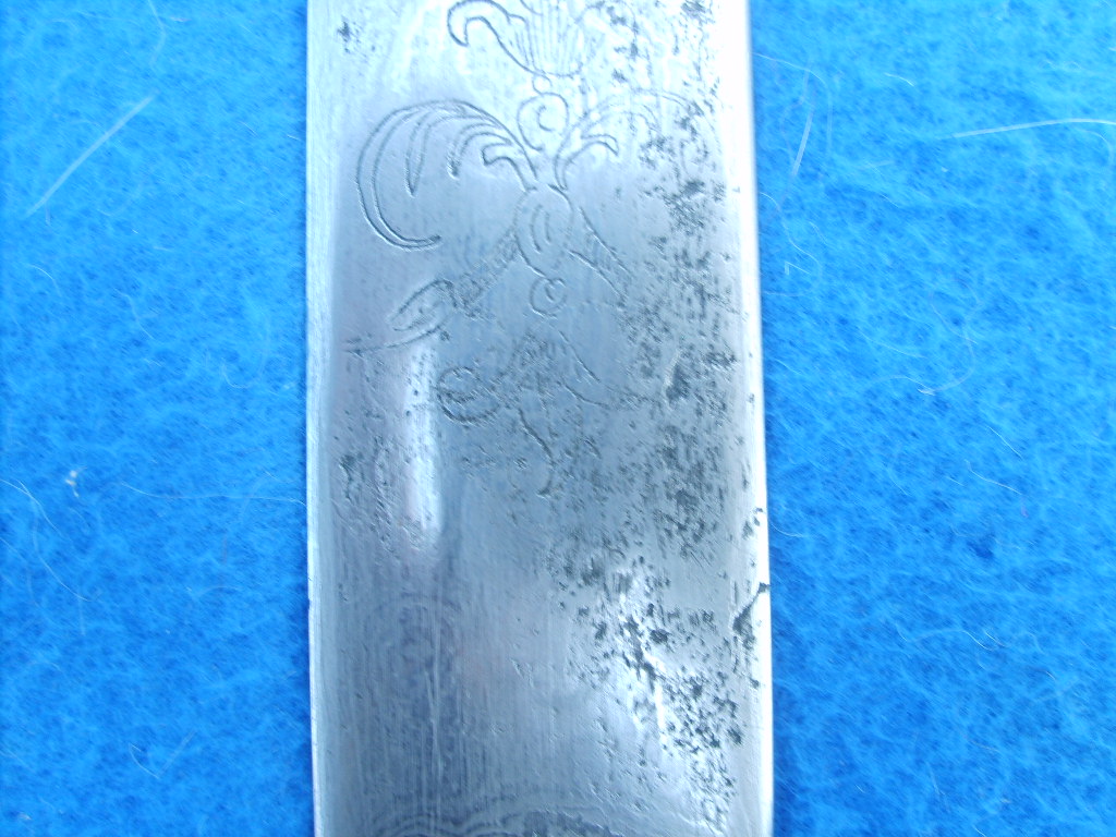

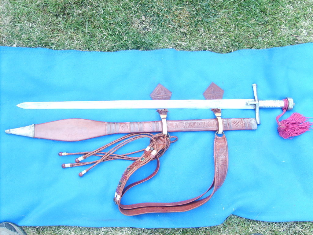

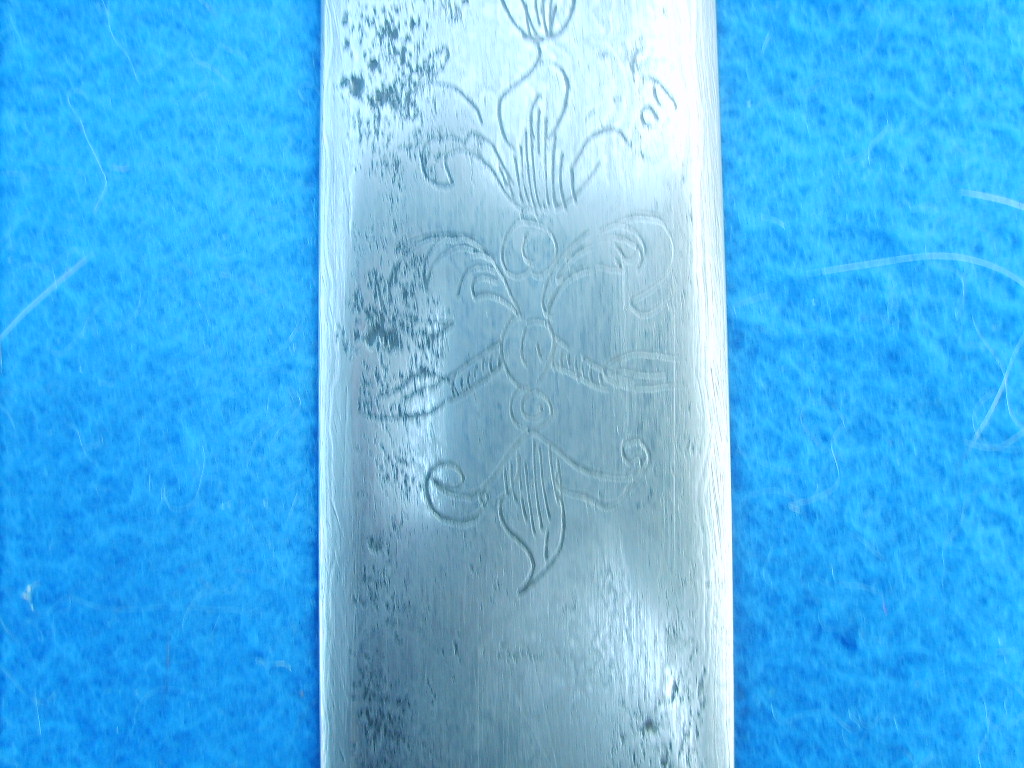

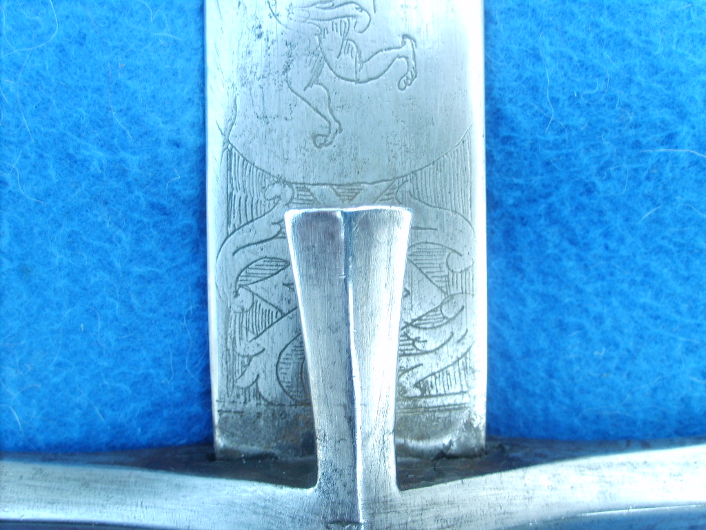

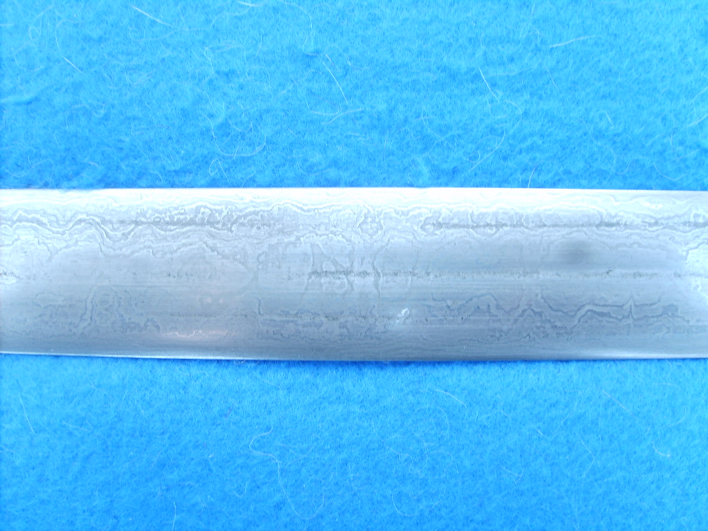

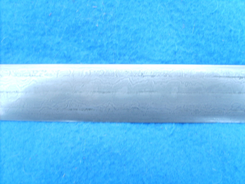

Here is a damascus kaskara for viewing. The blade is layered damascus
with what is left of three fullers, 34 inches long, 40 inches overall with a

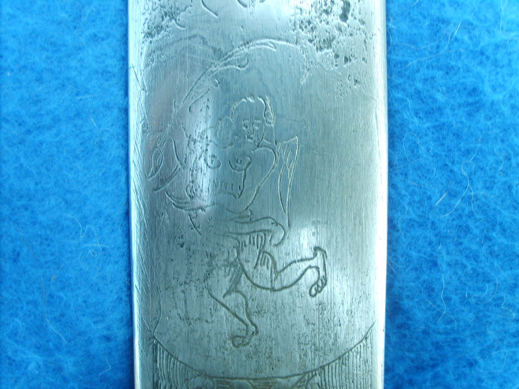

silver handle. Some of the inscription on the blade is in Latin. I tried my best
to photograph these and the figures, but i don't think they came out too
clearly. The scabbard is in absolutely pristine condition with all the goodies.
Any ideas as to age or origin. I also have another damascus kaskara
with a single wide fuller down the entire length of the blade. These kaskara
blades must be rare, as these are the only two that i've ever seen......Dave.

a fine piece! though I have a feeling that this was not meant to be etched.

A.alnakkas: This is the way it was when i accquired it, already etched.
I would think that the smith would want the blade etched to show
his skill. Just a thought.........Dave.

Hi Albert: Yes, there is no doubt in my mind that it is a european blade. I
think it is a much older blade also, because i would think that the
mass produced ones made later for export would not be layered. It
would be too time consuming. You can see that the three narrow
fullers are almost washed out due to many years of cleaning and
maintainence............Dave.

Now here is an anomaly! The blade profile is very much as seen in many native produced blades for kaskara, but I cannot think of ever seeing any which were 'Damascus'. I'm sure those here with metallurgical expertise might give better account of this case, but I do not believe this is a European blade. While as noted there may have been instances of pattern welded blades in European context they are not among the 'trade blades' which entered the North African sphere.

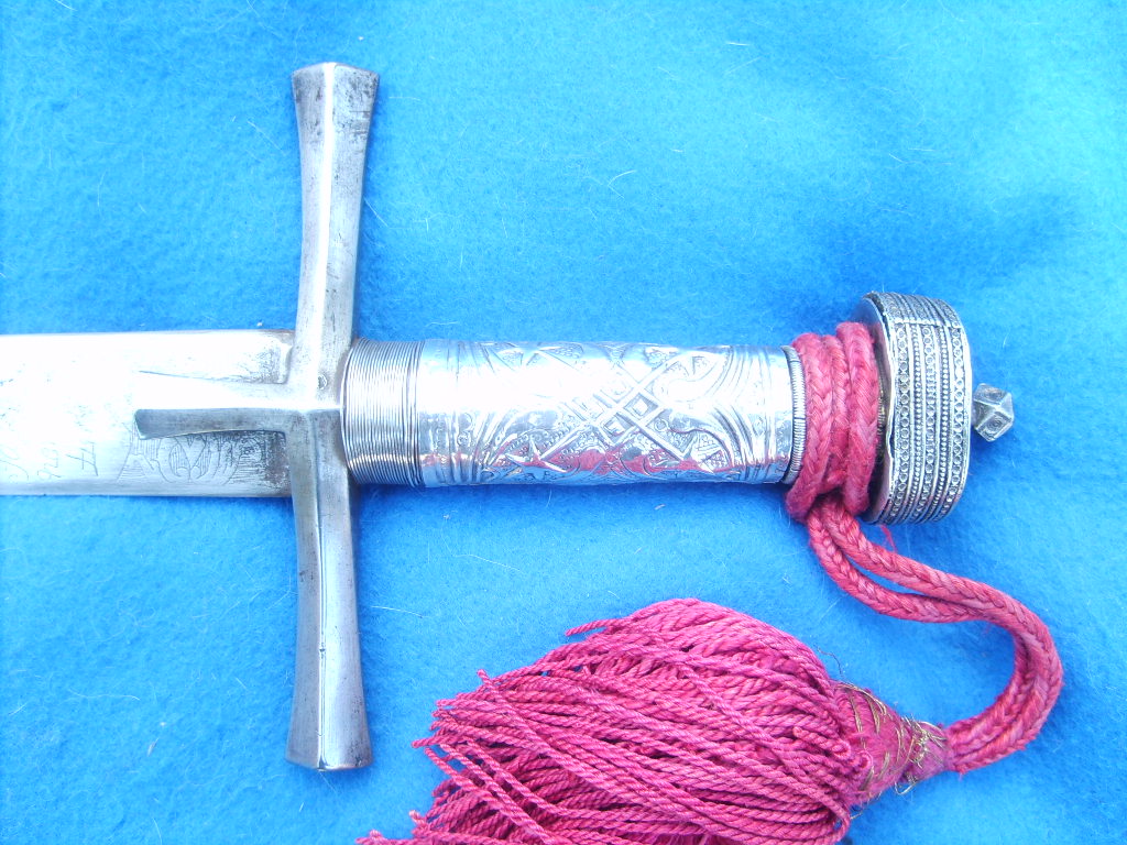

The mounts appear to be of modern 'Kasallawi' style which are produced in this area of Sudan from around 1960s as I understand (Reed, 1987) and often associated with Darfur. These blades were of course remounted many times over generations so using them to assess the blade age is often counterproductive.
What is most curious are the engraved intaglio and angelic figure devices on the blade which are typically regarded as in the "Caissagnard' style and usually found on French blades on court swords, smallswords and hangers of mid to end of 18th century. As this type blade, and certainly not pattern welded or damascened was not in use in European swords at this time nor later it would seem that perhaps these engravings were copied on this blade by a quite skilled artisan in native trade entrepots.

Very interesting kaskara. I can't comment on the blade material, but can offer some observations. The cross-guard is flared, and likely at least early-mid 20th century. The scabbard, though very high quality is likely a more modern addition since it shows almost no use. The bulbous profile is not as rounded as seen in the east. The tip and the band at the scabbard opening are likely silver, but appear relatively plain and not in keeping with the overall quality of the scabbard. Also, the two "flaps" are five-sided as opposed to the normally seen triangular ones common on Eastern Sudan examples. The engravings are similar to those described by Reed (Attached for reference). Also, the angel has wings and breasts, not likely to be of Muslim origin, but as Jim suggests perhaps French occult. Can you translate the Latin text?
My guess its origins are Western Sudan, Dar Fur or maybe Chad.
Ed

A lot of older European blades are made out of "Shear Steel" a forged and folded steel that was not intended to be etched, but shows a watered pattern on those occasions when it is. It is possibly one of these.

David R: I've heard of shear steel but don't know what it would like in a
sword blade that has been etched. I can tell you that this blade is
a layer-weld that was made to be etched and seen. I know it is
hard to tell by the quality of these pictures, but once the blade is
in hand and one can get a first hand look, it is very apparent that
this was a pattern that was brought out so it could be appreciated
by it's owner.

Nice kaskara. The blade is not made from shear steel but purposely pattern welded. Here are two links to 19th century German sabres with "damascus" blades. Seems to have been a fashion at the time.
