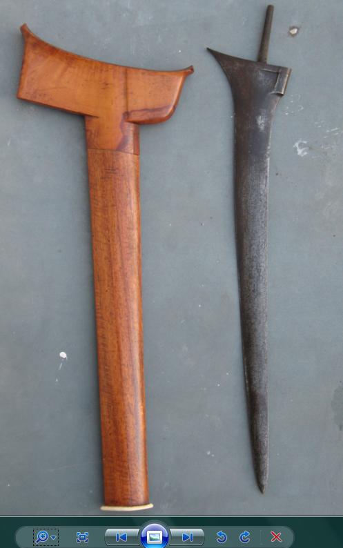

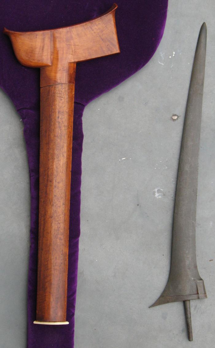

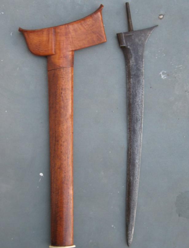

I bought this keris from a dutch family.
The owner was mid 40's and the keris once belonged to her grandfather.
So it probably came from Indonesia just before or just after WW2.
I must say that such a bring back keris confuses me.
The blade is very simple. is it sumatra ? bugis ? or even malay ?
The fit in the scabbard is perfect.
Please give me your opinion / comments.

Hi Willem,
congrats, nice keris. Blade is sepokal form, strong Bugis influence and I am sure that the blade will show after etching a nice pamor, maybe ujung gunung.
Would place this keris somewhere between Sumatra and Peninsula. Could be a Bugis Riau keris. Do you get a hilt and pendokok with it? Good worked blade IMO.

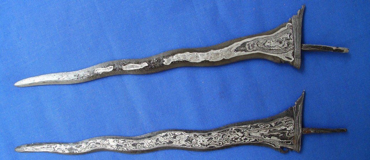

Hello Willem,

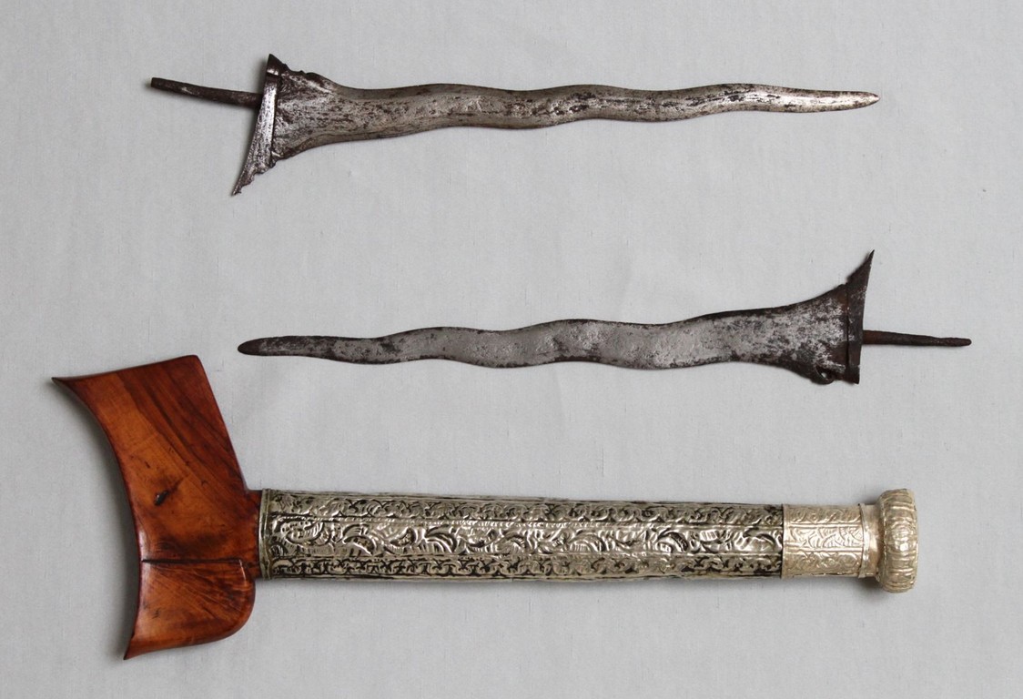

I believe that you will see some pamor if you clean and stain the blade properly, see attached examples of Bugis blades after and before treatment ...

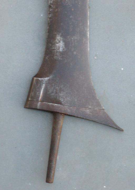

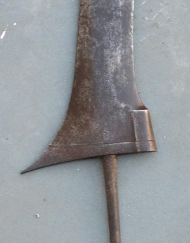

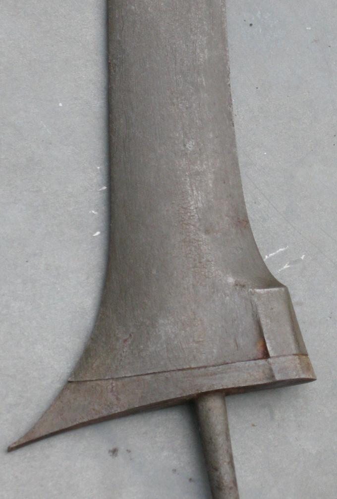

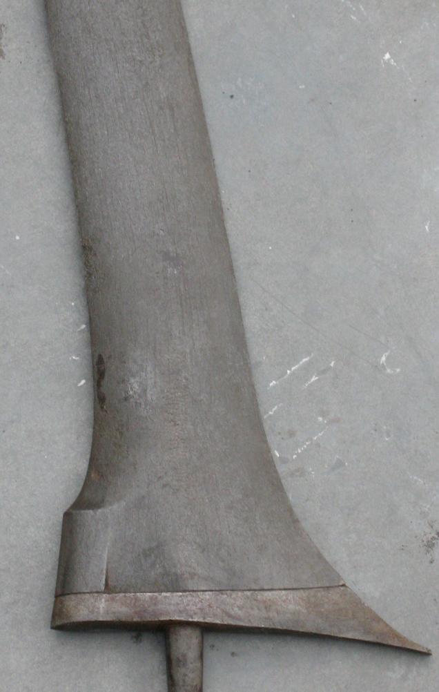

Hello Jean,
I do not have the skills and material to do a warangan stain.
I have stained the blade with lemon juice for approx 24 hours an got the results as below.
In my opinion their is no pamor in this blade. What do you think ?
Bestregards,
Willem

Hello Willem,
seems that you are correct! When I am you I would bath the blade inside the lemon juice until all rust spots are removed and would let the blade in this status.
In my opinion the pamorless is a sign that it is a Malay blade.
Sajen is offline

Hello Willem,
Hum, the blade is well cleaned and no traces of pamor indeed! I fully agree with Sajen.

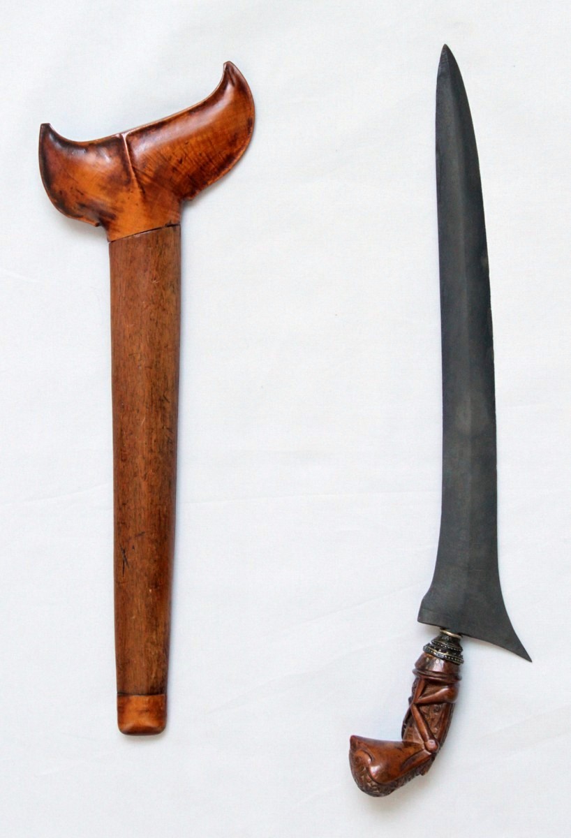

Hello Willem,
This kris is probably originating from East Sumatra and the blade is different from yours (short gandik, ganja iras, etc) but it also has no pamor.

If you mean my kris, its origin has been attributed to Jambi by the previous owners but I am not sure and fully open to other opinions. The blade is quite peculiar, it was treated by warangan which gives it this dark colour.
Best regards

Hello Jean,
the blade look like a Palembang blade, have a very similar iras keris in my collection.
I think David relating to the keris in question.
Sajen is offline

Yes Jean, i was referring to Willem's keris, not yours. And to me, both the blade and the sheath always seemed more peninsula than Sumatran. That "flat" ivory buntet on the sheath looks much more like peninsula examples i have seen. The very boldly defined gandik and the meaty pesi looks more like what i would expect from a peninsula piece.
