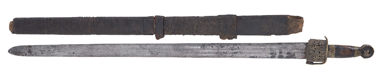

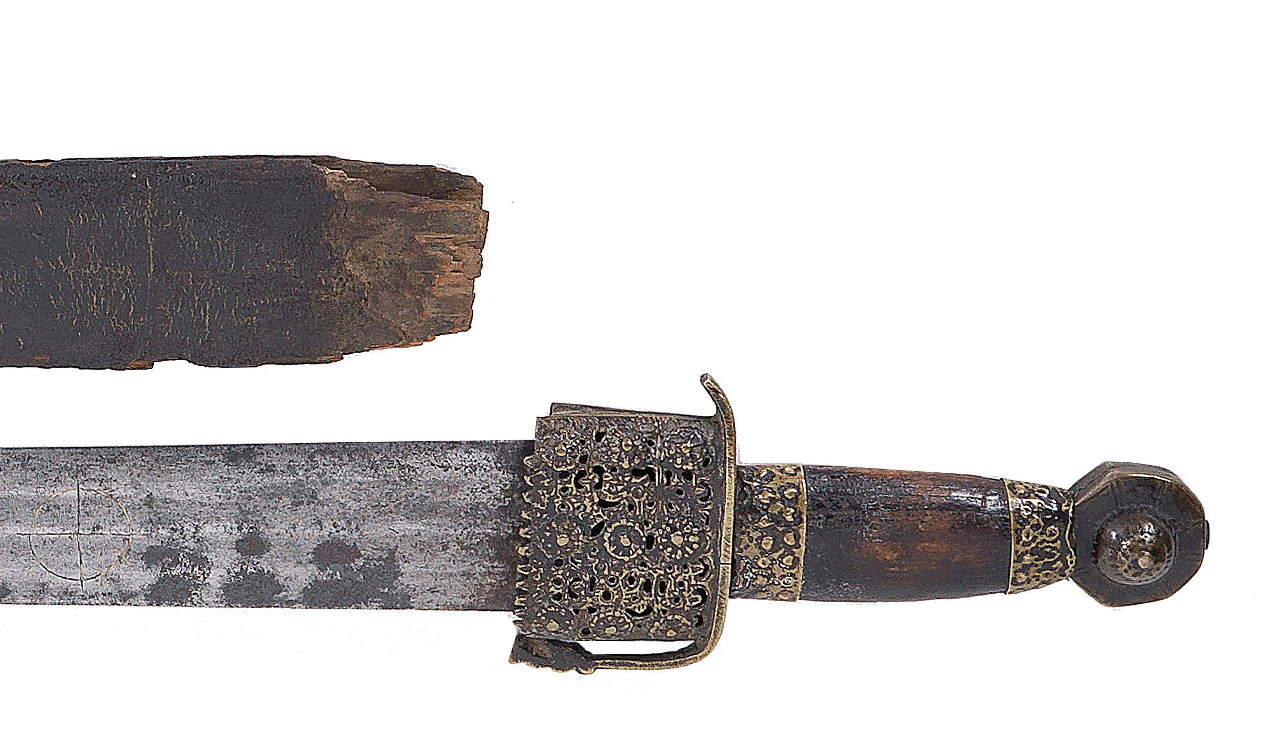

Thought this would make an interesting discussion item, it sold earlier this month. Auction description lists 15th century European blade and 17th century central Asian hilt.
Blade has an inlaid cross while the hilt shows an interesting dragon motif on the tip of the remaining quillion.

Surprised this hasn't generated any interest.
For me, it looks to have Nasrid influence?

There's nothing really schiavona like in the pommel in my view. It's not a "cat's head". It's a style of pommel known in the Oakeshott typology as Type I1, popular in the 14 and 15th centuries.
The blade could well be a German product although that's somewhat indeterminate from the imagery available. The auction house dating of 15th century seems plausible due the mark and style of inlay.
I wouldn't describe the quillions as "naga" that's a term related specifically to Buddhist and Hindu mythology. They are dragons from what we can see in the images. The arms and ornate collar are highly reminiscent of jineta. However the dragon form does point away from classical Nasrid designs.
In the image you linked - that's a Qajar revival piece from the 19th century.
The piece under discussion does not fit anything visible in the icongraphy or archeology of Byzantine or Trebizond that I'm aware of.
The Persian idea is interesting Jim, as I recall Chinese style dragons (as these seem to be from the head shape) started to be in vogue during the Timurid period.
The pommel looks potentially older than the rest of the hilt assembly to me...

Hi Ibrahiim we can't really use the Oakeshott typology in full for a case like this I think, the XI was rather too early for this being in use during the 12th century. I referenced his pommel typology not the general sword typology. If we were to go down that route XIII might be more fitting although still too early in my view. As the large cuff is not original to the blade you won't find a match in Oakeshott for this.
Returning to the hilt and the decorative themes, more and more I'm favouring the central Asian provenance indicated by the auction house. The dragon theme in this form was popular during and after the Timurid period as can be seen on this jug handle. http://www.metmuseum.org/toah/works-of-art/91.1.607
A blade such as this could have arrived in these environs in any number of ways, if I'm not mistaken the guard exhibits a two piece construction which could explain how it was fitted without removing the pommel.

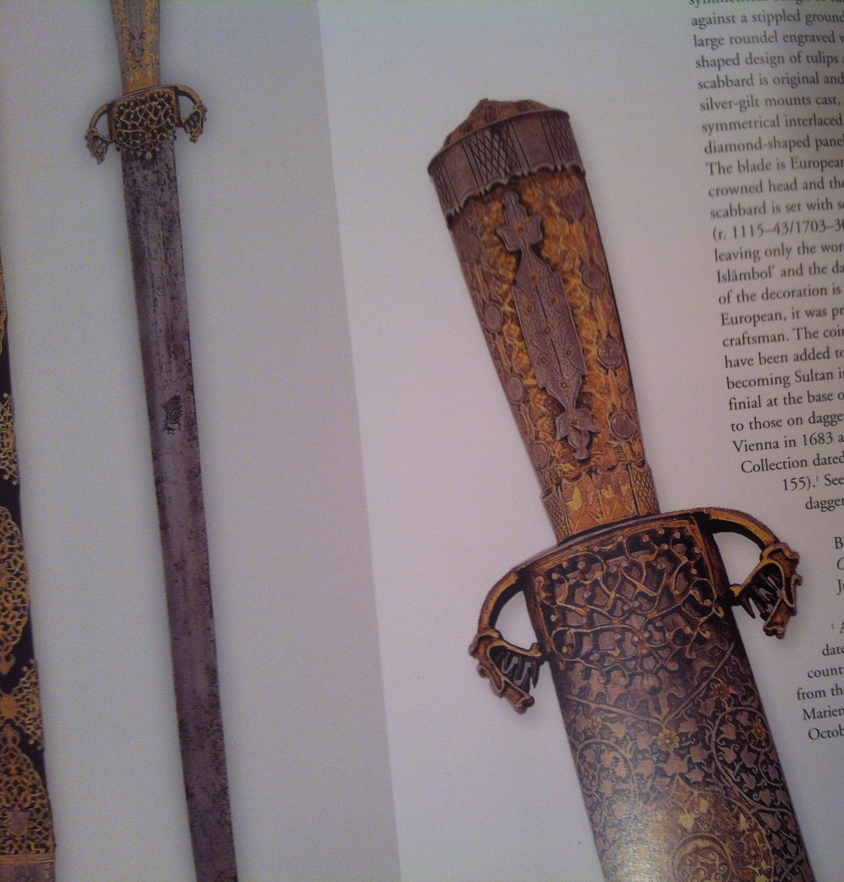

Actually after looking more into this interesting sword, primarily the mounts at this point as the early European nature of the blade seems well established at probably latter 15th into 16th c.
The nature of the 'cross and orb' superimposed seems quite unusual and in its quadranted circumstance tenuously reminds me of Islamic astrolabe or navigationally oriented themes rather than the Christian cross and orb. While I am not saying this is what it nececcarily represents, it seems worthy of note. It is of course in the European latten inlay style, but I have not located any examples of the cross 'over' the orb as yet in sources checked.
As Iain notes, the dragon head (makara head in Indo-Persian weapons parlance)was indeed an artistic element used in varying material culture items from the Seljug Turks of 12th-13th c. but recorded as early as 9th.
("The Silver Dragon and Golden Fish", D.Alexander, Gladius XXIII, 2003).
It seems of course that these stylized forms were used as quillon terminals not only in Ottoman but well known in the downward quillon hilts of Persian qaddara from about 17th c. well into 19th. These same style quillons often with similar quillon terminals are seen in Qajar 'revival' type sword (1796+) as well as many Deccani associated swords.
It is interesting that the Afghan 'paluoar' sabre also has these stylized dragon head quillon terminals, with these typically regarded as 18th century and possibly slightly earlier.
I would note that while that may support the Central Asian theory for these mounts in degree, in "Arts of the Muslim Knight" (Furisiyya, ed.Bashir Mohammed, 2008) on p.78 (#42) there is a Bosnian sword of 17th c. (probably latter) which is remarkably in the same style as this sword with the brass openwork cuff, drooping quillons and dragon style terminals.
The blade is also noted as European, with Solingen mark date 1524.
Regarding the pommel seen on our example, I believe the association drawn to schiavona resulted from the boss type feature and later high relief faces seen in some of the earlier forms. The overall effect of this clearly refurbished old blade in reminiscent Nasrid style is probably composed with blade and earlier pommel, and likely ceremonially intended in the latter 18th into mid 19th c. Given the composite nature of the sword and its inherent stylization it would be hard to say exactly where it is from in present mounts.
As noted earlier, the dragonheads on earlier Ottoman and Persian hilts seem to be more dynamic in a more splayed profile. The more stylized 'blockish' nature of these terminals to me seems to suggest later production.

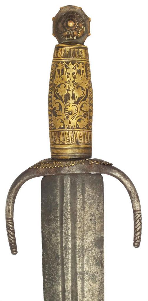

This sword is of a type carried by the Venetians troups in the wars against the Ottoman Turks.
this dalmation sword, also the blade, can be dated around 1600-1650 , it is of oakeshott type XIII, a type frequently used in the 16th and 17th C.
However I must admit that oakeshotts classification is not/rarely used for 17thC swords.
The origin probably is Venice.

Thank you so much Jasper for the great entry! It is most interesting to see the similarity in these Venetian swords of 17th century, and how much influence the Timurid/Safavid downturned quillons had on certain European forms. In Italy the 'crab claw' hilts were certainly well established, and if not mistaken some degree of this diffused into German work.
In the case of this example from Venice the quillons are without terminals, however the interesting crosshatch designs remind me of the familiar fir cone of Augsburg marks. In our example of discussion I am not sure if the Nasrid character and Persian/Ottoman style quillon terminals would necessarily correspond to swords used by Venetians vs. the Ottomans.
It does seem clear that this Dalmatian associaion would lend well to the Balkan (particularly Bosnian) attribution of this apparant commemorative style sword in these type mounts.
Ibrahiim I will see if I can get the images from the book on the Bosnian example. I think seeing the openwork on this example and the dragon head quillons will better illustrate the connection I am making.
Regarding the pommel, as Jasper well notes, the Oakeshott typologies do not typically work well farther into Renaissance period and later. In these cases the work by A.V.B.Norman is the reference to use, and I will later look into that as well.
It is interesting that the example shown by Jasper also has an octagonal profile, though of clearly different character.

Fantastic stuff Jim and Jasper.
I think that might just clinch it, Ventian and Balkan (Bosnian) combination piece.
Here's the page with the Bosnian piece courtesy of a friend and fellow forumite.
Fascinating material, this is the sort of puzzle and detective work that make this forum a real joy to be a party of.

Posts: 1,720
Text related to the Bosnian sword.
