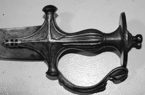

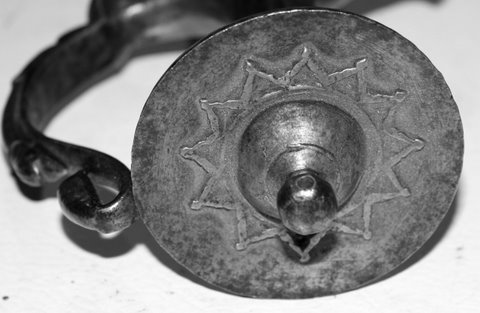

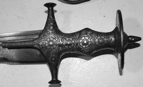

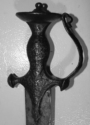

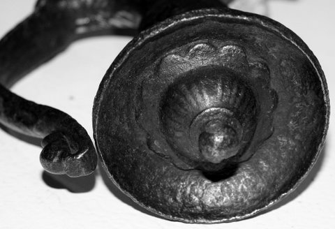

Hi all, it has been some time since I've participated in the forum and thought I'd ask a few questions of the more advanced collectors of Indian arms. Ove the years I've been fortunate to pick up several "Indian" swords, commonly refered to as Tulwars. When you do a search within the forum there are many, many pages on such swords, most seem to discuss the blade. In the sword that I have and those that I have examined, I've noticed that the hilts vary considerably in quality and condition compared to the blade. This leads me to believe that hilts were commonly exchanged. This certainly makes sense to me based on the hard use of the blades over time. My questions really are regarding the hilts.
In several posts, a collector will call a hilt Lahore, or Sinde etc and I'm still trying to figure out what typilifies such hilt? From reading posts within the forum I've come to identify enamelled hilts with Lahore but this is probably much too simplistic. So what I'm looking for is, based on the shape and construction of the hilt can you determine where in India a particular hilt was made?
Attached are some pics of swords hilts that I have in my collection. All vary in the quality of thier construction and condition. Please note the the orientation of the quillons and whether the pommel is dished or flat. Note that one hilt has sepperately applied swans on the knuckle guard. What is the significance of this?
My goal is to look a hilt and be able to generally say based on the shape "that's a Sinde or Delhi hilt!"

Hi Greg,
You have asked the question of the ages that continuously tears at nearly all enthusiasts of Indian weapons, particularly those interested in tulwars. The truth is that there are no finite attributions to these hilts, commonly termed Indo-Muslim in style, and there have been many attempts to find consistancies in typology and classification.
It is not only the hilt and the elements of it, but often comprehensive assessment of the sword altogether which is necessary for any semblance of identification. Most of the individuals who seriously study these, are basing opinions on certain characteristics from available literature and regularly handing various examples. While I feel I have a working knowledge of many of these in degree, I am far from presuming any expertise, and there are a number of guys here who have far more experience, Jens Nordlund being my first thought.
I am not sure which references you have, but I am hoping you have the following:
1. "The Indian Sword" P.S. Rawson 1968
2. " Indian Arms & Armour" G.N.Pant, 1980
3. "Handbook of Indian and Oriental Arms and Armour" Egerton,1880,
4. "On Damascus Steel" L. Figiel, 1991
5. "Arms and Armour: Traditional Weapons of India" E Jaiwent Paul,2005
These references represent the benchmarks on which most of the research and assessments concerning tulwars are based to date, and there are of course a number of focused projects at present trying to accomplish exactly the same guidelines you mention.
Using the references I have mentioned, it is important to try to define the history of key locations used to describe tulwars. It seems that Lucknow was one of the key centers for enamelling, and some of the other elaborate decoration. This was essentially a Mughal location.
The most prevalent region for tulwars would be Rajasthan, a broad area which includes Banswara, which is one of the locations that seems noted for the swanlike, recurved knuckleguard you have noted. The northern part comprises Udaipur, and the bottom hilt in your grouping with peaked grip, squared langet, large flat dish pommel is considered Udaipur style according to Pant, and these seem invariably throughout the 19th century.
The Udaipur regions were essentially Rajput, and tulwars with knuckleguards may often be considered Rajput, but also perhaps Sikh, which is the third basic denominator for tulwars.
However, the hilt you show with vertical ribbed grip (very much like Figiel, pp.56-57) is considered an 18th century pattern, and these have been considered generally a Rajasthan form of hilt, however these are often seen with clearly Mughal blades. This illustrates how fragile the potential for accurate identification is, as these hilts were often made in one location and supplied to armourers elsewhere, not to mention constant diplomatic contacts and intrigue.
Lahore is the center for the Punjab, and most often noted in referring to tulwars which are often decorated with certain koftgari patterns and motifs.
I have been told that the book by Susan Strong, "The Arts of the Sikh Kingdoms" (1999) has excellent examples illustrating this type of koftgari (nos. 151,152,155,158,159,162, 171, 172) . By examining these examples you might be able to recognize typological forms associated with Sikh forms of tulwar and weapons.
One always hopes to find the gurumakhi script on a weapon that will irrevocably define it as a Sikh weapon, but these are hard to find.
The most confusing term used for tulwar hilts is 'delhishahi' which of course suggests these are from Delhi, and they exist with open hilt or with knucklebow.
Key variations are seen in the pommels, and the dome or capstan or both atop the disc, which may be dished, bowl or flat.
The only reference to a Sindhi tulwar type I can find at the moment seems to be in Egerton (#729) from Haiderabad (in Sind, as opposed to the Hyderabad in the Deccan). This has an open hilt, domed pommel. Egerton notes on p.135, "...Sindian arms approach more closely the Persian than the Afghan type".
I have seen examples of sabres with steel Persian shamshir type hilt and tulwar form langets and quillons, that I sincerely suspect to be from regions of Sind, perhaps more north. Persian shamshirs are well known in Mughal courts in standard form as well, and in Rawson are termed 'tulwar'. In my experience, Sind is not a designation I often hear for tulwars, although clearly they exist there, but are probably not made there.
Mughals were more inclined to have Persian blades, and this is often a factor, also I have seen references that the flueret shape on quillon terminals is a Mughal characteristic.
Tulwars did not typically reach into the southern India regions, with the exception of Mysore and Tipu Sultan, as well as other Mughal dominions intermediate.
One of the more subtle, and key elements that is hoped to define any type of regionality and period for tulwar hilt types is the botanical and floral motif chosen. You have wisely shown the pommel dish decoration, which is also very important, and often carries a solar motif, key to certain Rajput clans as well as thier traditions. Variations in this decoration can reflect other attribution as well.
I hope this is of any help, and it is not just stuff I know, but have been reviewing as I wrote. I have learned a bit myself as I have written this, and I look forward to thoughts and/or corrections from others who are more familiar with these fascinating swords.

Hi Greg,
Please tell me if the fluted hilt with the hand guard has a rope like decoration on the edge of the disc.
The bird on the hand guard could be a swan as mentioned, but it could also be a crane.

BTW please keep you pictures together. I suppose that your pictures 1, 2 and 5 are of the same object, and that pictures 3 and forur are from the same hilt.
