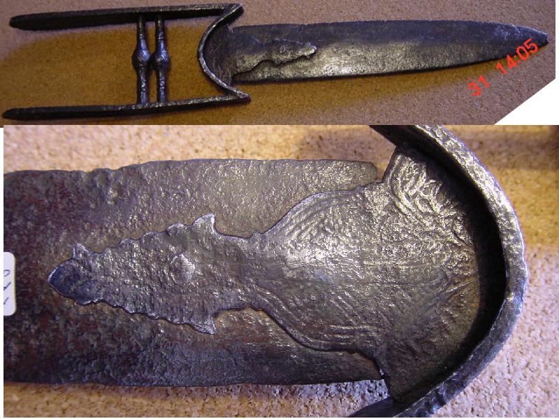

These are pictures of a katar that i bought, labelled as being from "Portuguese India, 18th century". I am not sure that this is a valid reference, specially the pretended portuguese influence aproach.
It has a 10" blade, and measures over 17" in total.
Comparing to some intrincate katars that can be seen around, this is quite a plain specimen.
I wonder if the members involved in this area would favour me with some coments on this piece's provenance and probable age.
Thanks a lot.

One thing is for sure, especially based on Elgood's book, this is a piece from southern India. The pierced sides and curve at the base give it away for me. Didn't the Portuguese land in south India? Not sure their influence is necessary.

Portugal had quite a lot of colonies in the area, in India they had one at Goa on the west coast. I doubt very much that Portugal, or any other country for that matter, had any influence on the katar, other than European blades were sometimes used in especially south Indian katars, farangis and patas.

You made me understand that this or other katar hilts haven't suffered foreigner influence in their native form and decoration and that, in some cases, european blades could be used.
In fact the portuguese landed in southest India around 1500 and kept a few possessions there for a few centuries ... they were last driven out of Goa in 1961. This explains the term "portuguese India", and must be the area where this katar comes from, as the seller specializes in weapons from that region.
As you are noticing this is a southern model, would you say the blade is indeed an european attachement, and that it could be aged 18th century ?

It is difficult to say if the blade is from an European sword, as the Indians copied European sword blades, but it could be European. Also the blade seems to be as old as the hilt.
The first written report about a katar, was written by Ibn Batutta around 1330, as one of his travelling companions was killed with a katar on the west coast of India.

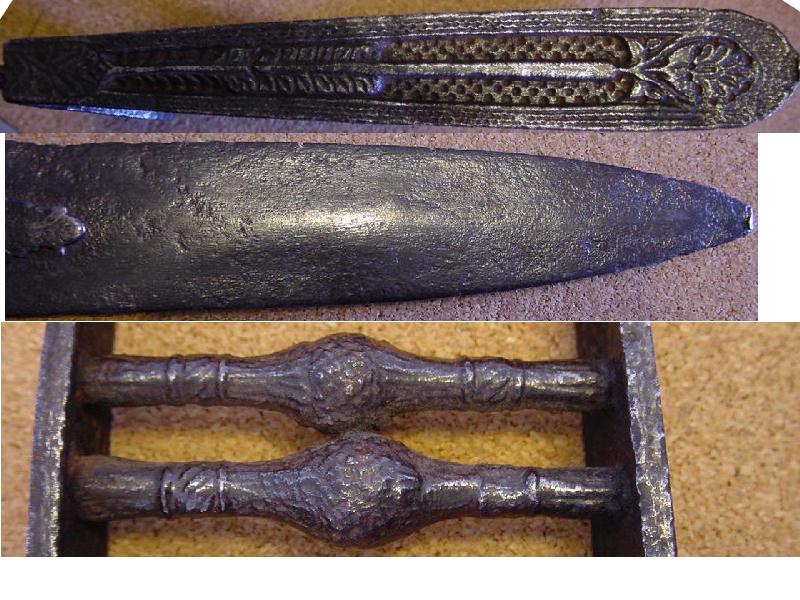

This katar is outstanding, mostly because of its untouched integrity. I agree completely with Jens and Battaras comments, and I think the assessment of Portuguese India, 18th century is probably entirely correct. Actually the reference to Portuguese has nothing to do with 'influence' but more to do with the blades commonly used which were often imported by the Portuguese. The region was as mentioned included the key trade center of Goa, and the Mahrattas were prevalent in these regions. Mahratta tribes were Hindu and situated initially in western and central India, with thier campaigns carrying their weapons and influence into many other regions in the subcontinent.
It would appear that the sidebars carry the Kundalini motif, which typically represents a flame as metaphysical symbolism which is well established in many cultures, especially, as in this case, Hindu. The complexities of this symbolism are best explained by those with far more understanding of these matters than I, but the motif is often seen on katars.
Excellent example Fernando!!
