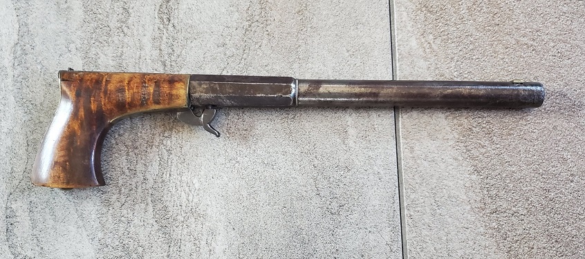

One of the most curious and relatively little known distinctly American pistols is the odd looking underhammer percussion pistol termed as a 'boot pistol' or 'whip socket pistol'. Despite the 'boot' reference, this type pistol, at least the ones from Bangor as this one, were usually worn in a holster.

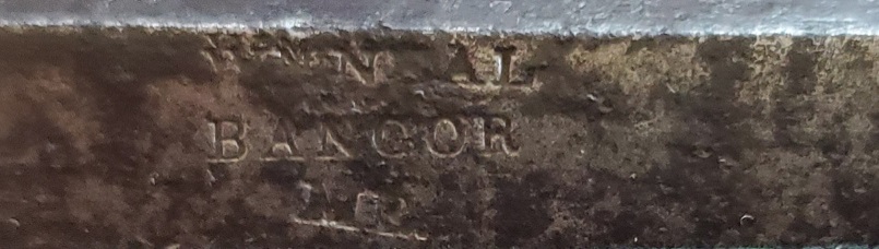

This is marked Wm NEAL BANGOR ME, which was William Neal of Bangor who worked at a shop near east end of Kenduskeg bridge from 1843.
These single shot pistols were begun around 1835 (probably Ethan Allen) and made until c. 1860.
While these single shot boot pistols were of varying styles, the ones by Neal seem to have been consistently this 'saw handle' type, and typically .31 cal.
The lumber industry in these times in Maine was rugged, as were the equally rugged lumber men who spent winters felling timber then later driving the huge logs down the Penobscot River to the mills at Bangor. Much in the manner of the wild mining towns from the Yukon across America's west, these conditions and the rough and tumble characters led to the familiar streets of debauchery with saloons, bars, brothels with Bangor's being the notorious Exchange Street.
This under hammer was made between 1843 and the death of William Neal in 1853. It is missing the trigger which would have been just behind the hammer bar.

Jim, seems a pity no one has commented on this unusual and interesting item. So despite knowing very little about pistols, I will see if I can get the ball rolling again ...
Presumably Bangor, Maine, USA was named after Bangor in Wales ? To all appearances this odd looking pistol would not be very practical, especially if kept in a holster. A derringer type job (easily concealed), preferably with more than one barrel, or a pepperbox, or an early revolver would be much better. Picture a brawl in a logging camp... some hulking brute coming for you with a pick-axe , you have discharged your single shot and it has either missed or not stopped him ... nasty
Hope some pistols experts can contribute to your post...

Colin, thank you so much! You are truly a good sort to come in to support this thread and topic. Too often in the case when readers avoid entering on something if they feel they have nothing to add. The truth is that even coming in as you have and giving thoughts and asking questions creates a context for learning.
The truth is I know little on guns, but as a historian, they hold the same inherent value as swords in that respect, and both present opportunities to learn.
I had no idea there was a Bangor in Wales!!! and not sure of why this city is so named . Actually how I became interested in this unusual pistol was simply because it was from Maine, and I was researching ship building in Maine and a shipwreck. The fact that it was so unusual, from the same place (within 50miles) as well as from a location which I discovered grandparents were from, sort of really set the context.
It was interesting that this lumber oriented place was rough and tumble exactly in the manner of the wild west was intriguing, as well as 'why would a guy wear a single shot pistol in his boot?'.
People always think of these days with 'gunslingers' strapped with guns in holsters on their hip. The truth was, in town, that was simply not the case (even at the OK corral Wyatt was not 'strapped' his revolver was in his coat pocket) as packin' in public was not allowed.
As you have well noted, a single shot spent with one or more guys coming at you in a brawl seems pretty untenable. In the west ,there were small pocket pistols carried in saloons in similar context, which were cheap and unreliable and in fact were colloquially termed 'suicide specials' for the awful situation just described when they misfired.
With the pepperbox revolvers, their big problem was the likelihood that all the chambers would detonate simultaneously, with not too good outcome for the shooter.
I am not sure what the attraction was for the under hammer setup was, it seems to have come about in around 1830s, but the production of these lasted until around 1860.
Thank you again for helping me on this thread, and who knows, maybe somebody out there has seen something like this.

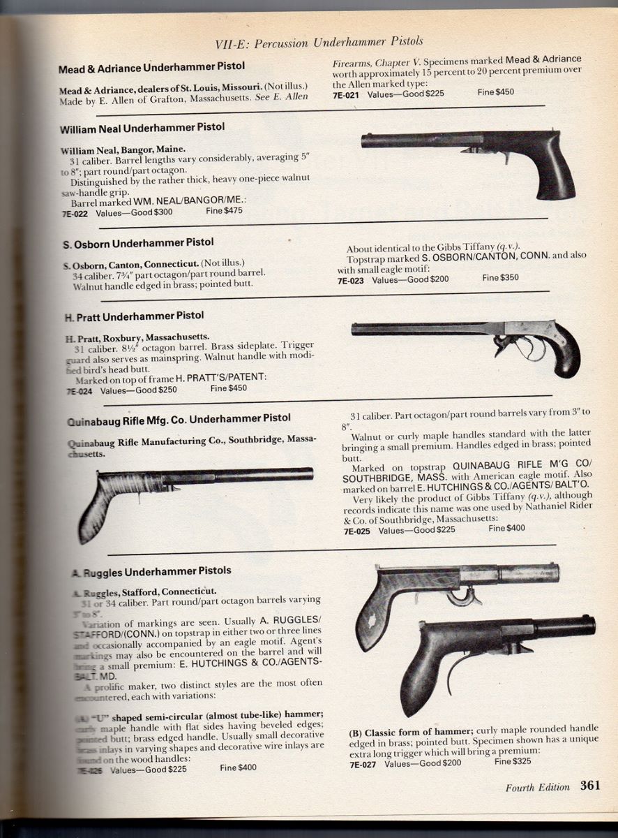

Very nice and interesting pistol Jim. Right up my alley!!! Attached reference from Flayderman shows your piece. The values shown are around 1980 I think. If not allowed please delete them.
Stu

Hi Stu,
Thanks very much for that!!! Its been a REALLY long time since I've seen a Flayderman catalog. He was a great guy, and I always enjoyed talking with him. He was always the 'go to' guy for Americana, and I got some great things from him back in the 70s.
I think what I always liked about this and others like it was the 'saw handle' seen on some dueling pistols of the time. Just unique.
