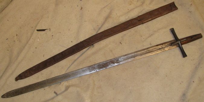

This is something of a first: a kaskara with a Arabic "seal" stamped on both sides of the blade.
It's quite an old piece - a heavy, stiff, trade blade that has seen a lot of use - it has a lot of old, deep scratches in the fuller. It has a forged fuller from the hilt to about a third down the blade and has a well-made iron crossguard with an X. All the leather has gone and the scabbard is not original. The missing grip binding allows an insight into the hit-and-miss nature of lining up the holes in the grip and the tang. The blade is very tight in the hilt - cloth padding is visible.

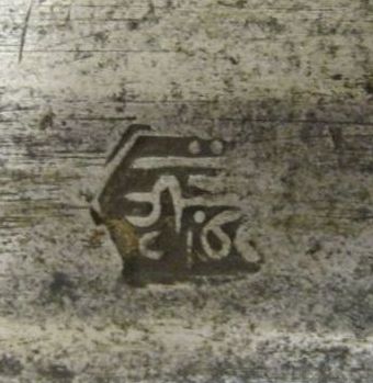

The hexagonal stamped marking is the same on both sides: unfortunately it has not been done evenly but fortunately the whole may be read from the two parts. I have no idea what its says or even if I have shown it the right way up. Perhaps there is a date.
As always your comments are most welcome.

One has to wonder if someone has gone to the time and trouble to manufacture a stamp where are the other items bearing the same indents? A stamp is generally made to facilitate multiple strikings but whether a makers mark, sign of quality or an acceptance mark we will only know when a translation comes forth. Nice blade.

Very nice. Iain, do you think this is a local blade or a european one stamped with maybe an armory stamp? the stamp reminds me of indian/afghani ones.
It says Dawud Ali, btw.

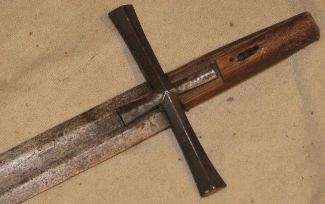

Honestly Stephen has a lot more experience with kaskara than I do, so if he says it's a European trade blade I believe him. The style of cross guard certainly matches with an old sword.
Wood is in surprisingly good shape.
About the stamp, I was half hoping the translation would give a place rather than a name. The name I assume has nothing to give a regional clue? As I understand it Dawud is the Arabic version of David, so probably quite common, Ali of course is a very common name as well in the Sudan.
So, I don't think it's an armoury stamp. I'm wondering if some enterprising merchant stamped a batch of blades he imported or bought up? Would be a decent marketing trick perhaps, as in "I have a Dawud Ali blade and it works great! You should go get one as well!".
That's about the only thing I can think of. As Norman points out, I really doubt this was a one off.

Did I post them upside down? I can't find a Sultan of Darfur or a King of Sennar with that name - the merchant idea is quite plausible. It does seem to be a first in that while engraved or etched inscriptions abound, I have never come across an Arabic stamp on one of these swords. Is it a tughra?

Not a tughra as far as I've seen them if you mean the classical definition of an Ottaman ruler's stamp...
I also think it's odd this is only a name, not a phrase, a verse or anything else.
Glad the merchant idea seems plausible, because beyond that I'm out of ideas.

Salaams, Is there any Arabic stamped on the blade... I see something about one foot down the fuller? The stamp is upside down but no problem it is perfectly translated by A.alnakkas. I see no date. Ibrahiim.

this is a tughra

The more I think about it, the less likely I think this was a local Sudanese application.
If we look at why and how local marks were applied it was usually for talismanic reasons or to imply European levels of quality.
As the name on this stamp does not seem to be a known local ruler or religious figure, I think we can rule out any such properties. Additionally names and religious inscriptions tended to be etched or carved in, not stamped.
I agree with A. Alnakkas that there is a resemblance to armoury stamps from India. I lack the expertise to know if this example is in that style or not though? Perhaps one of the Indian experts can weigh in on the issue?
All in all an intriguing sword, I love these odd pieces that do not confirm to the textbook examples!

hmm, well the stamp has a common name through out the muslim world. Be it urdu, arabic or persian.. it will still be written all the same.
