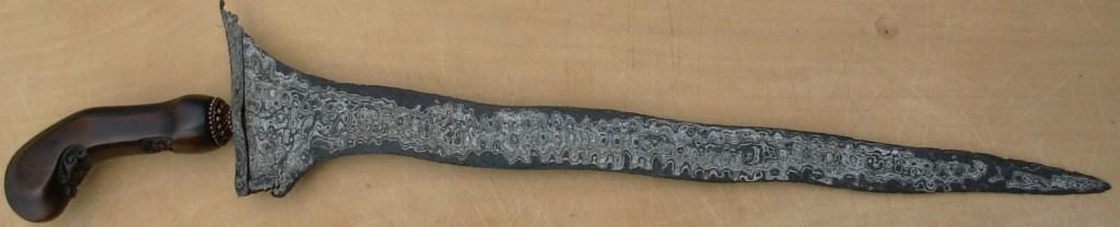

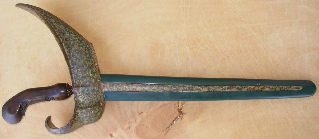

hello together
'd like to introduce you to my newest.
I bought him last night, he belonged to a traveling salesman who has brought him from Indonesia.
I've seen many keris, I own a few, but still almost no painted.
who knows more about it? All information is welcome
thank you
Chregu

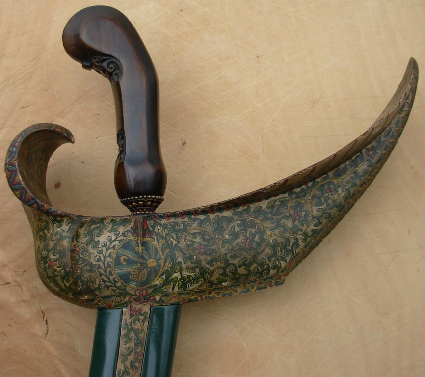

Painted sheaths are referred to as sunggingan Chregu. There has been a little bit of resurgence in the art of late, but yours appears to be an older example which is a bit rarer.
Old 16th March 2013, 09:09 PM   #3
Posts: 6,442

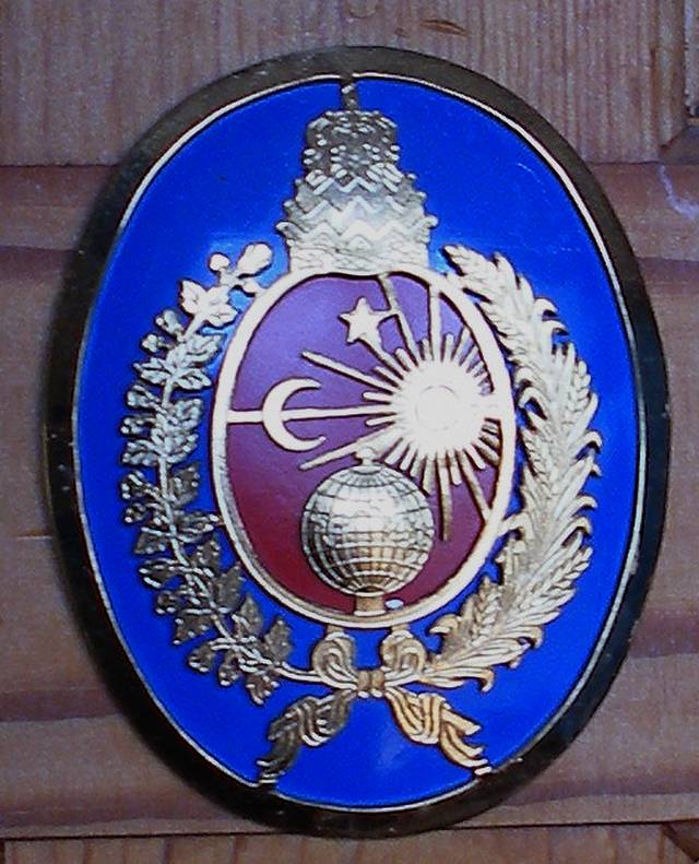

It looks like the seal of Mataram is painted on the wrangka .
This keris looks old and well crafted .

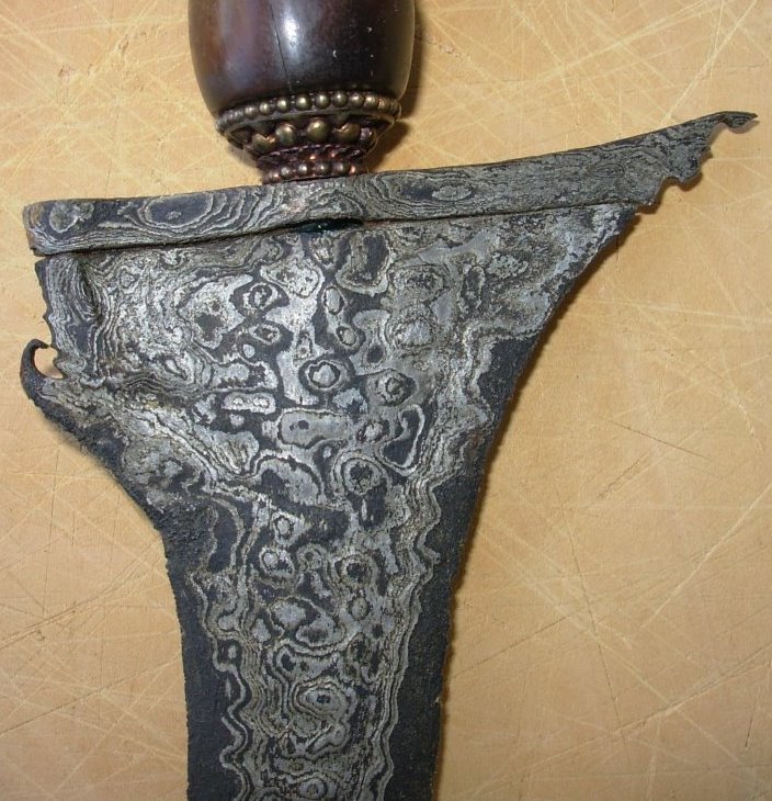

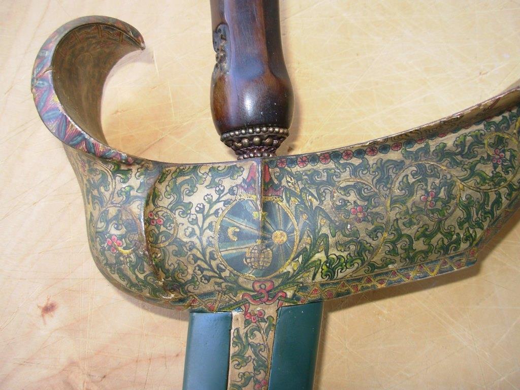

I can't tell if this sheath is old or not but I notice that the atasan was broken in 2 places. The decoration shows the blazon of the Solo kraton but the finish is not that good.

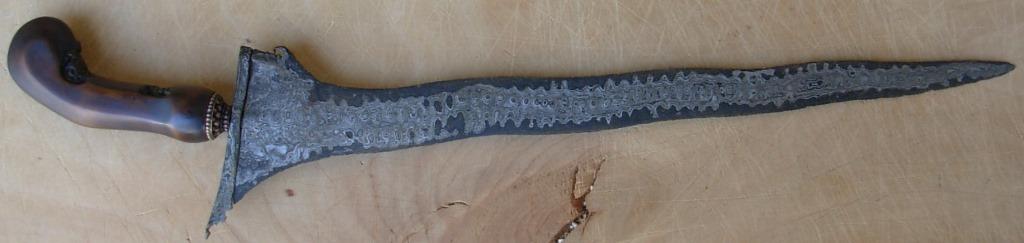

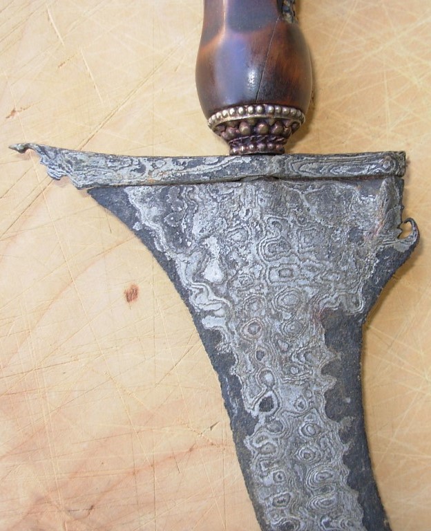

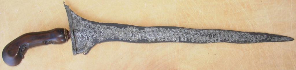

The blade looks old and the pamor is nice (Tirto Tejo?) but it lacks elegance due to the indistinct and uneven waves, these pieces are often attributed to Cirebon, any other opinion?
Best regards

Pre WWII blade ?
Dress is 60's-70's and it's had a beating ?
Pamor control seems pretty good .

to repeat: painted sheaths are called "sunggingan".
"The decoration shows the blazon of the Solo kraton". is it just the whole presentation, or the round part in the middle?

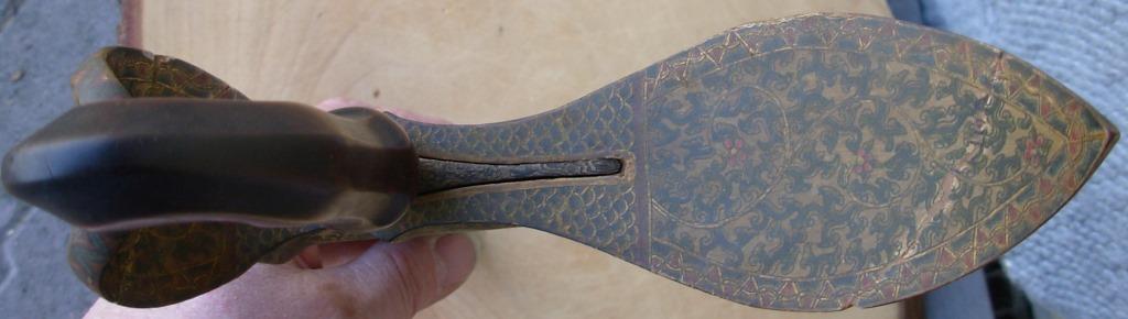

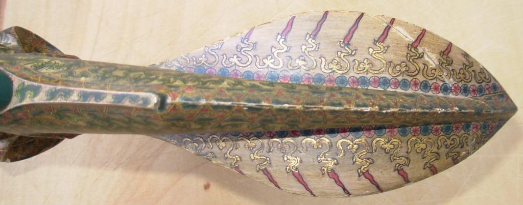

even as an addition: the whole Wrangka thick primed white.
The whole painting is very fine and accurately performed, except everything is painted in gold.

I'm pretty much with Jean all the way on this.
The motif could be given as "lung-lungan", or "vines".
The sunggingan work is quite inferior, the sort of thing you'd buy already done from a market stall. I doubt that it is very old, I think its just had a hard life. The green pendok is correct colour for wear by a person in the Surakarta Karaton with the rank of mentri. The finish on these pendok is traditionally a sort of enamel that we call "kemalo", it is extremely fragile and in an older keris is almost always cracked and peeling off in lumps. More recent pendok are finished in auto enamel, which is much more durable.
Blade style is probably attributable to north coast Jawa, but the width of the blumbangan and kembang kacang form means that it would very probably be given a tangguh of Segaluh.

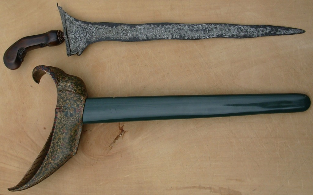

I cleaned the waranka (cotton and little soap) and then oiled.
Now the colors light up again, looks great, has a lot of joy in it.
will again set pictures as soon as I have time in the day to take pictures.

Segaluh is a tangguh from West Java. The shape of the blade let Alan think that this blade can be attributed to this tangguh.

Could be a tritik pamor?
