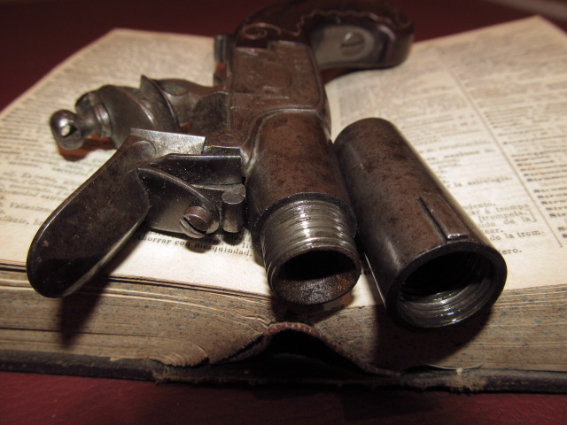

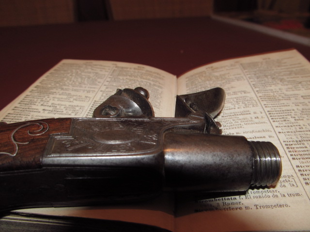

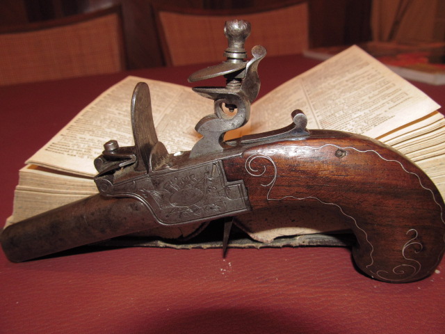

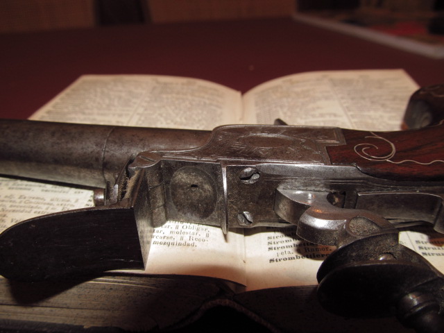

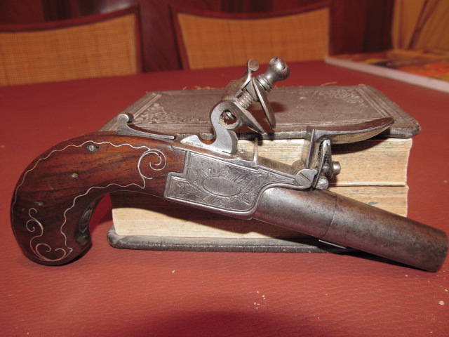

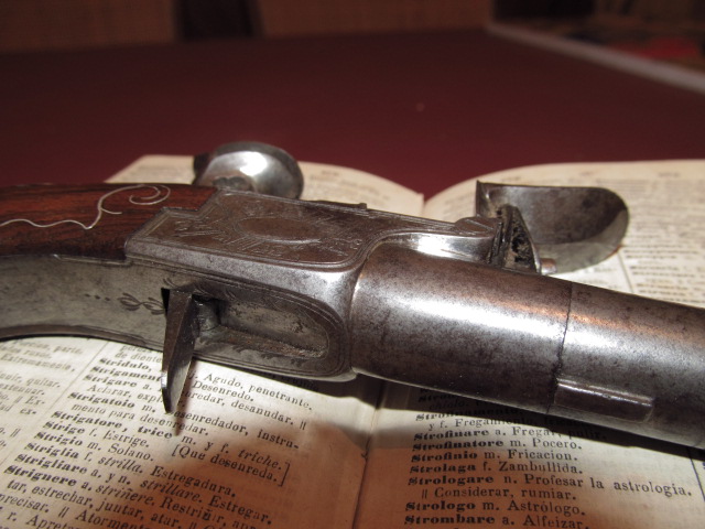

Hello:
This is a pocket pistol, box lock, retractable trigger, with a turn off barrel . Lacks any manufacture or proof marks.
With a .50 caliber, the barrel measures 4.3 cm. and the total length is 16 cm. The engraving has been done with punches.
Affectionately. Fernando K
Hola:
Se trata de una pistola de bolsillo, llave de caja, gatillo escamoteable, y cañon desenroscable. Carece de toda marca de fabricación o de Banco de Pruebas. El calibre es de .50 y mide, de largo total, 16 cm. y el cañon mide 4,3 cm. El grabado ha sido realizado con punzones.
Afectuosamente. Fernando K

Sweet! A very nice Queen Anne twist barrel small pocket pistol, ca 1780-1800. The so-called Queen Anne pistols became popular just after her reign, roughly 1710-1800. Styles of this pistol even managed to make it into the early 19th, as I've seen ones with percussion cap locks. There was a larger version that was popular among naval officers (See 'Weapons of the American Revolution' by Warren Moore, for similar). The smaller ones also had naval use, often being carried in captain's "great pockets" while they wnet ashore. Officers returning from abroad walking through tight alleys to the local tavern were occasionally set upon by thieves. They used a twist tool to remove the barrel end in order to load the ball and powder direct. Some are plain, while many possess inlaid silver wire decoration/patterns in thier grips. I have a smaller one like this with a longer cannon-barrel barrel, but lack the original crank tool to remove it.

Hello Fernando,
From your pictures you have a nice example of an English style boxlock pocket pistol. In the smaller
sizes these concealed trigger examples are often referred to as muff pistols.
Whilst your pistol seems characteristically English in form and style of decoration the absence of clear
proof marks and a retailers or makers name is perplexing. Proof was a legal requirement and this was
strictly enforced. This may indicate continental manufacture in the English style or it is just an anomaly
such as an apprentice piece.
This type of pistol was produced in vast quantities by the London, Birmingham and provincial trade. They
were very popular as their basic boxlock actions were cheap to make whilst their turn off barrel loading
with an over sized ball gave considerable force to the shot. Deliberate aimed shooting was impossible
with the cock in the line of sight but this mattered little at short range or when the mere sight of a pistol
was deterrent enough.
This style of pistol is sometimes confused with the Queen Anne pistol. The true Queen Anne pistol has a
side mounted cock distinctive curving frizzen spring and the characteristic elaborate baluster turned cannon
barrel. Although this form of cannon barrel is sometimes fitted to the best quality boxlocks.
I would date your pistol to circa 1800. The stepped junction at the grip and action can be indicative of the
earliest period of manufacture of the boxlock around 1750 but the plain barrel and general form suggest a later period.
These pocket pistols continued to be manufactured with precussion locks well into the 19th century.
I hope this is useful.
Simon.
