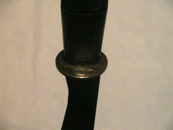

Interesting that this one has a full length tang and butt screw. Not typical for Visayan knives and swords which usually have a blind tang construction.

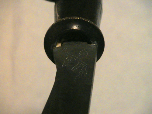

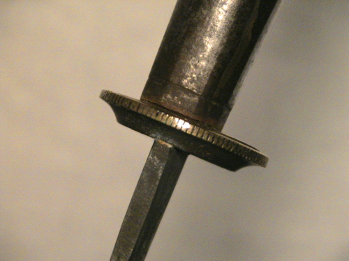

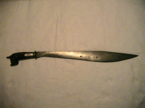

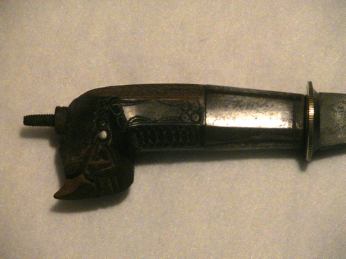

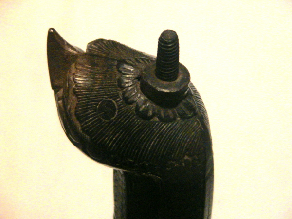

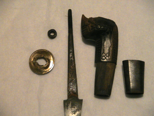

ian, yeah, visayan sword with full length tang and a butt screw is not that typical. that said, here's one i've had. notice the chisel side is not too pronounced. another unusual part of this binangon is the disc guard, which i think, is a coin or a medallion, due to the ridges on the edge.
