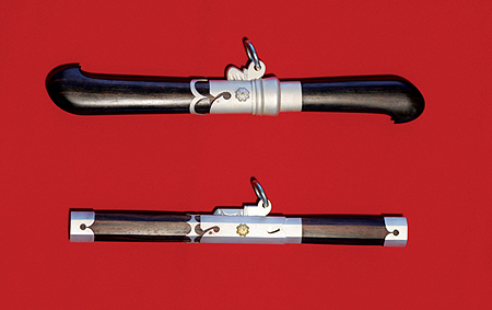

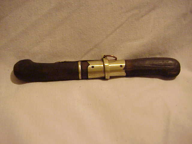

recently this small dagger was sold by ebay. It was described as woman dagger from Korea, eunjangdo.
Would like to read your opinion about this dagger and get some more informations about this kind of dagger.
Old 26th February 2012, 04:58 PM   #2
fearn
Posts: 1,247
I agree with the description. That said, there appear to be some condition issues on the blade. I'm a little puzzled by the changes of wood color under the metalwork.
My understanding is its intended purpose was for a woman to defend her honor, in a society where a woman's place was defined by strongly Confucian values.
F

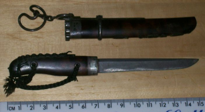

Old 28th April 2012, 10:42 AM   #6

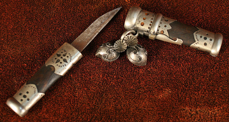

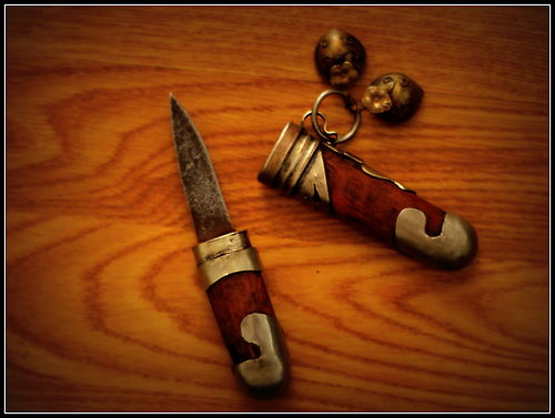

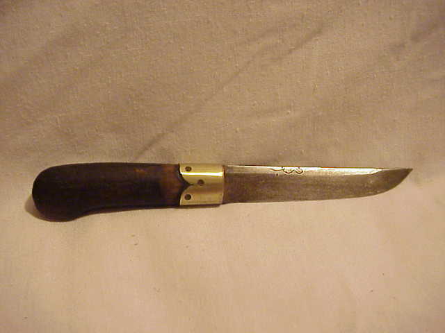

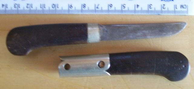

I have played the ebay gamble and win yesterday this one: http://www.ebay.com/itm/290700845009...84.m1439.l2649
What do you think about?
Old 28th April 2012, 07:32 PM   #7
Lew
Lew's Avatar
Location: East Coast USA
Posts: 3,191
You won yourself a nice puukko.
Congrats

Lew,
I think and hoped that it is an eunjangdo. See for comparison the example in up. Maybe not so fancy like the one in up but I think that by this one I can be sure that it is authentic. And i like the well worked small blade with the mark.

Old 29th April 2012, 06:23 AM   #10

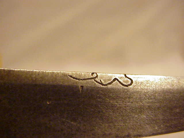

I am puzzled by the arabic(?) markings. Was it common on puukkos?

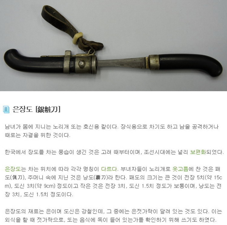

Hello Lew,

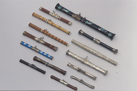

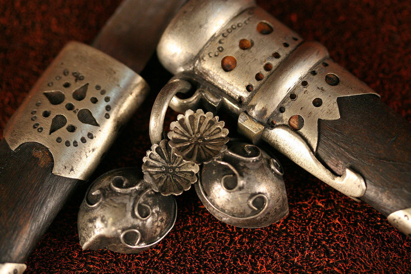

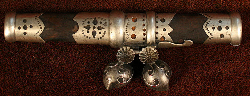

they are indeed very similar! But look for example this pictures I found in the net. By the group picture look special the one in complete down on the right.
Old 29th April 2012, 10:42 AM   #12
This markings are also to seen by one which is actually for selling in the moment so I can't post pictures but will do when the auction is ended.
Old 29th April 2012, 11:05 AM   #13
Henk
Henk's Avatar
Posts: 1,209
I'm rather convinced this is not a puukko. If it was a puukko you would have also a nice catch.
But the blade is different to that of the puukko or other scandinavian knives. Also the dress is a bit different. I can understand that Lew is seeing a puukko, but the difference in the dress is the metal strip or clip on the backside of the scabbard on wich the ring is attached. I've never seen something like that on scandinavian knives or puukkos.
The marking i don't know. Arabic? Maybe, but could also be an old asian language. As far as i know it is certainly not common on the puukko.
Old 29th April 2012, 11:33 AM   #14
Hello Henk,
agree with all you have written. And I am with you that I don't think that is an arabic writing. Would be nice to read what our arabic friends will say about this.

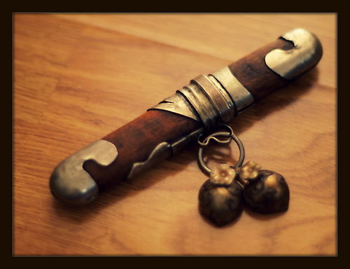

Old 2nd May 2012, 09:27 AM   #18
Timo Nieminen
Timo Nieminen's Avatar
Join Date: Mar 2012

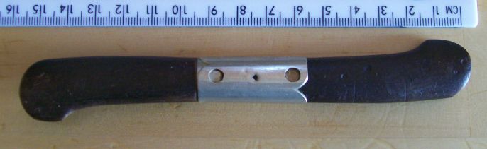

Posts: 422

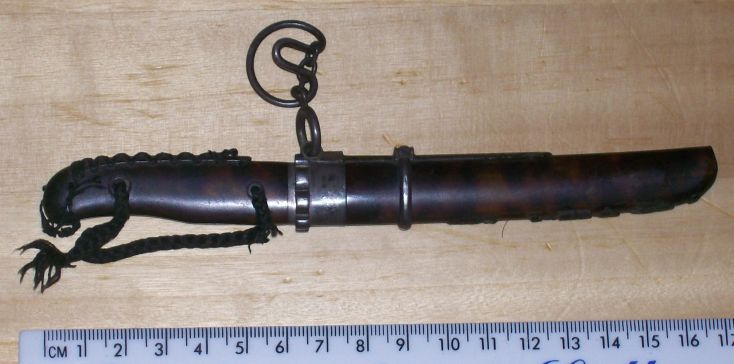

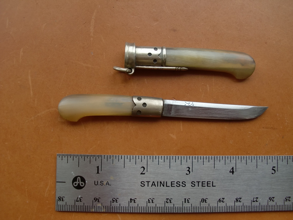

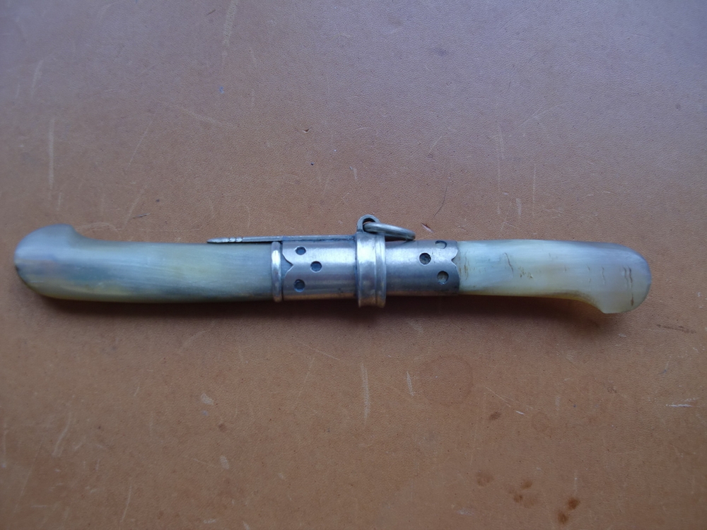

Here's my one-and-only eunjangdo. Horn grip and scabbard, with silver(?) mounts. Unfortunately missing the mount over the underside and tip of the scabbard. It's very thin; the blade is 2.35 mm thick at the hilt, and the grip is 6.5 mm thick. The other side of the blade is flat.
I'm told by Koreans that these are, in terms of knife-use, purely suicide/self-defense knives (either being seen as acceptable for rape prevention), rather than being used for any kind of everyday utility tasks. Primarily for suicide, but killing the attacker would not be seen as dishonorable. For upper-class women only. Whether that means nobility or nobility + yangban (i.e., Korean gentry), I don't know, but I think the latter.
It also functioned as decoration and, more importantly, an indicator of class.

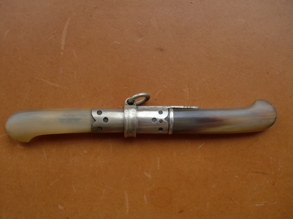

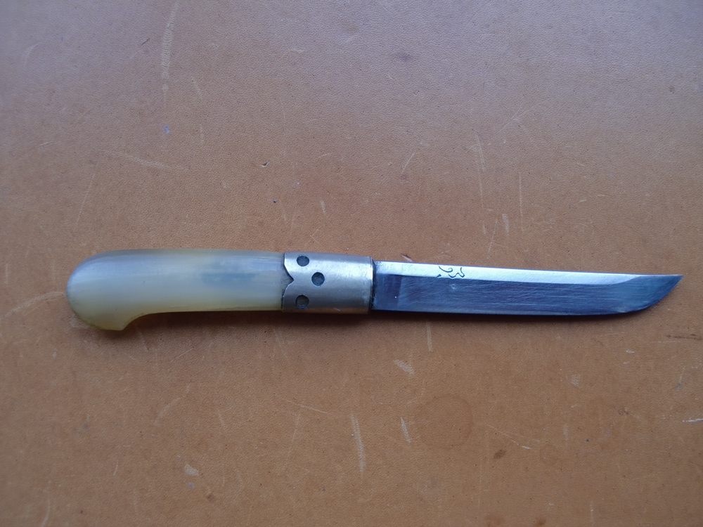

Old 2nd May 2012, 06:43 PM   #19

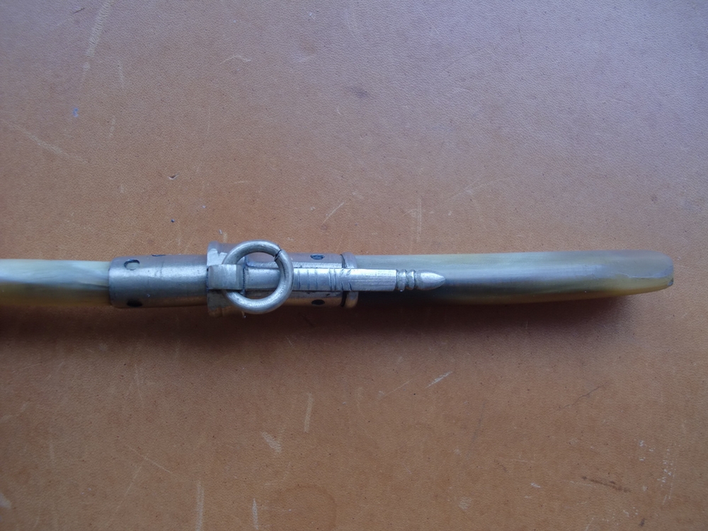

Hello Timo,
thank you for sharing the pictures of your nice example as well the further informations.

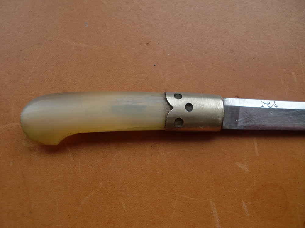

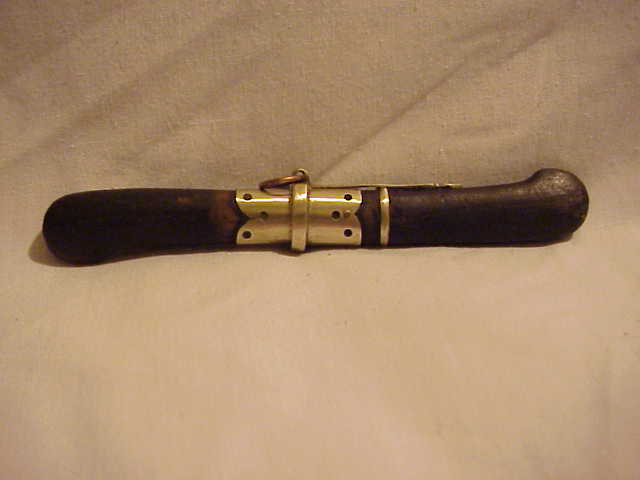

Here one which was sold recently by ebay but I believe that this one is not very old but a nice looking one with a similar mark at the blade. Grip and scabbard from white horn.

They still make these, and jangdo in general (jangdo = decorated knife, eunjango = silver decorated knife). Jangdo also includes knives for men (which can be much larger than the tiny women's eunjangdo), and eating/utility knives.
Some of them are of very high quality, with high prices to match. The modern cruder ones might be the cheap version. So not fakes as such, but modern costume pieces.
Up to the Japanese colonisation, these were everyday wear (for the appropriate classes).

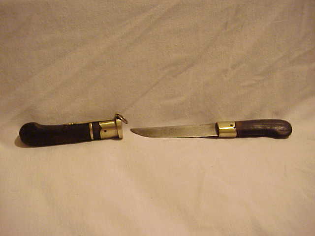

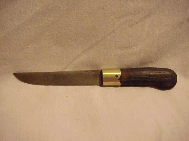

Old 7th May 2012, 09:13 PM   #23
Thank you Timo, I think this thread is now very informative about this knifes. So i think when I see nice ones I will post them here.
Here one just ended by ebay but wasn't sold.

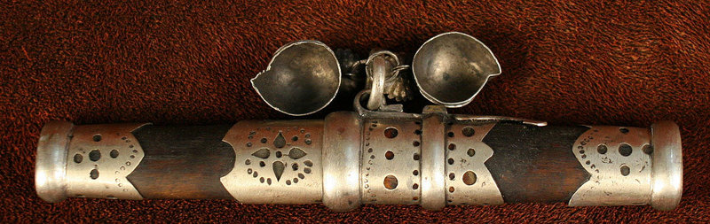

Old 21st October 2012, 01:01 AM   #24
Timo Nieminen
Join Date: Mar 2012
Posts: 422

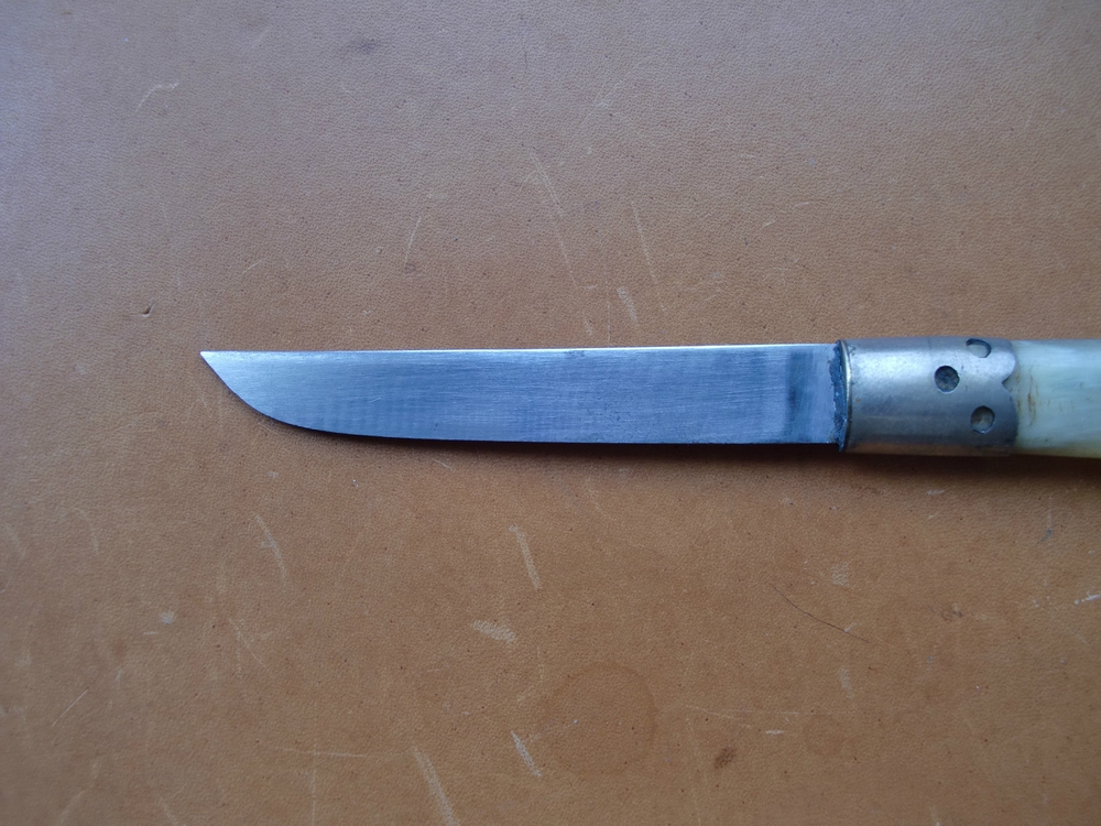

Here is one rather like the one in post #6. Simple compared to the fancier ones in this thread. The "inscription" on the blade is the same as the ones in posts #6 and #19.
Hi
very fancy knife,
but the writting is what ever you want ... as language
except ... Arabic

Old 21st October 2012, 10:42 AM   #26
Hello Timo,
is it yours? When yes, can you post better pictures from the writing on the blade?

Hi Dom,
think that it will be korean writing.
Old 21st October 2012, 11:39 AM   #28
Timo Nieminen
Join Date: Mar 2012
Posts: 422
Originally Posted by Sajen
Hello Timo,
Yes, mine. A picture good enough to see it clearly will require a visit to a better camera than mine (even if mine cooperates and focusses, I don't think it will be clear enough). Will see if I can get a better one.
Essentially, the same as the other ones. I don't know what it means. It isn't recognised as writing by (typical modern) Koreans. If it is a script, it is probably
Siddham, a Sanskrit-derived script still used for Buddhist inscriptions in East Asia (called "Bonji" in Japan).
Timo Nieminen is offline   Reply With Quote
