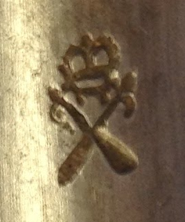

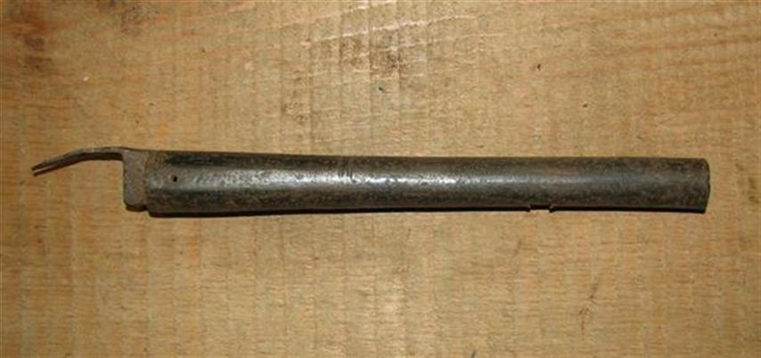

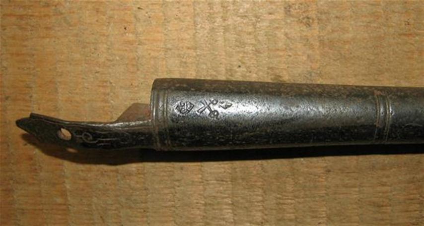

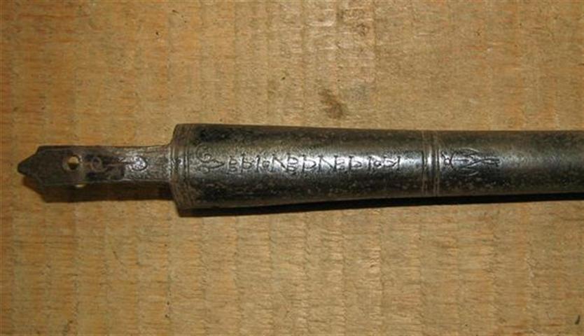

This is a smooth bore pistol barrel. Does anyone know the markings on the barrel? Looks Greek to me. Thanks for any help. Rick.

I keep looking at this but every time I do, I find myself puzzled. I have to say that I don't think it looks like Greek (at least, not any Greek script I've ever seen - I wouldn't pretend even for a second that I have any ability in the language), or indeed Cyrillic.
Weirdly, the marks almost look more like the sort of talismanic stuff you normally see on swords and the like from Northern Africa, to my (untrained) eye at least. Perhaps a North African pistol barrel?
Also, what's up with that little scab of metal toward the fore-end? It looks as if someone's been at it with a file.

Shown in the third picture looks like somewhat of a probationary stamp of the third test trial of arms, Birmingham, placed untill 1904- see attachment.

I have thoroughly gone thru my Proof Mark reference books and can find no mark the same as those shown on the side of the barrel. The crossed maces?? look a bit like the marks used by the Birmingham Proof House in the UK but are NOT the same, so the origin remains a mystery. As to the marks on the top of the barrel, I have no idea at all. The script, if is IS actually script, is not familiar.

Dont know what the script is, or even if it is one, but the proof marks look like the British pre-1813 Kings Proof and View mark, see http://www.birminghamgunmuseum.com/m...ptres_Mark.pdf
