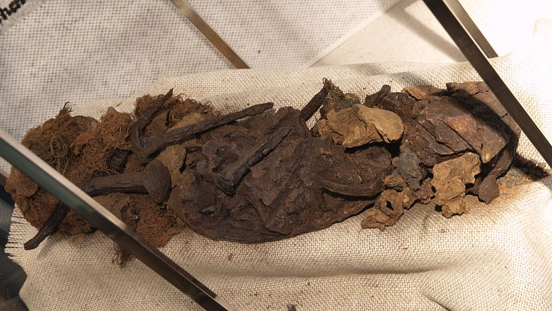

Some of the wrecks cannons were found loaded. One was loaded with large iron nails, iron fragments, clay and hemp fabric (see image below), the other one with 9 inch iron nails embedded in loam (unfortunately no image available).

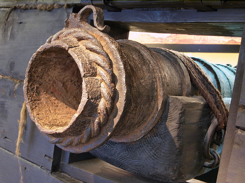

Very interesting is a Stabringgeschütz having soewhat like an iron rope as reinforcement of the muzzle. In the present status of conservation it was not possible for me to decide if this is really a braided/twisted rope of iron or if this is only a rope shaped iron band - or possibly it is a braided/twisted iron rope which has been forged over.

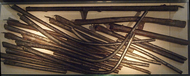

Other notable finds are lots of aquebuse barrels, knife blades and knifes and more than 8 metric tons of copper ingots.

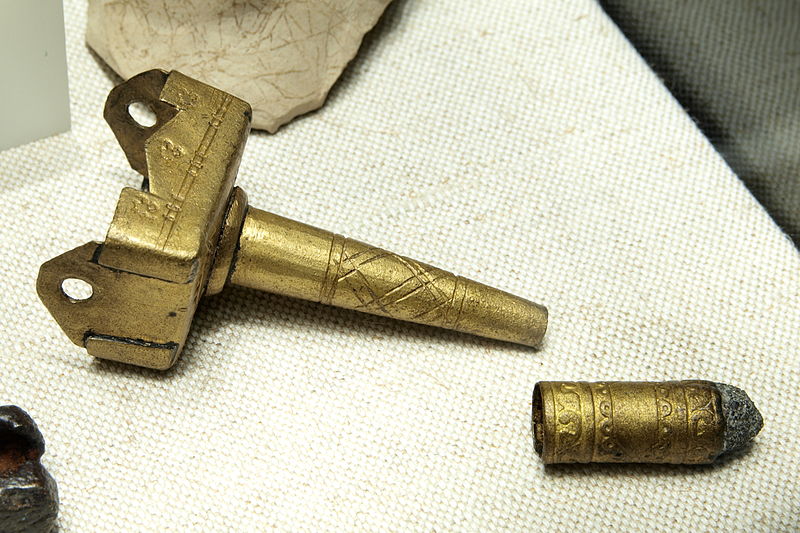

First one is a tip of a powder horn with cap.

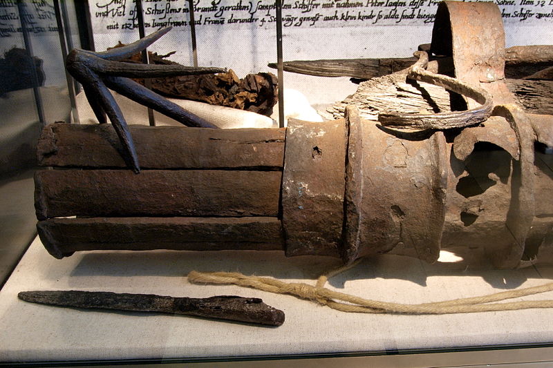

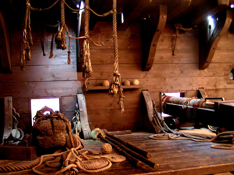

The second photo was made by Sebastian Sonntag showing the inner side of the reconstructed ships deck in the Museum. Both cannos seems to be breech loaders. At the left piece (image also above from its muzzle with the decorative twisted iron band) the end is broken or rotten away. The piece on the right piece has an inserted chartridge. Here are also some of the ston balls found in the wreck.

Wow! Great pics! If it has anything to do with shipwrecks, naval weapons or pirates, it will catch my interest. I'm assuming the Elbe was a deep river to allow such a large ship to sail in it? The bent aquebus barrels are particularly interesting. The weight shifting in the hold or the ship's collapse must have done that.

The arquebuse barrels were new and unused matchlock types. Either they were bent by a heavy weight or by the excessive heat of the burning wreck. Especially one barrel is smoothly bent on its end.

It looks to my humbles eyes, as also judging by the context that, the rope reinforcement of the cannon, was actualy mechanicaly twisted iron that was after applied to the muzzle.
I don't know whether to be more amazed with the bending of the aquebus barrels or with their extremely long length.
