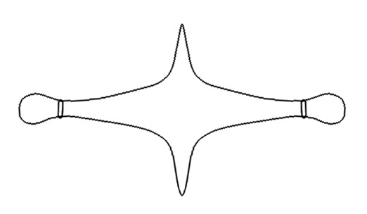

i am currently looking into the origins and dating system for this specific type of quillion block.
all books tend to assume the earliest form goes to the 17thC (and of course into the 19thC), but i wonder if this assumption is becauce few (if any) earlier examples exist. i personally feel it could go a few hundred years earlier.
please note the proportions, the rounded quillion ends and the ridge before the elongated ball-ends.

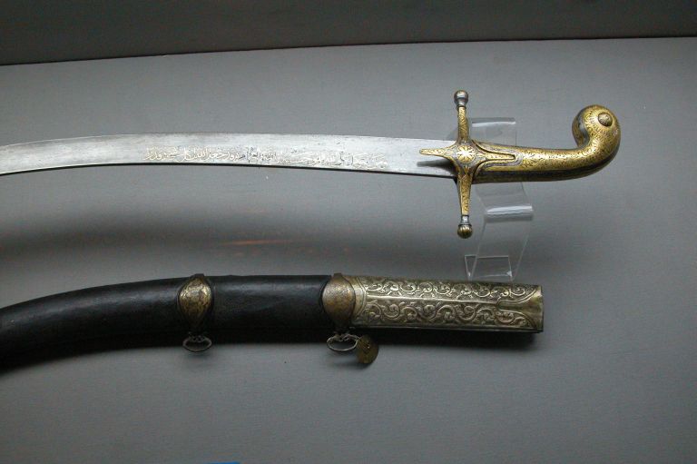

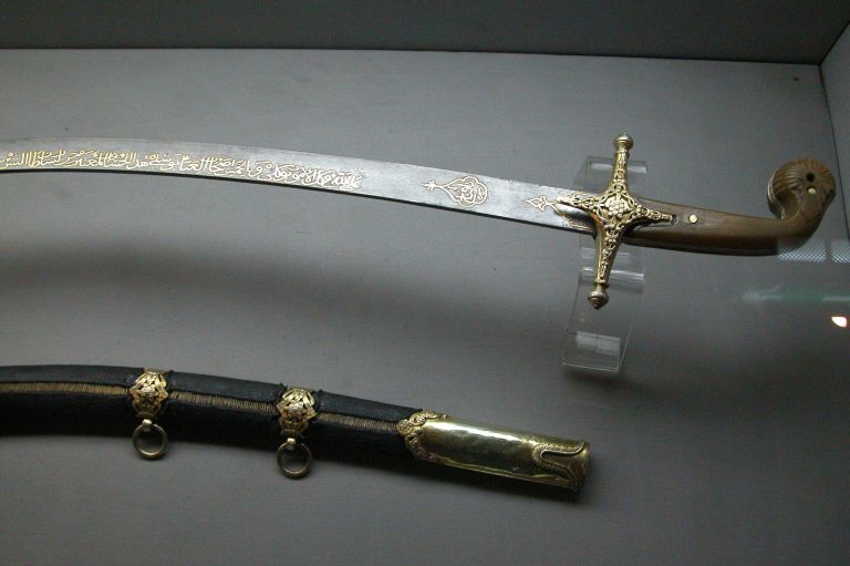

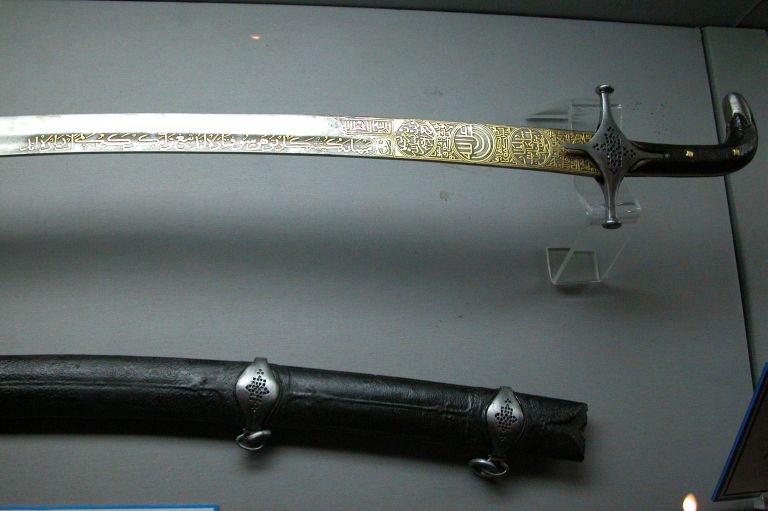

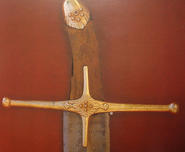

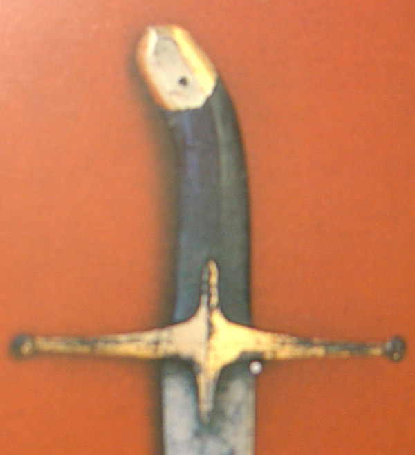

Ok, so, just to set the ball rolling, here I put some swords from the Military Museum in Istanbul that are labelled as 16th c. and that allegedly belonged to some of the Ottoman rulers of that time. Sadly, I know nothing about the reasons that may support such attributions (I suppose the inscriptions in the blade may have something to do with it) nor how reliable may they be.
In fact, I'm afraid I must confess I don't know enough about "eastern" swords of this period to really feel comfortable discussing the finer points of the origin of a crossguard typology, but I happened to have these pictures and thought they could contribute to this subject...
Marc is offline   Reply With Quote

By the way, for more and much more detailed pictures, HERE is where I found them.

marc, thank you for the images. the blades you show are wonderful, but unfortunately it is these swords that are leading the arguements against me. all the hilts are later. whilst i would hope the quillion blocks could have been original, the grips are definately a latr addition. the grip would have been slightly slanted off to one side with a pommel cap. btw, can you read french (an obscure and unrelated question)
Thought so, but I felt it was at least worth a try. I'll keep my eyes open, anyway.

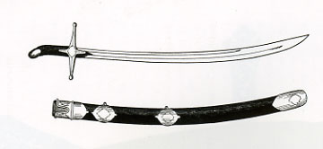

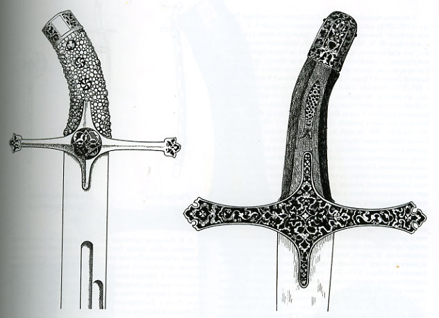

Sorry about that. Attached are:
late "mamluk" (??) , and two "turkish" sabres, XVI century.

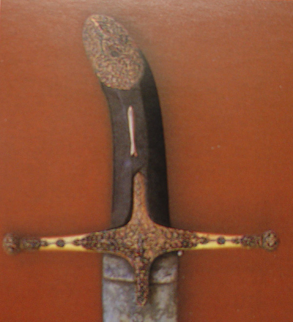

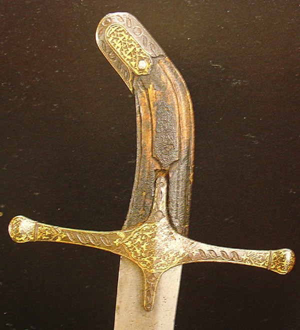

i have attached some early pieces from the topkapi (sorry for the poor quality). where many of the swords were thought to have later hilts, these are clearly early and more like the one i am after (although the quillions are somewhat longer).

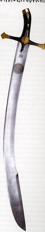

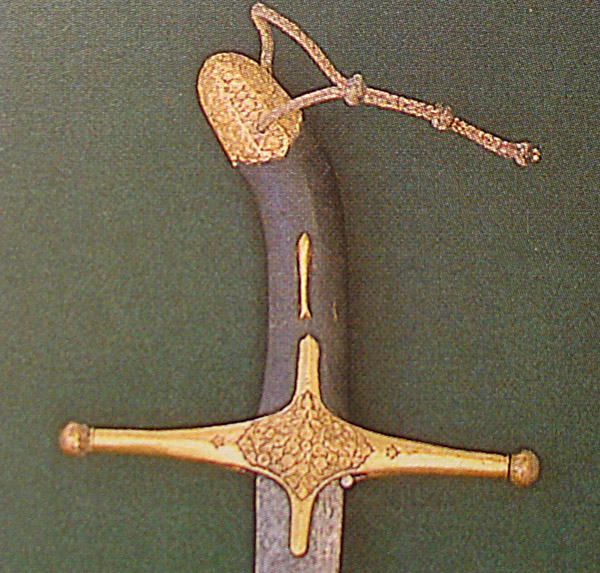

Astvatsaturjan is very specific in attributing the attached kilij to 16th century. I do not know if it is what you are looking for.
Rivkin is offline   Reply With Quote

yes, this is exactly what i mean, and the sword you show is of the same ilk as the last pics i posted. i think what i am looking for is the same, but maybe a little shorter in width, and definate dating.

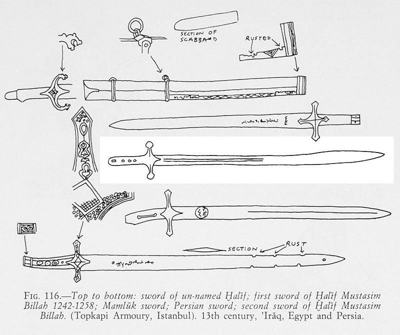

Old 13th December 2005, 11:08 PM   #17

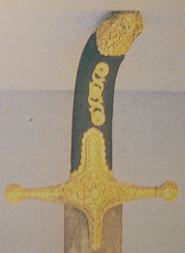

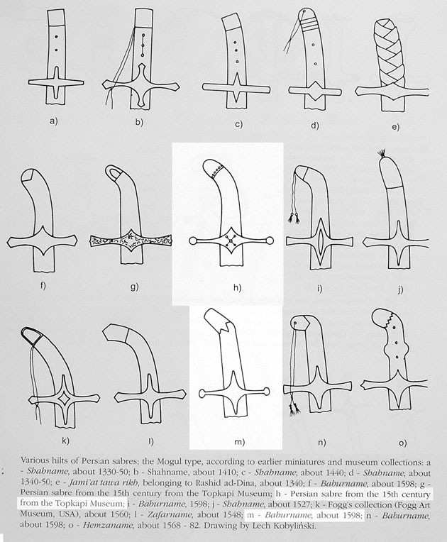

Arrow
Hello Brian!
First of all my apologies I wasn't here from the beginning as you expected, but somehow I didn't pay attention to this thread, and I've just missed it . Now seeing how many petitions were send to me, I feel honor bound to answer, but I'm afraid that knowledge and resources aren't always with willingness in pair.
It's really hard to find such hilts earlier than in 17th century, when they were spread around the world through Persia to Poland and to other countries. I always had the feeling (and maybe I'm wrong!) that dating of eastern/islamic objects is always problematic and very often not precisely, because of very preservative forms which existed through the centuries. Those beautiful sabres dated on 16th century seems to be later too (anyway the hilts seems to be later), and (knowing Museum reality) very often some objects are attributed to persons (like Sultans, Kings, noblemens, heroes) only because of the tradition. Then you can read "16th" or "17th century" even if curators are sure they're later. It only complicates even obvious facts, and is making the researches harder.
Here are two pictures. I'm not quite sure this is what you're looking for, but lets make another try in this thread. First picture is more important, because it refers to sabre from 13th century (from book: David Nicolle, Early Medieval Islamic Arms and Armour, Madrid 1973). The exact sabre is brighter. Second picture is from catalogue Orez Perski (Persian Arms and armour) by A. R. Chodynski, and is showing hilts of Persian sabres through the ages (classification made by Lech Kobylinski).
Hope it will help somehow
