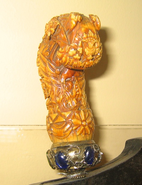

Alan's remark above on another thread (the hilt-selut combination of Sirek's keris enclosed below, pict. #1) reminded me to bring up this matter that has "disturbed" me for some time.

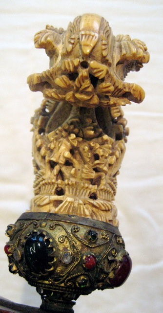

The first time I saw a Donoriko with this kind of hilt was at a Danish auction house several years ago and I laughed about it and believed it to be a local upgrade by a dealer or an enthusiastic collector. About a year after I saw the same combination at a dealer's shop in Paris and was a bit disturbed about it but thought that maybe two dealers had got the same idea. Some time later I saw it on eBay from a seller in Florida and this time I bought it for myself (see pict. #2).

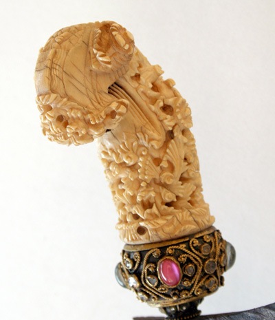

A couple of years ago one of the Singapore or Malaysian collectors of this forum (Shahrial?) published pictures from a visit to the National Museum in KL with another example (see pict. #3). Thereafter I have seen it a few times in other collections and now on Sirek's keris in Holland too.
So when I read Alan's comment I agree in "taste". But after having seen it so many times and on keris distributed all over the world I find it hard to shrug it of as a dealer's combination.
Anybody else who has the same experience?

Hello Michael,
To me, selut specimens #2 & 3 do not seem original (they do not fit well) and they look low quality pieces from the pictures, but specimen # 1 is a different issue. Of course this is my personal and uncontrolled opinion only.

So, I guess the question is:- are selut of this type a correct and original part of Madura keris dress?
Based upon what I know, and upon what I have seen, it is my opinion that they are something intended to facilitate sale to people from outside the Madura community.
Thanks Alan!
That was what I was curious about, if it was a custom for locals or not to upgrade with this kind of selut. Somehow I suspected, after being exposed to this combination all over the world, that it was somebody close to the origin who did these upgrades, and not for instance a European dealer. Probably he wasn't the only one with this idea either based on how the market functions...
