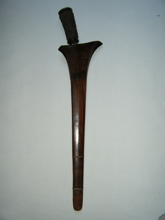

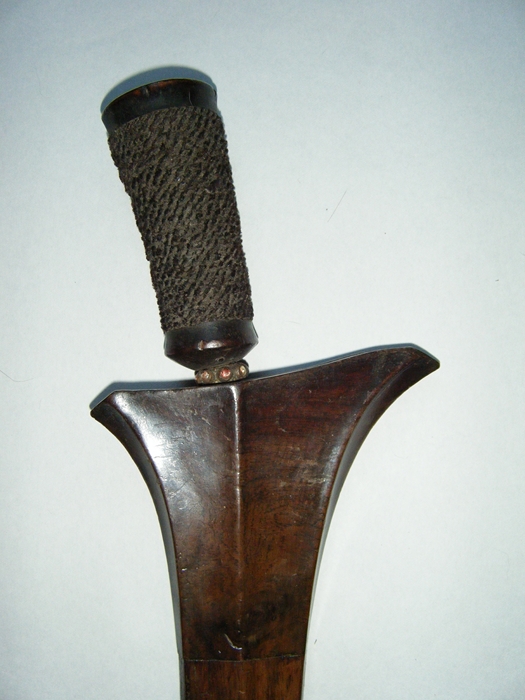

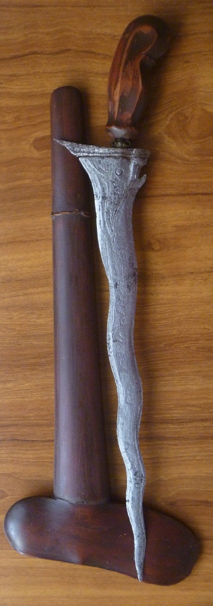

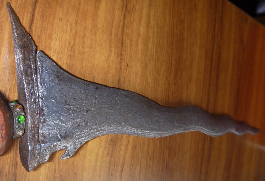

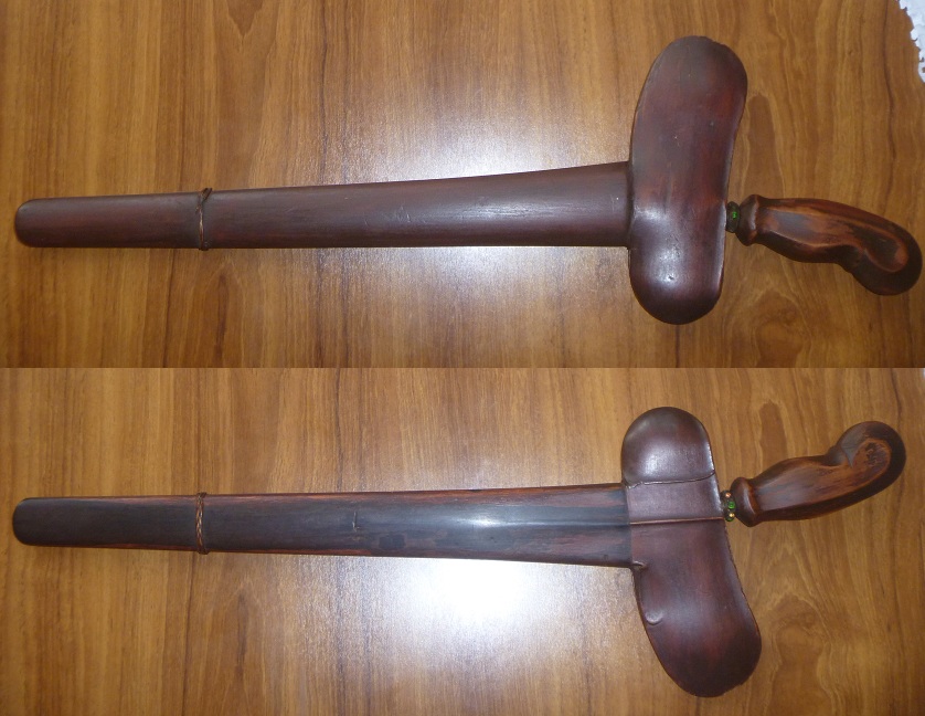

I don't know much about this keris so any ideas on where it's from and when it was made would be much appreciated.

Well, the dress is obviously of Bali origin, but the blade itself seems to me to come from elsewhere. Is there a tight fit between blade and sheath? Some better photos would be helpful. Maybe get some light on the gandik side of the blade.

My personal guess would be: sheath & hilt from Lombok and blade from Sumbawa, but it is difficult to be sure from the pictures and the condition of the blade (unstained).

Hi Jean. Generally when i refer to a keris (or keris dress) as Bali i also leave the door open for the Lombok possibility since for the most part the major influence on Lombok keris is Bali. However, i am curious what elements of this keris dress lead you to more specifically guess at Lombak and even more curious what specific elements of this blade lead you to think Sumbawa.

Lombok is always a good guess for something that doesn't quite fit into Bali, or generic Bugis, or Jawa.
There were settlers there from all these places, Bali colonised Lombok, the Bugis people established more than a foothold, and people from Jawa came to there too. They all kept their own style of keris --- and I guess other cultural appurtenances--- and after all the conflict died down there was a good bit of swapping and changing blade and dress styles.
I've handled blades that except for size looked 100% Jawa, the Lombok ones were bigger, but these were definitely Lombok origin. Often Lombok/Bali is simply impossible to differentiate, in fact the Raja of Badung (Den Pasar) had a number of Lombok/Bali keris as part of his regalia.
Bugis keris have certain generic characteristics, but if you mixed up 100 generic Bugis blades I doubt that anybody could identify the point of origin of those blades.
I once made a fool of myself by declaring unequivocally that a particular blade from a world famous museum was not from Palembang, but rather from Mataram. Turned out that it had provenance that made it very difficult to believe it could be from anywhere other than Palembang.
Another thing too:- smiths moved around. If work was slack in one place , they'd move to somewhere else. The chronicle of the Line of Descent of the Empus of the Land of Jawa attributed to Pangeran Wijil is full of the movements, marriages and children of these itinerant smiths.
I have a particular type of very rare Moro style keris that comes from Northern Borneo, it was actually the state execution keris of Brunei, it is of 100% Madura workmanship, and Madurese smiths were very widespread across S.E.Asia. Why? Because Madura was and still is, a pretty hard place to earn a living.
I'm mostly pretty comfortable in identifying Javanese and Balinese blades --- I regard Madura as a part of Jawa--- I'm not all that bad on Lombok blades, other people are pretty good with Peninsula blades, but once we move outside these areas I do really think it becomes a bit of a lottery to try to pin specific origin on generic blades.We can't rely at all on dress to help ID a blade, blades moved from one dress style to another with great regularity. A few years ago it was not at all unusual to come across Balinese and Bugis blades in Javanese dress, old Javanese dress that had been made for the blade. Why? Because the rulers and lords in Jawa used to employ these people as guards and soldiers.
There are a lot of traps in trying to ID non-mainstream blades.

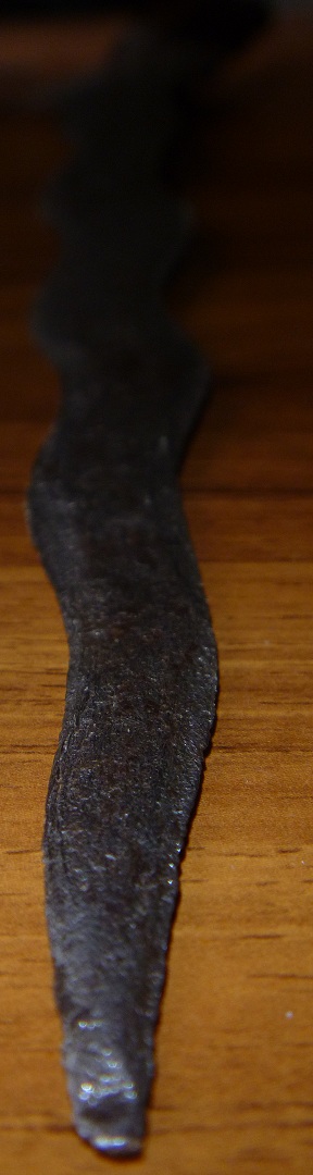

The blade fits very tightly in to the sheath (almost too tight).
The length of the blade is 350mm so just under 14 inches.
I can take some more photographs in a few days and post them here.
After I purchased this keris I removed the stain not knowing how the blade should look. The steel it's made from is very eye catching. It has a very attractive silvery glow and I think it looks better this way. I don't mean to offend anyone , I know the keris is a very spiritual object and has a great history in many cultures, so please excuse me if I did.
Thanks for all the replies

I don't think that you have offended anyone, but i would imagine that most keris enthusiasts would prefer to see this blade with a traditional stain that shows off the pamor pattern.

. The sheath and hilt are in rustic style, the sheath is short, and the rattan binder on the gandar looks rather from Lombok than Bali.

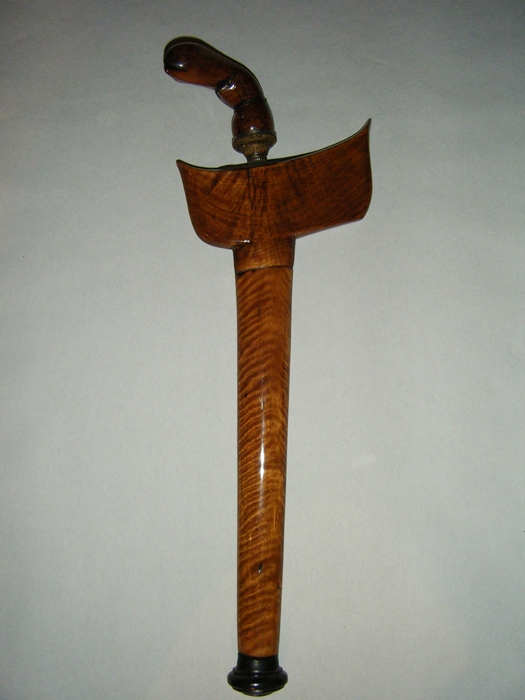

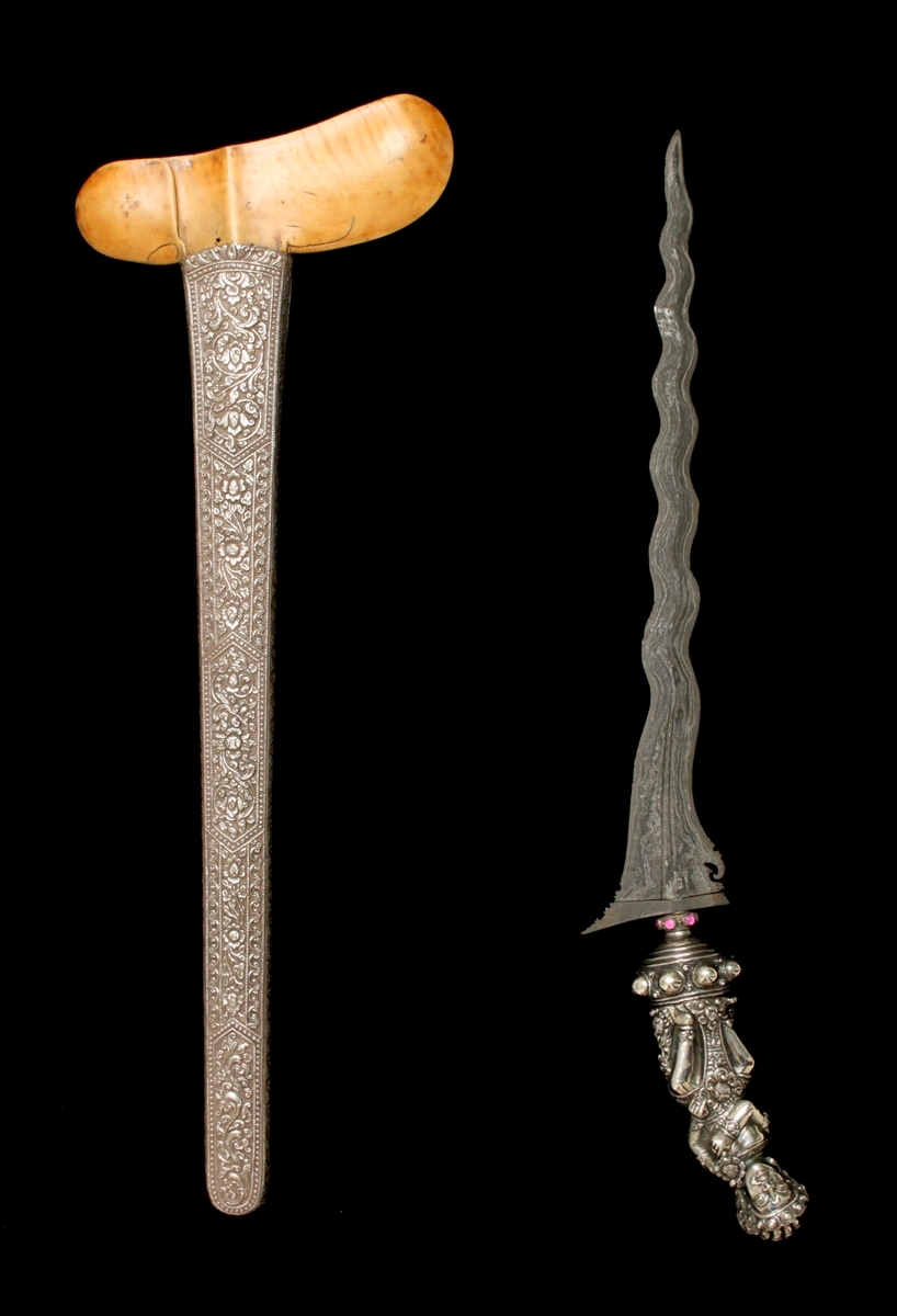

Another Bali/ Lombok kris with a regional Bugis style blade with 15 luks, look at the kembang kacang and lambe gajah especially.

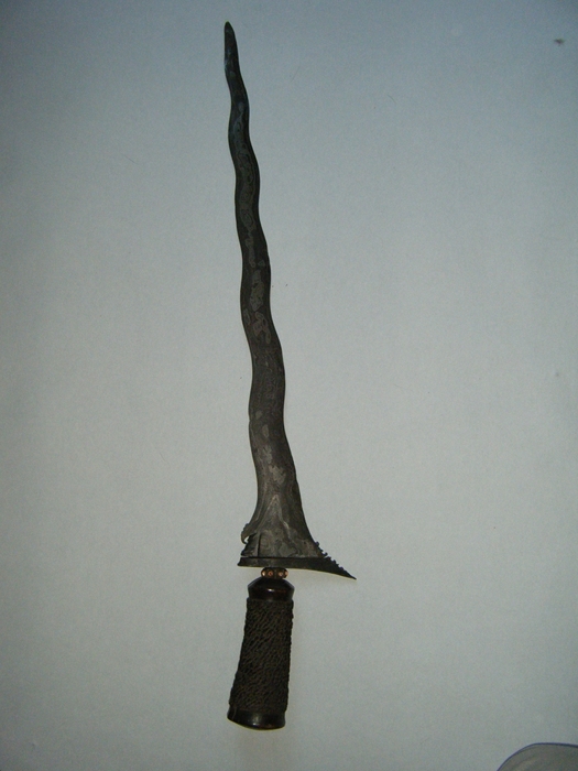

I was referring to the keris from Fheng. The keris you have shown have indeed some affinity with a keris I own and was with some certain purchased on Sumbawa. When you like I can present pictures from this keris as well.

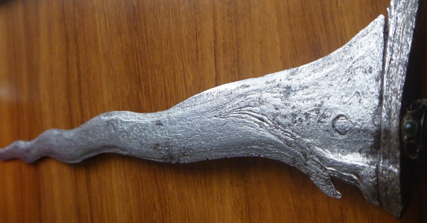

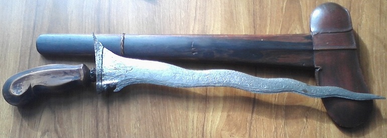

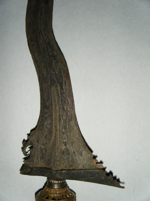

Here at first pictures from my Lombok keris with similar blade. The contrast of the pamor is very low.
Last edited by Sajen; 29th September 2012 at 08:16 PM. Reason: forget the pictures

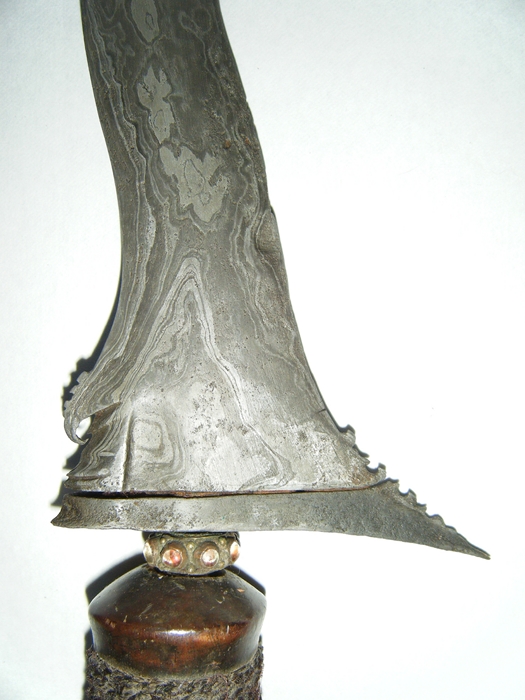

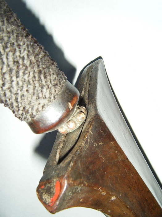

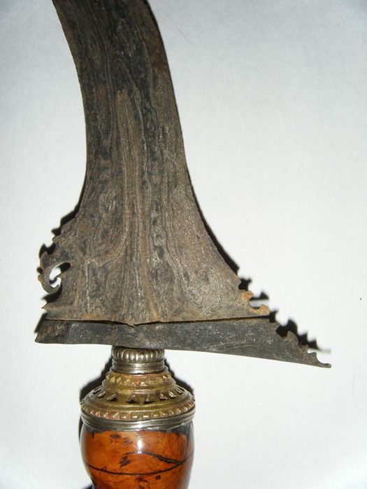

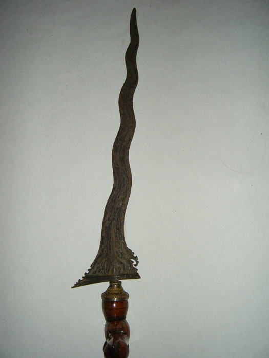

And here the Sumbawa keris in my possession which I bought once from Pak Hartadi.

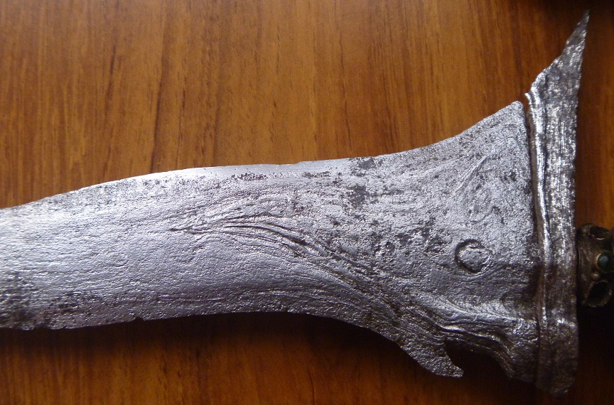

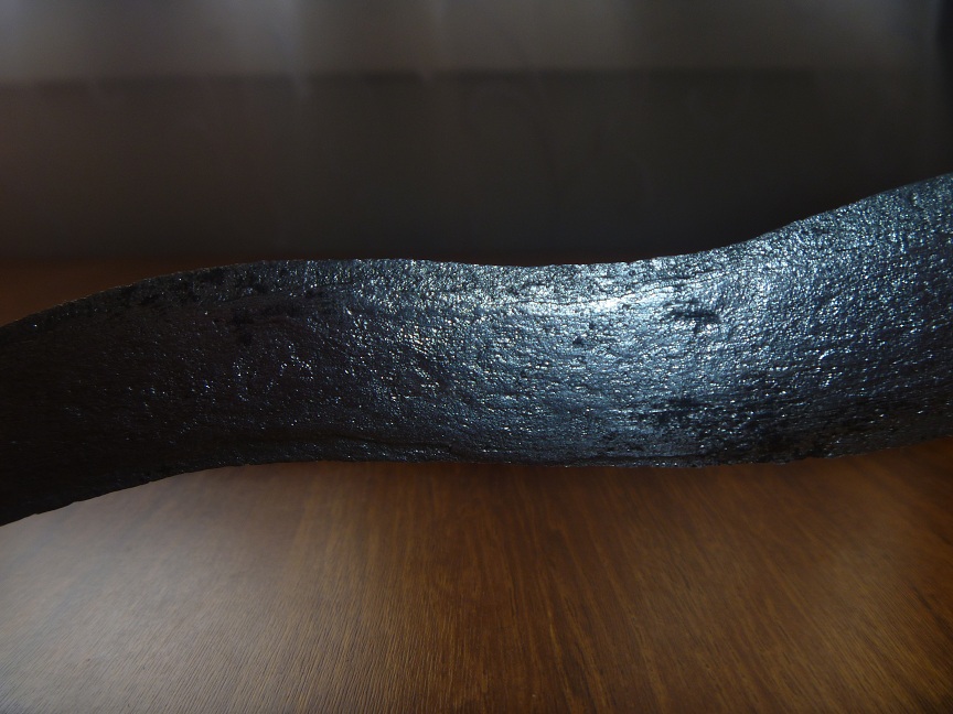

Fheng
Join Date: Sep 2012
Location: New Zealand
Posts: 14

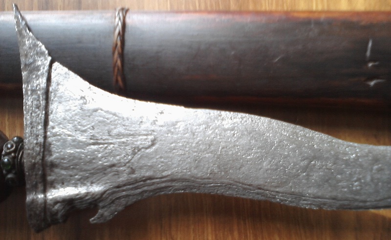

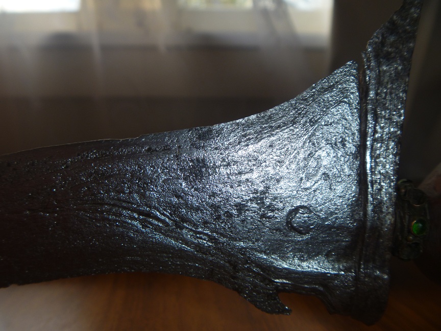

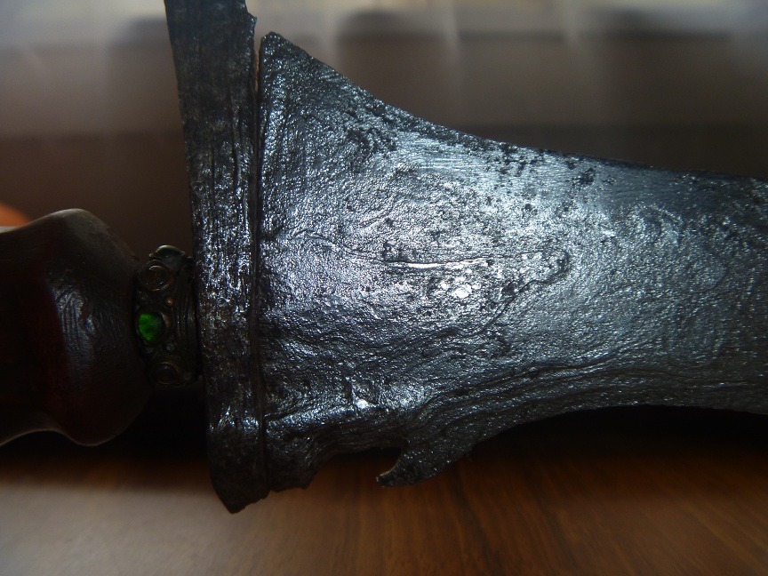

Default More pictures
1 of 2
Fheng is offline   Reply With Quote

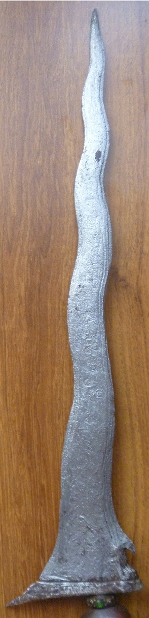

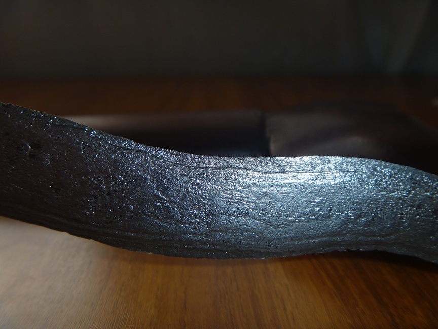

Old 30th September 2012, 12:20 PM   #20
Fheng
Join Date: Sep 2012
Posts: 14
2 of 2

Hello Sajen,
Thank you for the very interesting pictures and thread, it is clear that the Sumbawa kris is an extremely complex and fascinating subject yet to be studied!
Regarding the kris from Fheng, I would still attribute the blade more probably to Sumbawa or another Bugis origin than to Lombok because of its size (350 mm)
Jean

Regarding the keris from Fheng I think it is difficult to come to a good conclusion without handling the blade and the removal of the staining make it yet more difficult.

Perhaps Jean, but what limited resources that i have found always seem to refer to the materials used in Sumbawa keris as being somewhat inferior and bearing a course, sand-like texture. The texture of Fheng's keris seems to be rather smooth...

Sorry I did not see the latest pictures from Fheng before writing my latest post and I agree that the origin of this blade remains uncertain.
Regarding the sand-like texture of the Sumbawa blades, I am of the opinion that this is not by far an universal aspect, you can refer to "Hartadi keris Lombok" site for instance which shows several krisses found in Sumbawa which do not meet at all this specification.
It seems to me that the krisses from Sumbawa are found in various qualities and specifications (dapur, pamor, iron, etc). It is possible that some blades were imported from Sulawesi or Lombok (or made by smiths coming from these islands), and that the pieces with sand-like texture and no pamor (tangguh Kupang) were produced by local smiths with inferior materials. Furthermore it is likely that the krisses from the Mbojo and Sumawa ethnic groups are different since they had little contacts, anybody could confirm?
Jean
