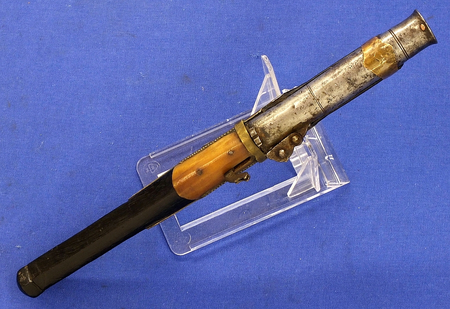

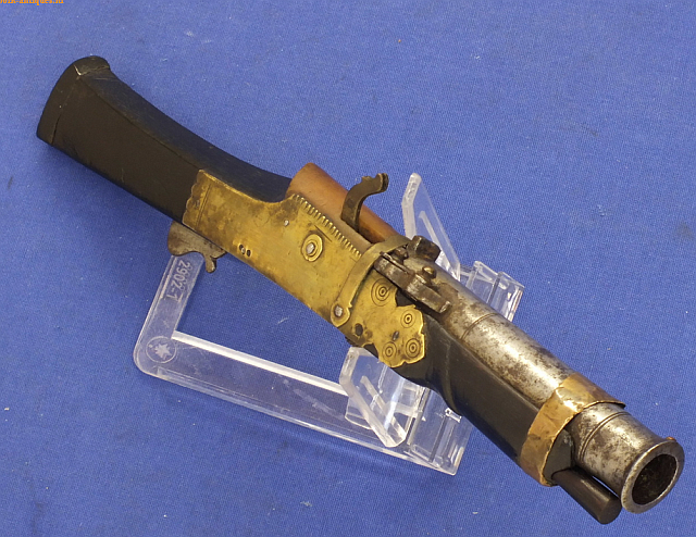

I am trying to get some help identifying what part of the world this small matchlock may have come from. The owner says it is about 24cm long but has no clue as to were it may have been made. To me it has the look of some matchlock rifles from India that I have seen, any thoughts?
Old 19th July 2012, 04:53 PM   #2
trenchwarfare
trenchwarfare's Avatar
Join Date: Oct 2008
Posts: 385
It is in the Indo-Persian "Torador" style. Have never seen one this small before. Very cool!

Atlantia
Atlantia's Avatar
Join Date: Jun 2008
Location: The Sharp end
Posts: 2,928
Yup it's an Indian Torador of usual form, just really really small.

I wouldn't call it a pistol because it has a stock not a grip. I'd liken it to the coach guns and the like.
I've had a small 'carbine' Torador before and I've seen very 'slightly' proportioned small ones described as for children.

Hi Estcrh. That is a very cool gun. As others mentioned, Indian Toridor for sure. And, not cut down. This gun was made this short. Yes, more a coach style gun than a pistol. This is the first and only one I have ever seen. A very unusual and interesting piece. Wish I owned it. Rick.

Hate to be argumentative guys, but at 24CM/9 1/2", I think this would be considered a pistol. Many pistols, don't have pronounced curves to the stock. Also, carbines can be fired from the shoulder.

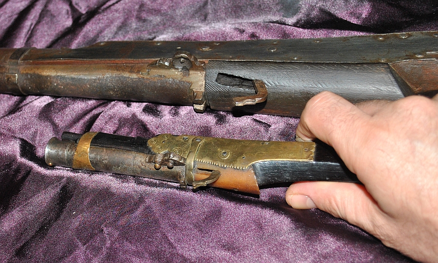

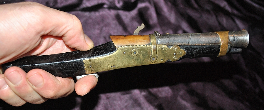

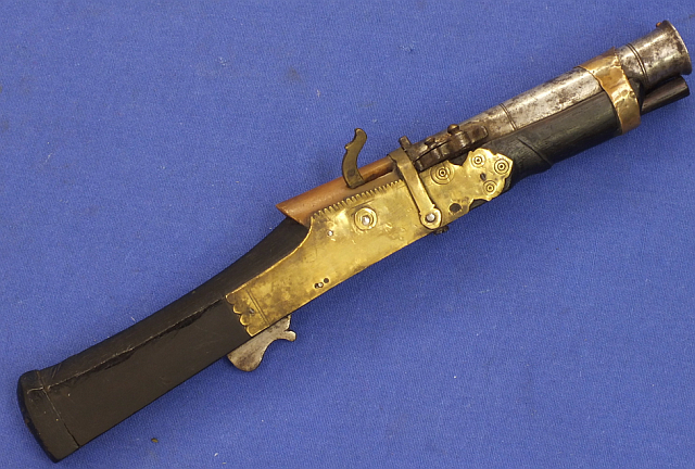

Well I have given up trying to find anything like this, I cant believe it is the only one in the world, there must be others in collections etc. Since it is so rare I got some additional images and the exact measurements, it is supposedly 17th century but I am not sure how this is determined, length 25cm/9.8in, caliber 14 mm/0.55 in.

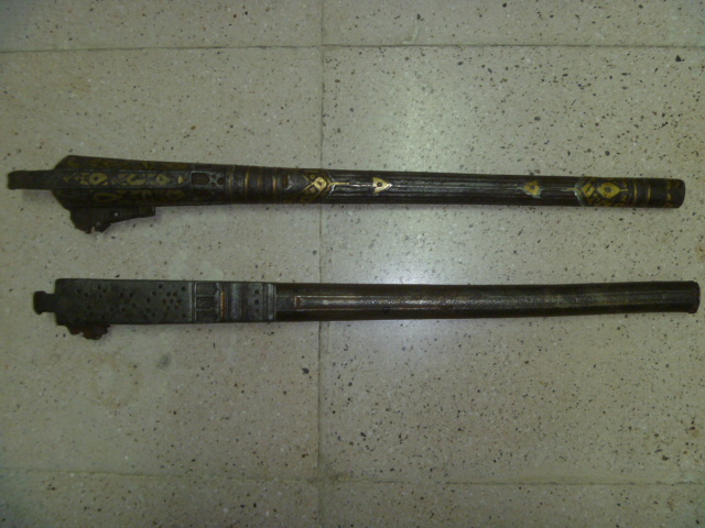

SALAAMS ALL~ Nice looking weapon. A lot of long barrels blew at the first weld caused by the use of too much gunpowder.(two shown below of the arab long barrel abu futtila type) I suspect that a number of these blown barrels were used as essentially "sawn off weapons" much in the same way that snapped swords were re used in Indian bladed weapons. I think the rear sight gives the game away and the butt which is a Torrador cut back. To me this seems to be a recycled cannon end with a re cut/ modified butt and a new foresight button. You would think that more of this design would be seen...

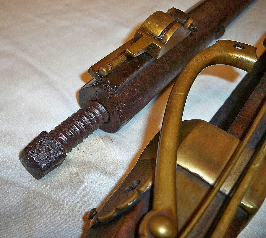

The breechplugs of Indian matchlocks are heat shrunk in. The plug is made to fit, the breech heated till it expands and the plug inserted, when the barrel cools the plug is fixed. No screw thread.
Toradors seem to have been made in all sizes, so I find nothing odd in a pistol sized one, and they seem to have always been in this profile as well. So I would say, unusual but not unique.
G.C.Stone illustrates a couple of Turkish and Persian "pistols" with this stock configuration, but with Miquelet locks rather than match.
I remember a reference from somewhere that these were fired from (butted against) the thigh on horseback, rather than with an extended arm like a western pistol.
Really only handling would tell whether it was born as a pistol or retrofitted from a damaged barrel....and the latter would still be in keeping with it being a genuine piece.

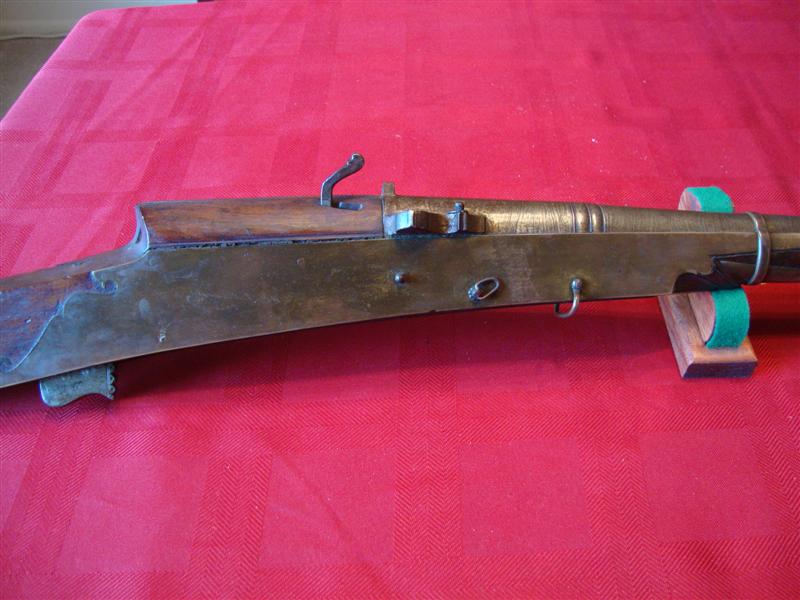

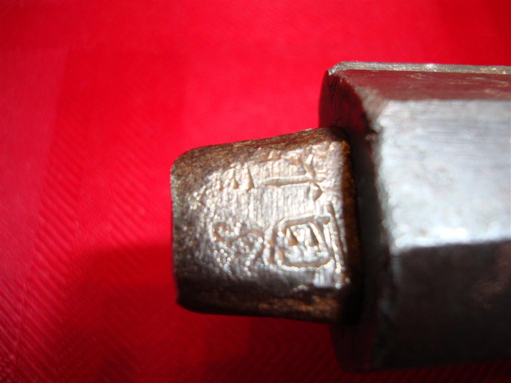

Hi Estcrh. I have looked everywhere to find photos of a Toridor barrel with the breech plug removed. No luck. Here's a photo of my Japanese Matchlock barrel with the breechplug removed. This is an original I shoot. But, I've never seen a Toridor barrel even removed from a gun to inspect the breech area. However, stay tuned, as I plan on removing the barrel from my Toridor to see the breech assembly. Like you, I have always been curious to see what the breech plug and the interior of the barrel look like at the breech end. I probably won't be able to do this till the end of the year. But I will take photos as I go along and Post on the Forum.
The Toridor "pistol" above still looks like it was made that way. It just does not look like a cut-down to me.
David: I have always felt the same as your comment about the breech plug installation, but never knew for sure. But, I believe you are correct. Since I plan on making mine a shooting gun, the sweated breech plug can be replaced with a threaded one I can have made. I need to make sure that the breech end of the barrel is straight with the rest of the bore and does not have what's called a "powder chamber" at the breech, similar to early medieval hand gonnes. Should be interesting. Rick.

David, thank for the info, I was not aware that they were not threaded like the Japanese matchlocks are. Supposedly the only part of the matchlocks acquired from the Portuguese that the Japanese had a problem replicating was the breech plugs, they had to wait a year for the Portuguese to return to Japan with a blacksmith who instructed the Japanese on the proper method of threading the barrel and bolt.

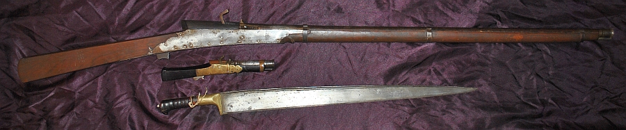

Rickystl, definitely post some pictures of your torador if you get a chance to take it apart. I have a couple of pictures of the torador pistol next to a full sized one, its seems that it was made as a pistol from what I can see.

The breech plug on your Japanese matchlock is identical to mine. Taking the barrel off a Japanese matchlock can be somewhat of a challenge. The whole gun is held together with pins. Not a single screw. Actually, very clever.
Now I'm convinced that the Toridor pistol was made that way. It's definately not a cut-down. In fact, it is very small. I was at the Antique Arms Show this past weekend in Hartford CT. There were some original Japenese matchlock pistols that were actually tiny, derringer size. I still believe these matchlock pistols - including the Toridor - were made primarily as status symbols. There would be no practical use for one. That said, this is still the first and only Indian variation I have ever seen. Very cool pistol.
Yes, I plan to take the barrel off my Toridor before the end of the year. It has brass barrel bands so should not be too difficult. Just have to be careful since the stocks of these guns were made in two or three pieces depending on length. I'll take photos as I dis-assemble. Should be interesting. Rick.
