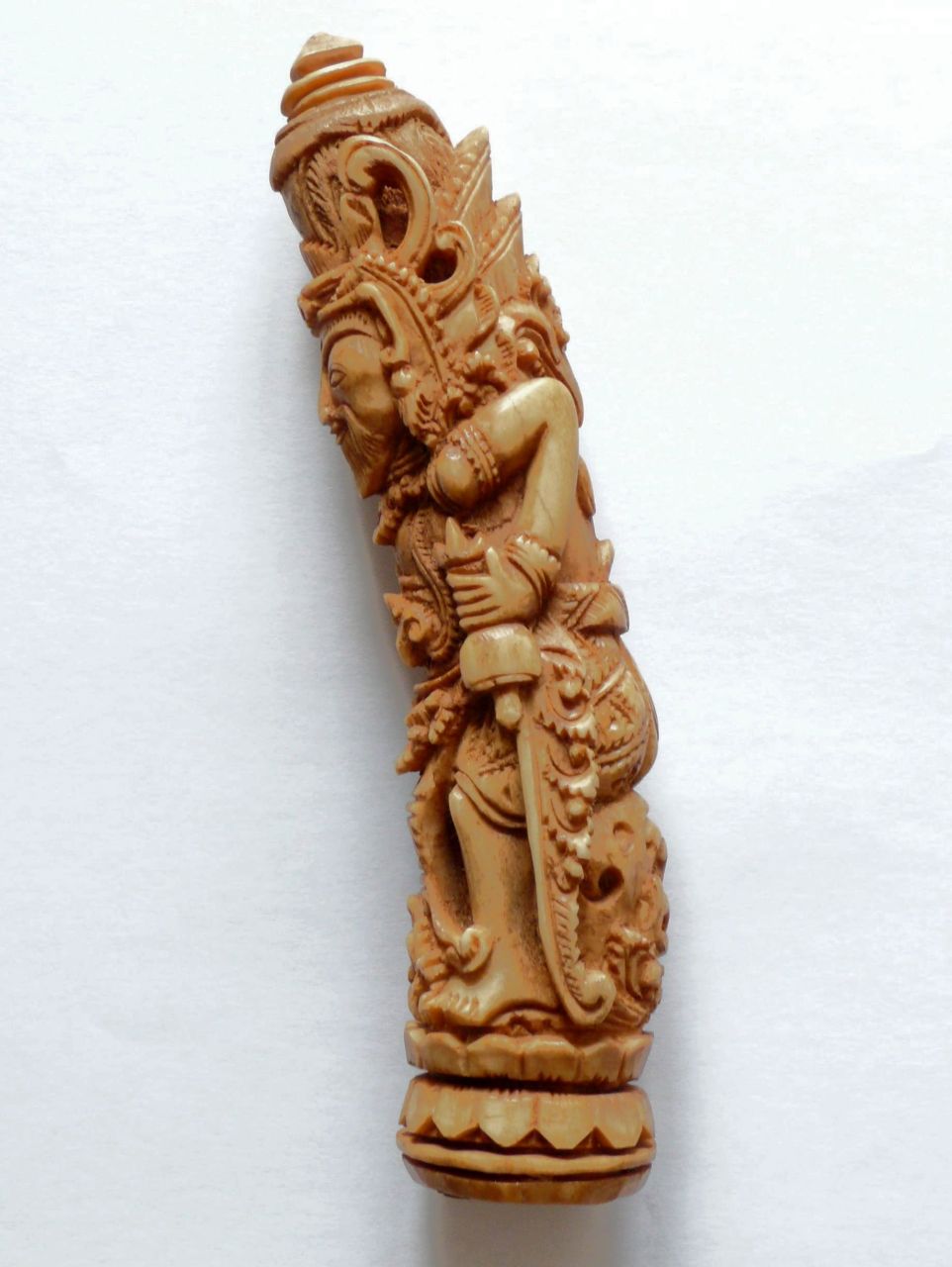

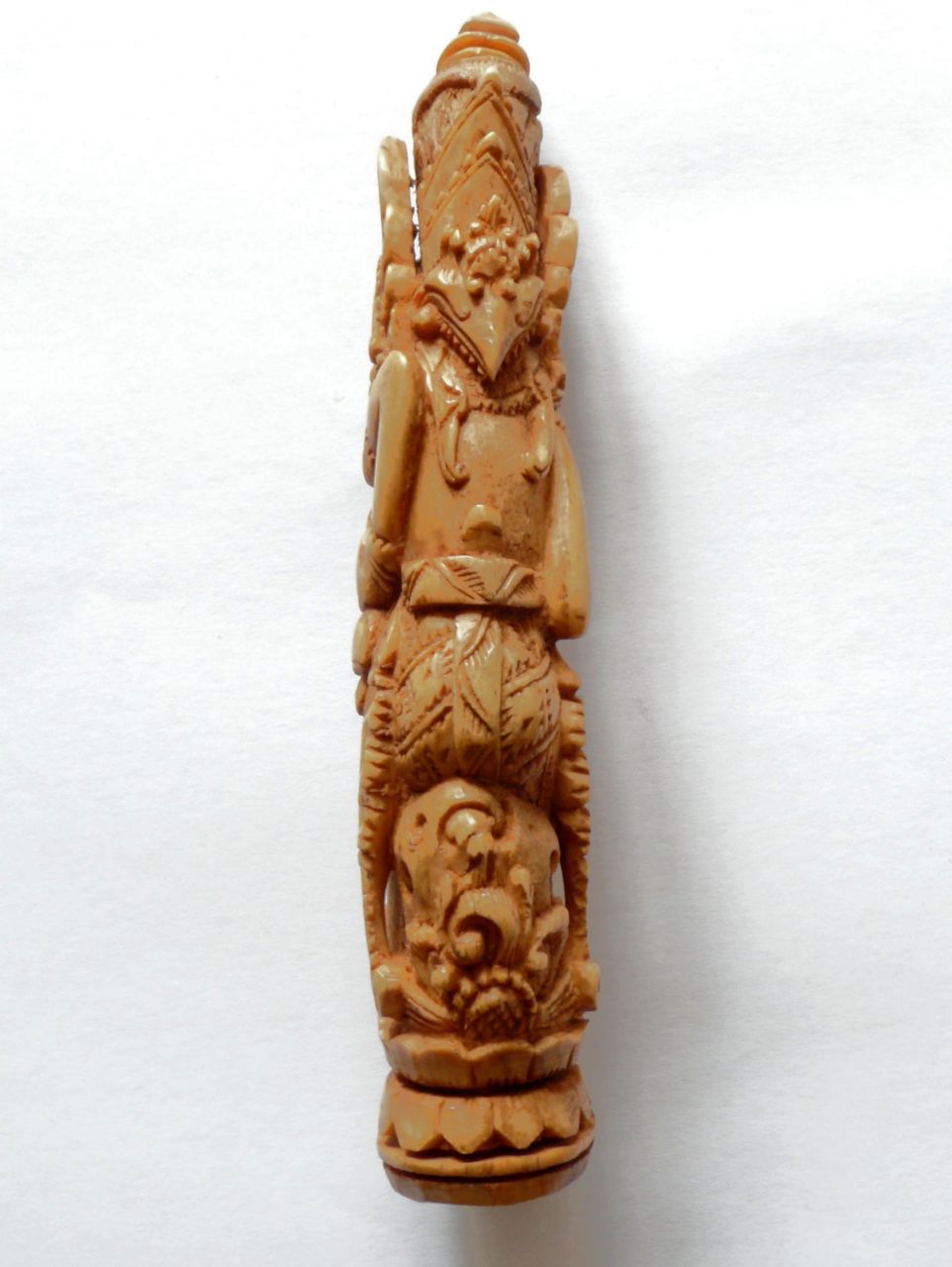

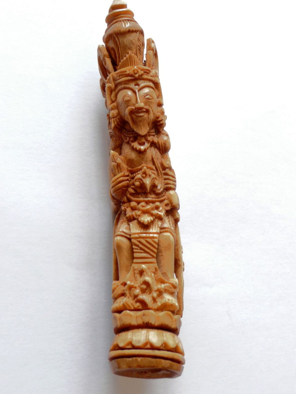

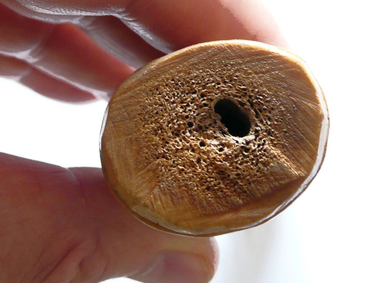

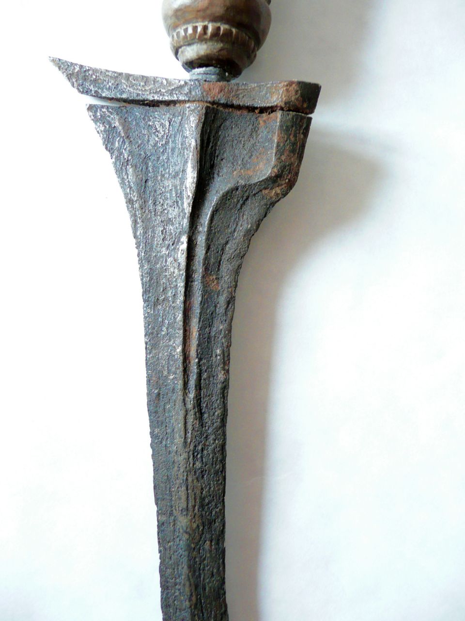

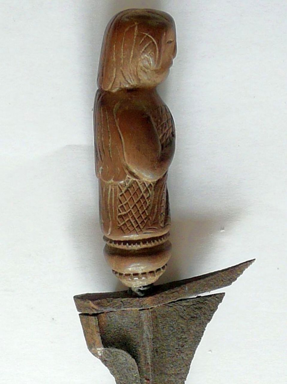

The bone hilt seems to be from Bali; not that old (post-WW2) and was never fitted on a keris.

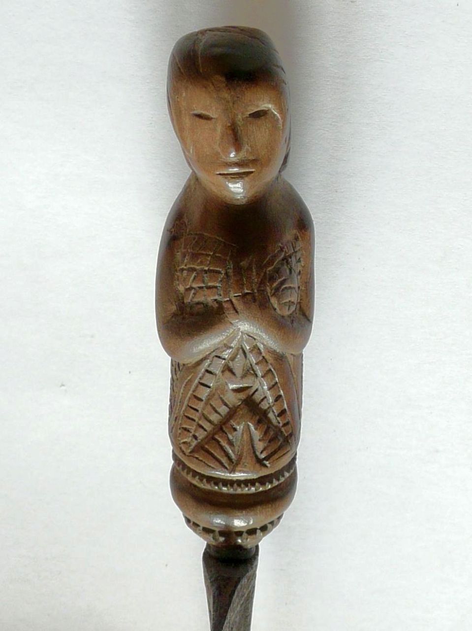

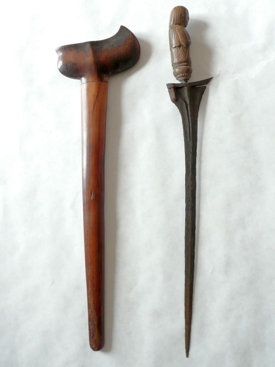

The keris as well as its fittings seem to be from Madura. The hilt does look village-made and post-WW2 to me; I'd guess that the blade is older but it's certainly wise to be cautious in the absence of safe indicators of age as suggested by Alan:

Regarding the blade, that is what Alan probably would call a ghost of a blade: there is merely a slorok left of it, with residual traces of pamor material.
Looking at how the blumbangan is made it was not so bad.
The following is of course naive, yet I always imagined, a Pusaka of common village people could look somehow like this (see also the last pictures in van Duurens publication of Gronemans book).
