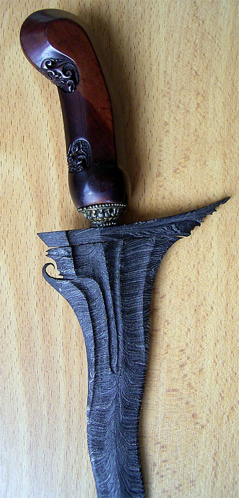

#1 |
Posts: 785

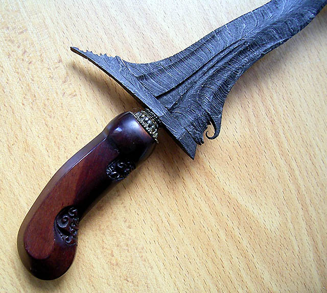

I bought this keris on Kassel Arms Show last November and try now to find out everything I can about it. The only obvious thing seems to be its origin (Java) and general type of Pamor (Miring). I would like to know more details about its blade and fittings, and also, maybe, its age. To me it looks quite old because the blade surface is very uneven and in reality looks like covered with thick hairs (the pictures do not show it very well). Thanks in advance.

Congratulations,
You have bought yourself a very nice central javanese keris, Surakarta region i think. The pamor is also called rongenduru and to some dutch authors very high in ranking. it is absolutly very very good. The whole keris is complete, probably late 19th century. Some authors would rate this as a kratonkeris. This means that it is worn by royal or high ranking persons. Im curious how the blade fits its sheath? The mendak is probably gilded. The pendok (metal oversheath) could be some kind of alloy, i cant tell what kind. |
#3 |
Location: Hamburg, Germany
Posts: 8
The exact origin of the fittings confuses me a bit - the sheath is a gayaman surakarta, but the handle looks Yogya style to me. Not really the most common combination. So at least one of these might have been changed once after production and first fittings.
#4 |
Location: Cincinnati, OH
Posts: 940
I would agree with Jan. The ukiran is definitely Yogyakarta while the wrongko is Surakarta. I would be interested in seeing a top shot to see how well the blade fits the sheath. The ukiran is a fine example, with pieced areas and well carved cecekan. Could be 19thC or early 20thC. Nice ricikan and well controlled pamor. I would stop short at saying this keris was worn by royalty (dressed a bit plain for that) or a high ranking kraton official without any provenance to that case, but all and all a very nice keris.
#5 |
Location: Kuala Lumpur
Posts: 369
Just to add, i think the pamor is blarak ngirid rather than ron genduru.
#6 |
Posts: 940
That was my first impression as well Rasdan.
#7 |
Location: Singapore
Posts: 1,180
Just to point what something potentially obvious -- this keris has a pretty well-done pudak setegal which adds to the 'sweetness' of the piece. Little things on the keris makes a huge difference in the overall aesthetics.

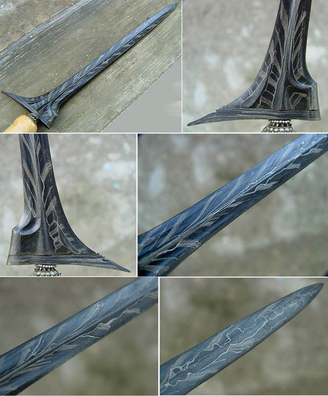

#9 |

Just to add to the confusion of origins, i might suggest that the wilah itself isn't Javanese at all, but perhaps Maduran. The pendok looks like mamas to me.
Sorry Kai Wee, but you lost me with the terminology. Is pudak setegal a peninsula term?

it seems its necesary to made a comment because there is nothing to congratulate on this blade, even I´m contrary of all my fellow forumites and all yelling on me. First I´m sure this is an new or let`s say not more then 5 years old blade of typical Maduran origin and not the work of an Empu but a Pande. Important to say is: blades with a pamor miring without a slorok (steelcore) are always in danger of breaking. Especially if the iron used is a modern material and this is the case for blades like this. The reason is the smith starts with 11 layers of 1 to 2 mm thick iron plates and 10 layers of nickle plated rim stripes of a thickness of about 1 mm. In two welding the result is 20 layers of pamor. From one welded staff sometimes the make two keris blades. So you save time and material (charcoal is expensive) and labour expences. Its an economical calculation because ther are many Pandes in Madura and every Pande is under pressure of his colleagues. Note: 1. the strong etching, typical for new Maduran blades 2. the very thin pamorlayers (made of rims with some microns of nickle on the surface) 3. the greneng looking weared off, but made for looking old (here comes the question of faking again) 4. If you looking closer you still see the marks of chisels (in the tikel alis and pejetan) 5. the angle between the centerline (straight line from tip to tumpengan or bungkul, not the ada ada) and the ganja. To stiff (typical for Madura) 6. the direction of the handle or better of the pesi (typical for Madura) 7. the outer ridges of the sogokan and tikel alis are to sharp for an old blade. 8. the form of buntut is also strange. All togther this has nothing and really nothing to do with any kraton (maby this blade has been closest to palace in the shops of the alun alun, there are things like this sold also in wellknown electronical auctions. This might be the only connection to any palace. With the aestethics of a kerisblade has this also nothing to do. In my eyes this are is no pudak sategal but only lis-lisan because I see the lis-lisan continue from the connection of the blade and ganja further the normal for the pudak sategal. This are not weared off pudak sategal. There do exist special pudak sategal which has no thorn out of the sharpness but their name I have not present at the moment. I think its useless to discuss the handle or sheet because the are objects of changes by the owner or dealer many times. They could be old which is not uncommon. I`m sorry if I do not meet what you have expected but as an eyewitness who has studied on the spot may tell the truths even it hurts. Empu kumis |
#11 |
Posts: 6,433
Empu Kumis has brought this subject up .
I got the initial impression of 'new' about this blade myself , and have had it since I first saw the pictures . I can't speak to the rest of the dress . I believe the pendok may be white brass / German silver, I have a similar example , it is fairly heavy gauge material and tends toward yellow in color when left unpolished . |
#12 |
Posts: 940
I am inclined to follow Empu Kumis' lead here. Even though i was willing to concede to an earlier 20thC date as this type of keris has been made in Madura since at least then, i believe E.K.'s expertise in this matter is certainly far greater than mine. I thank you for your detailed explanation as to why you date this keris as you do. This is just the type of information that is often lacking in people's assessments and is crucial to our understanding and learning of this very complex subject.
All other terms are clear to me, but i am still not quite clear on pudak sategal. BTW, i understand E.K. holds keris to a very high standard. I still think this is a nice keris, it is just not a kraton piece.
#13 |
Posts: 6,433
Agreed !
Very well executed work . |
#14 |
Posts: 125
Thank you Empu Kumis for once again teaching us all on the subject of Javanese blades.
Just to add - the garap of this piece is only average in my opinion and while the pamor is above average for a tangguh Madura Muda piece it is not exceptional. The quality of newly produced kerises has improved over the last 2 decades but it is still not as good as it had been. You will also notice that the keris is incorrectly dressed. The wrangka is gayaman Surakarta while the hilt is Yogyakarta. No offense to the owner intended. Its not a bad keris per-se, but its not a great one either. |

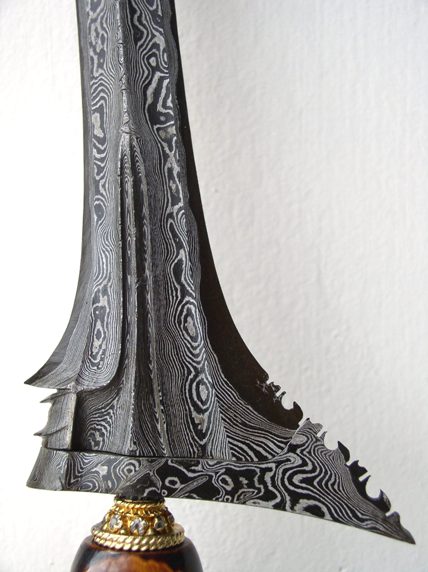

Posts: 14

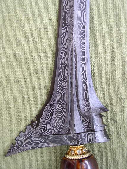

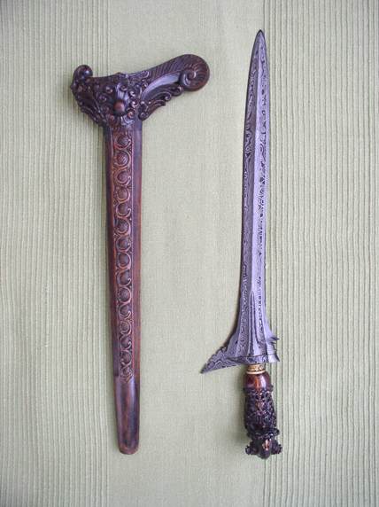

Hi all,
Hi Dave, What about this one? Newly made made from Madura. Overall the pamor looks good to me. Ria, |
#16 |
Posts: 125
Ria's keris is a better quality piece than the previous one but is still not a first rate piece.
If you want to know a bit more about why, I suggest you go back and read through the two magnum opus threads "What Constitutes a Good Keris." |

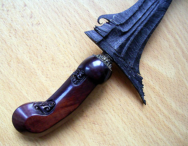

Thank you all very much for your input! I am glad that this subject have provoked such an interesting discussion. Now I would like to clear some points mentioned after I have looked closer on the Keris:
1. The mendak really looks like it was covered with some kind of let's say old and weared off gold, if you judge from the look, but not much of it left and it doesn't look bright. 2. The sheath probably belonged to the other blade before, because it was fitted with the pieces of wood in the corners, but this wood looks also quite old. 3. The etching is not as strong as it looks on most pictures - I have enhanced them all digitally. In reality it looks like the right picture in the first row, but even more subdued and not blueish but brownish. For the example of the picture directly from the camera look below. 4. There seems to be a steelcore, at least it is visible at some places on the cuttting edge of the blade (you can also see it on the pictures). 5. I was not able to see any chiesel marks anywhere on the blade, also no such marks on the tikel alis and pejetan. The surface there is exactly the same as anywhere else: each nickel layer is much higher then iron layer between them and also sharp, the surface looks like a very coarse and deep file and is a hell to care for. I would like to say that it is not possible to have unseen chiesel marks on such kind of surface. The so called steelcore is also looks pitted and quite old. 6. The outer ridges of the sogokan and tikel alis are also not so sharp as they look on the pictures. Hope it clears something. Anyway, the keris can still be a new one that was very skillfully made looking old. It was NOT sold to me by dealer as an old, precious, expensive, kraton keris; it is just a keris whose looks I liked and then wanted to know more about it. I live also in Germany (Chemnitz) and can show the keris in person. |

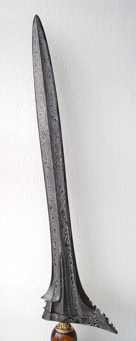

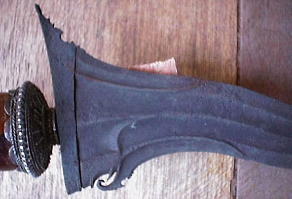

Btw, is this keris considered to have a pudak setegal? I know I have seen pudak setegal that sticks out of the profile, but what is the defining feature of a pudak setegal vs a lis-lisan? Thanks.
(Picture taken from previous thread) |

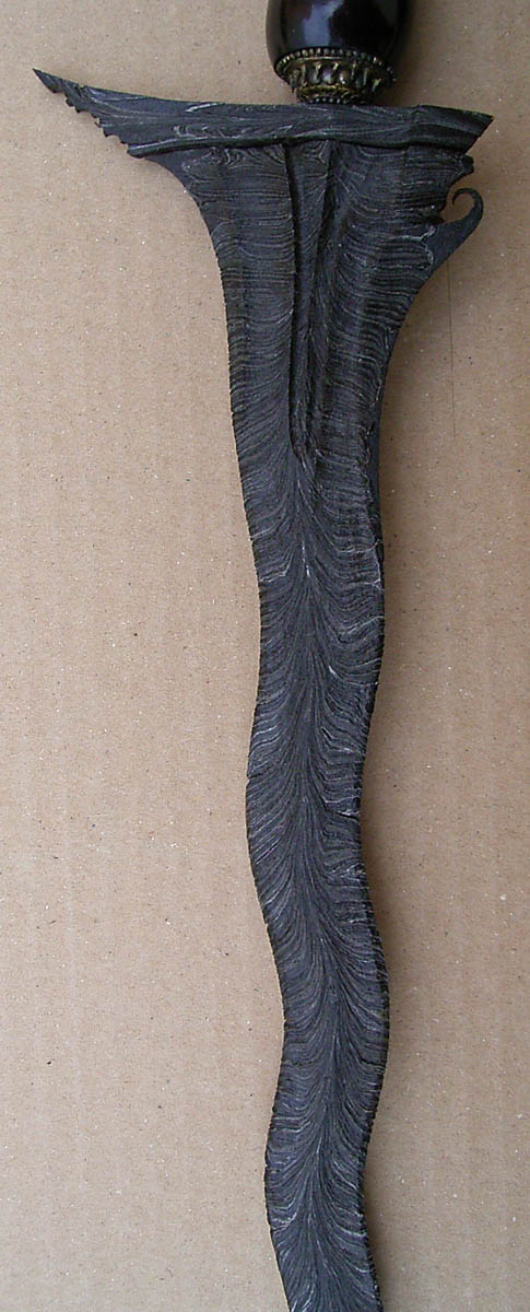

Posts: 13

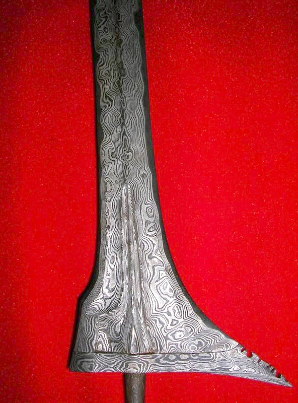

Just to share as a comparison, a recently made keris by Empu Jeno Harumbrodjo.
#27 |
Posts: 940
That is sweet!
Empu Djeno is one on the last true empus left. I don't know enough to know if he has been training his sons or anyone. He is getting on and years and won't be with us forever. Let us hope he passes his skill and knowledge on.

Ok, since we are talking about Madura Muda pieces, here's one more. They have their attractions, but the main problem with them is that they do not conform totally to traditions. Its like a hotch-potch keris pulling together bits and pieces from various origins and putting it together. Its like a stitched-together chimera. I suppose that puts off collectors with a more traditionalist preference. This piece for example, has a dapur with Solo origins (I believe), a Madurese gayaman sheath which was not originally made for it, but refitted well enough. The mendak is not Madurese in style, for sure. The ukiran is Madurese, and with some age, but this style is most commonly found on Madurese or E Javanese ladrang sheaths. There you have it -- the cons, but then, take a step back and look at the keris for what it is.
I think the present-day Madura smiths had been concentrating on pamor in the past. Only recently have they put in more efforts into the dapur. But still, their kerises have the 'stiff' look. Also, because time and money features heavily in their production, 'shortcuts' are taken, and they show, like pamor lines that can go broken half-way through the blade. With a traditionally-made keris, I believe this would not happen. And because time spent is limited, the smith does not have time to comtemplate the really minute details and lines that makes the keris truly graceful. But I think they are slowly picking it up. Who knows, maybe they are reading this forum right now and taking down all that we are saying.

Hi Kerislovers,
