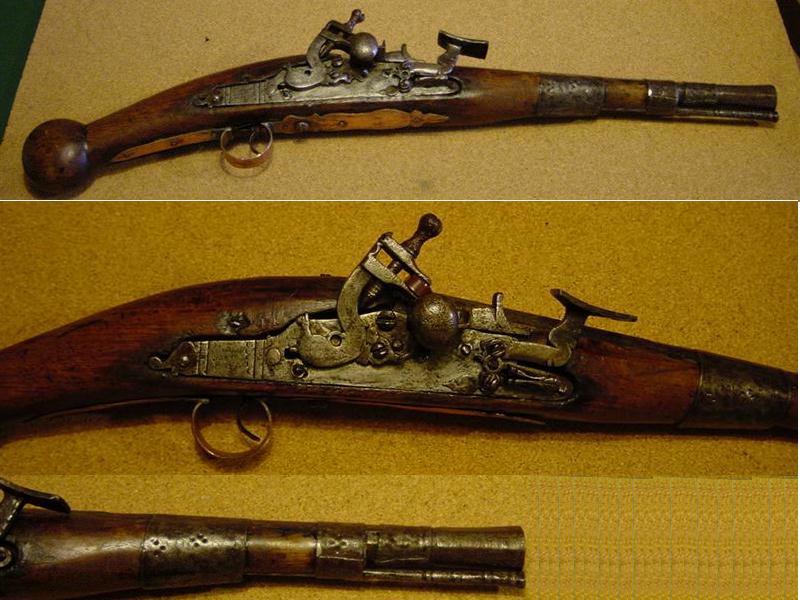

I bought this pistol in a street market ... no label and no ID.
The stock butt is very particular, but i don't know for sure where it comes from. I have been thinking it is Moroccan, possibly (wishfully) 19th century.
Any better oppinion or actual knowledge ?.

It is probably Moroccan. That type of snaphaunce lock is typical of that area (Algeria and regions to the east used "miquelet" locks of Spanish design, those characterized by a large external V-shaped mainspring and an "L" shaped combined pan cover and "steel". The snaphaunce of Morocco is derived from north European (Dutch and English) prototypes of the 17th cent.
The flare on the muzzle, and the almost circular outline of the trigger guard, are carried over from the familiar Moroccan long muskets, "moukahla".

Looking closely at the pistol, I'd guess that the lock and barrel are from an earlier piece, and this is a replacement stock. I say that because of the quality of the metalwork on the lock itself, and the poor fit of the inletting into the stock. What you can see of the barrel is alos of finer quality than the workmanship surrounding it. So even if the pistol is 20th cetnury (which I doubt), I think the odds are that the works are older, possibly much older.

Here are some more pictures of the barrel and other details.
You will notice the dark stains in the wood, around the screws and near the barrel. Would this mean this stock has seen some use, even having been a replacement to the original one ?

Those darkened holes around the bolt heads bring up an entirely different possibility. Given the reasonably good fit of the inletting around the barrel and tang (as revealed in the new pictures), it's probably the lock that is the replacement, not the stock. Those large holes are evidence that originally there were bolts with much larger heads inletted into the stock. The snaphance locks changed very little over their lifespan, so it's not surprising that a gunsmith was able to replace an earlier one with a new lock. Snaphance locks, while a significant improvement over the much more fragile wheellock mechanisms, are still needlessly complex, with something like three times as many moving parts as a true flintlock. Given the number of weapons being converted from snaphance to flintlock, the gunsmith might easily have had a spare lock lying around, making it cheaper to replace the old lock than to repair it. Given the evidence of the bolt head inlets along with the rough fit of the inletting around the lock, that would be my guess.

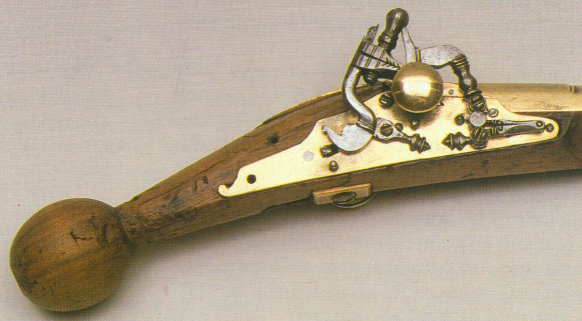

I am quite sure that your ball-butted or pear-shaped butt pistol (puffer) is of English origin, ca. 1600 to early 17th c., in its main parts.
The shape and decoration of the barrel tang and the fore end bands denote that they are later working-time alterations the decorations of which show some Oriental or Southern Euroean influence.
English pistols of the Late Renaissance period are extremely rare to find in unaltered condition.
I attach a similar but unaltered English specimen of a 'puffer', the trigger and guard missing, in the Doges Palace, Venice, and an image of another in an unknown collection.
For stylistic comparison, the one at the bottom is also English but of the Cromwellian period, ca. 1645, also in the Palazzo Ducale..

The barrel, apart from the tang, still is of characteristically English or Scottish multi-staged form but the whole pistol must have been sold to and altered for the South Eastern market, especially all its mounts; so Morocco seems quite a good guess.

Hi Fernando!! Can't believe I missed this Thread. Agree with you and others that this pistol is Moroccan. As mentioned, the stock style resembles an English "Puffer". The lock is typical Moroccan - copied in the English style. The barrel - ? All these varieties make this an interesting pistol. The Moroccan pistols are much less common than the long guns. Nice piece.
