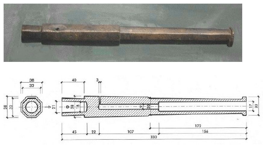

I hope, this will answer your question.
Roland

I have this plans and a lot of other but Unfortunately this pictures (top and bottom) contrary to each other. In addition the bottom picture is absolutely incorrect because it shows rear part conical although I know that it is a prism with parallel edges

Tanks for all who tried to help me. I've contacted with Germanischen Nationalmuseums, Nürnberg and got following answer:
Museum: "Dear Alexander, as the Tannenberg rifle is handmade, it isn't that easy to measure. The length differs between 318 and 320 mm, the diameter of the chamber between 15,9 up to 20 mm. The shape in general is cylindrical, but is has a partition in the middle. Please find a photo attached.
ВТ 19:39"
Spiridonov: "Thank You. So, As I understand the real shape inside hangonne is like on this picture variant A but not B"
Museum: "Yes, the shape inside the Tannenberg handgonne is closer to version A than version B. "

The design of the chamber in picture "B" is definitely wrong and has already been contradicted in an article from the museum in the early 20th century. They´ve done a new 3D-computer-analysis of the barrel a few years ago, but unfortunatelly the results have not been published until now.
