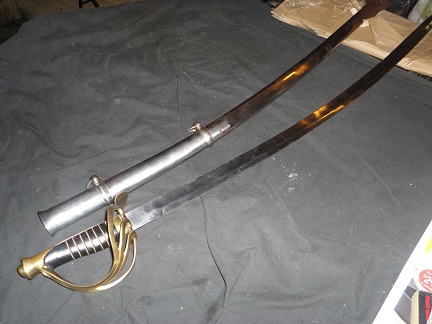

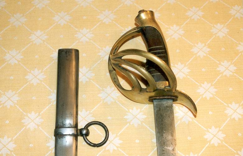

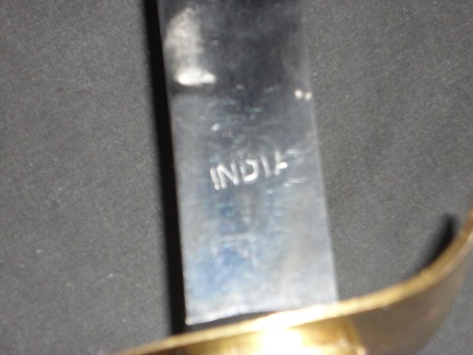

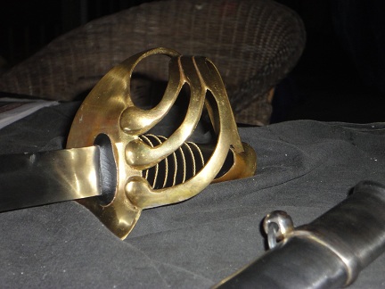

I thought I would ask if this is a (reproduced) Light Cavalry sabre, pattern 1840. I purchased this sword, only knowing it is a reproduction built before 1990. Besides that, I know very little about it. After some research, the closest sword this resembles appears to be the pattern 1840 sabre. It would appear obvious that this was made in India, but by who and where? (The only mark is the 'India' on the blade; shown in pic) I wonder if that is even possible to tell on a reproduction. The sword feels like its well-made and 'combat ready' but how can one really tell? I am almost certain it’s not stainless steel, and it appears like it would have been quite sharp in its day. Sorry for posting a reproduction, but I am using this sabre to learn about its historical counterpart and the fact some reproductions are more collectable than others. Regards.
In any case I love the design and I am currently searching for a genuine pattern 1840!
Here are some pics of three sabres; the Indian made sword (top) and what I believe is a genuine pattern 1840 (bottom) and a similar US cavalry sabre (middle):

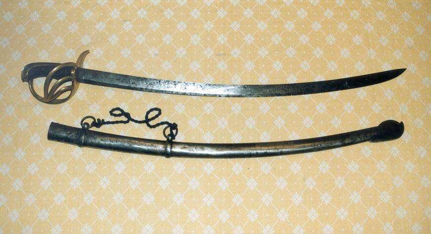

As has been pointed out, on these forums we focus on genuine historical weapons though we do occasionally see reproductions which are crafted quite faithfully to the originals. These are typically heavily researched and our attention to the historical details of course coincides well.
As your inquiry was so courteously and thoughtfully placed it seemed clear that in this same light, your sincere interest in the actual weapons thought to be represented in these items made it seem that response was well warranted.
As you already know, these swords are reproductions, with the exception of the middle one which appears to be a European cavalry sabre of early to mid 19th century, the exact type unclear but perhaps Prussian.
The other two are reproductions of most likely French types of sabre, however they seem somewhat fancifully interpreted and as far as I know do not correspond with one particular form. Obviously made in India, these are commercially produced in areas of Rajasthan and it would be difficult to establish which commercial entity mass produces these, whether entirely or components alone.
The US M1840 was in fact a design taken from the French M1822 sabre, and the first examples were actually produced in Solingen for the US. These are readily found with dealers and in auctions with prices varied according to certain details among them, some can be reasonably priced while there are rarer examples, which fetch remarkable prices. I would suggest contacting one of us privately for further details if you do seek a genuine M1840, and we will be glad to help. These have outstanding history, and we would be delighted to see one on these pages!
Attached is genuine "old wristbreaker".
