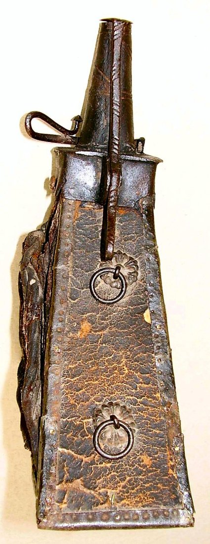

Default Info on this powder flask

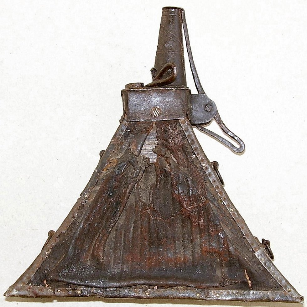

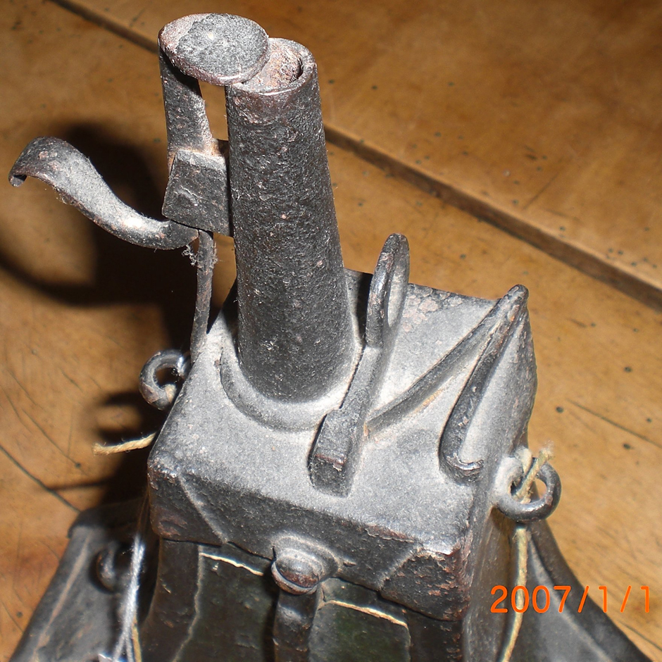

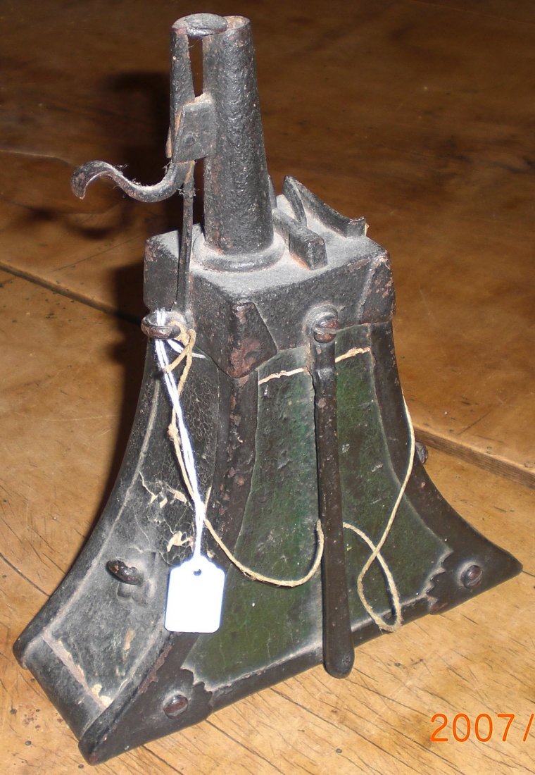

What about this other powder flask (origin, date) ?
Its length is 26 cm.
Thanks,
jm

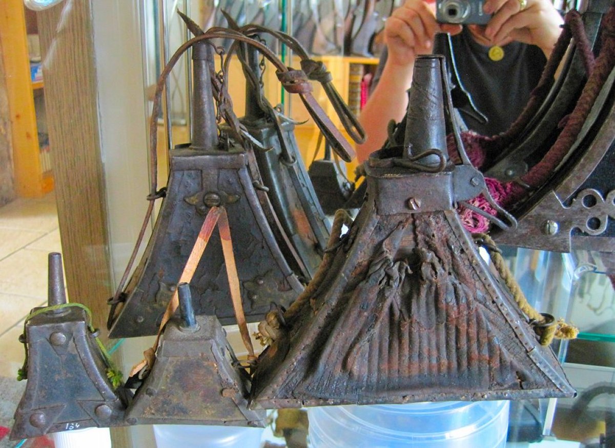

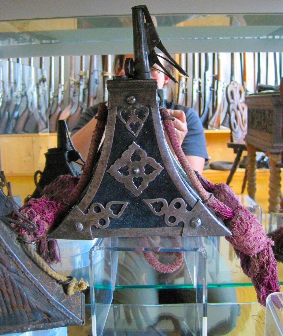

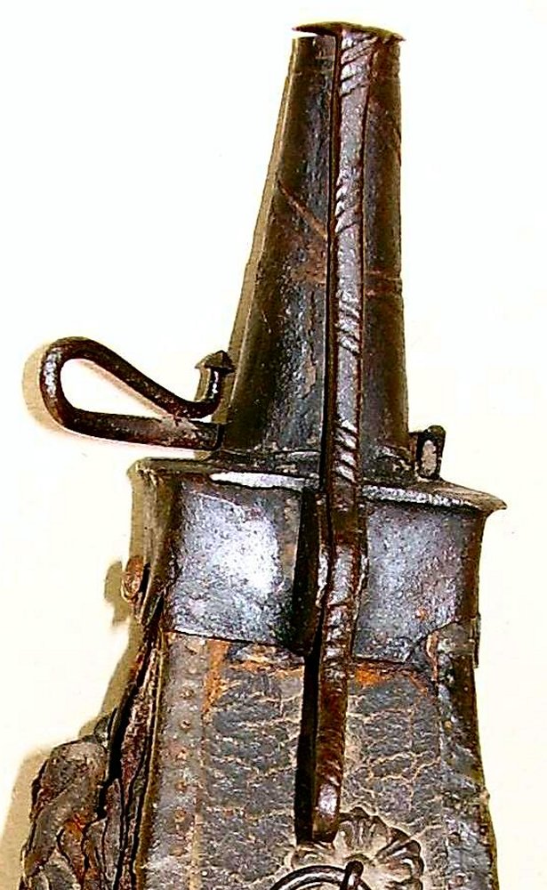

Hello, Jean-Marc,
I noticed this flask about two years ago at Armes d'Antan, a French dealer's site, and date it 'ca. 1580-1600', possibly of German (Nuremberg) make.
Well done though it was not exactly cheap!
This is a specimen of a commonly known type of triangular flasks that are traditionally associated with musketeers' armament of the 1560's to the late 16th century. In contradiction to other experts' opinions, I am convinced that the production of triangular flasks largely stopped at the beginning of the 17th c. when only the bandolier continued to be in use. The largest deliveries are recorded to have taken place in 1577-8, from Nuremberg to the Graz armory. The only two known instances of period artwork depicting triangular flasks are by Stradanus, from the 1560's, top attachments, and from 1585-87, by Hendrik Goltzius (following); both artisans showed the flasks attached with the belt hook to the back of the belt of a 1570's musketeer still equipped with an early petronel type of musket (see attachments).
The body is composed of thin pinewood or beechwood boards glued together with bone glue and covered with corduan leather. Other Nuremberg flasks were covered with wool velvet. The egeds are reinforced with pieces of tinned iron put in losely and easy to detach once the top mount has been taken off. The latter, if preserved completely original, must retain its long copper-soldered nozzle with either a small detachable lid fixed to a delicate chain, or, as is the case with your flask, with a spring-loaded lid with long handle, plus a spring-loaded horziontal cut-off for portioning the amount of powder to fill to nozzle.
This is a finely preserved exmaple fitted on the reverse with an unusually long belt hook.

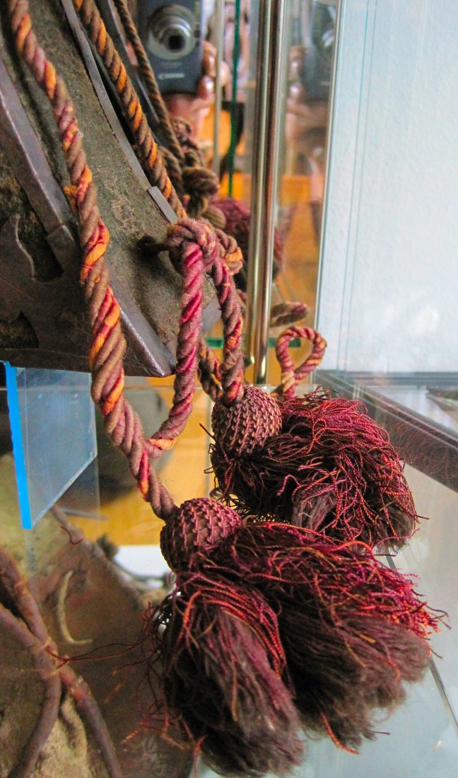

Originally, a cord with tassels of wood and solk were attached to the rings which are in most cases missing today. When they are retained in their full pristine colored glory, as is the case with some of my pieces, the price amounts to three or four time that of a 'plain' flask.

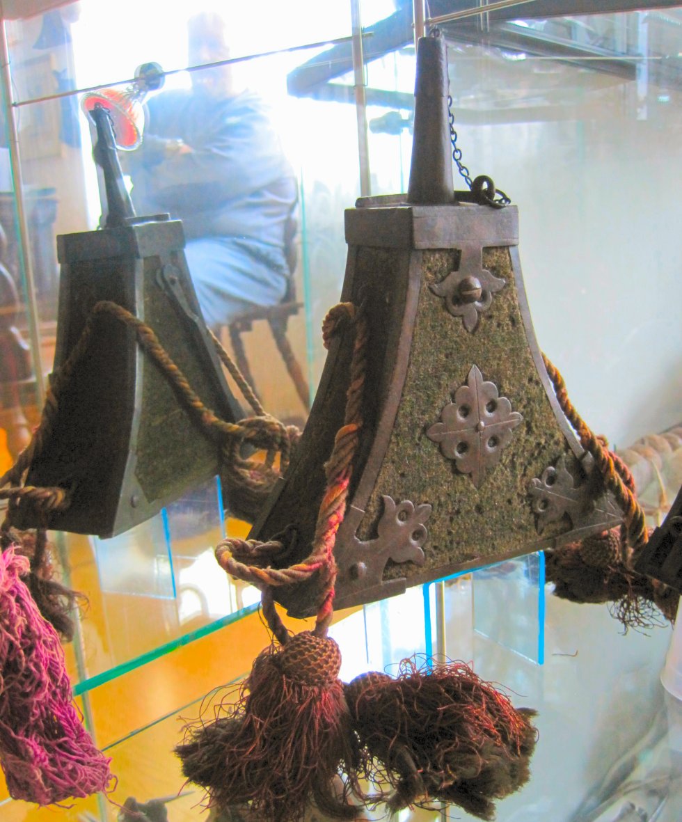

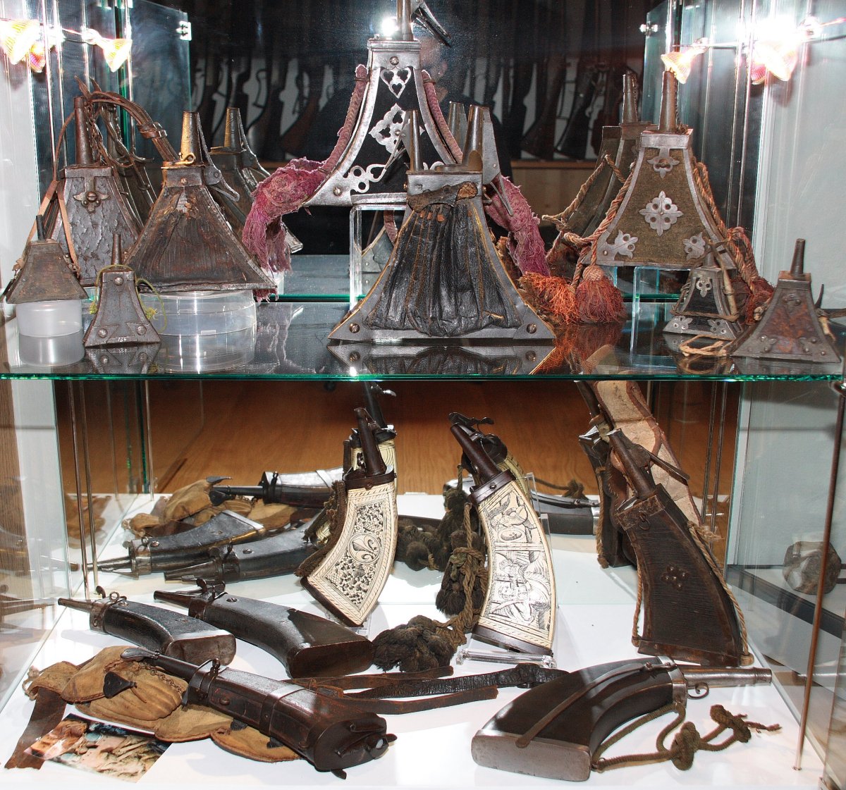

I attach photos of similar flasks in my collection; the first an unusually fine and large specimen, Nuremberg, ca. 1580, the body covered with blue velvet, and retaining its original colored wool and silk tassels.

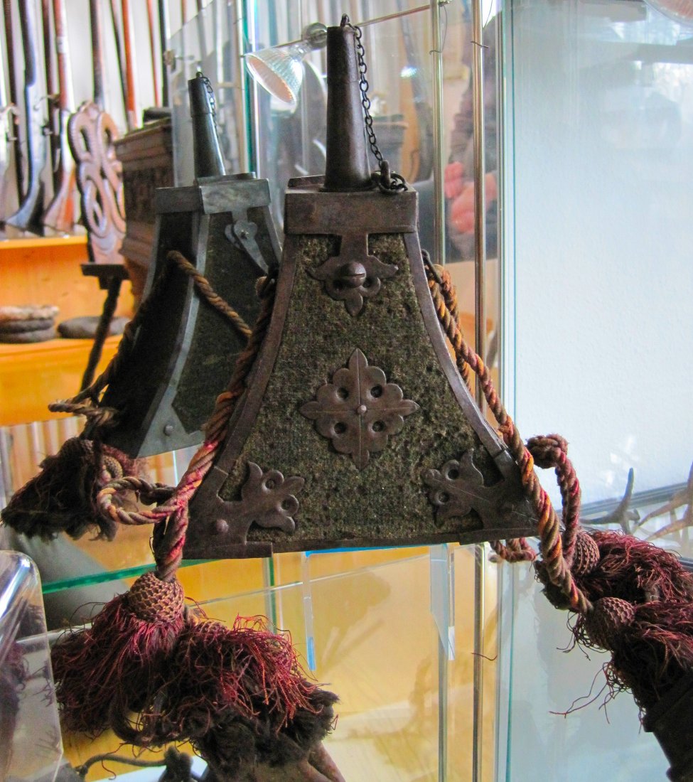

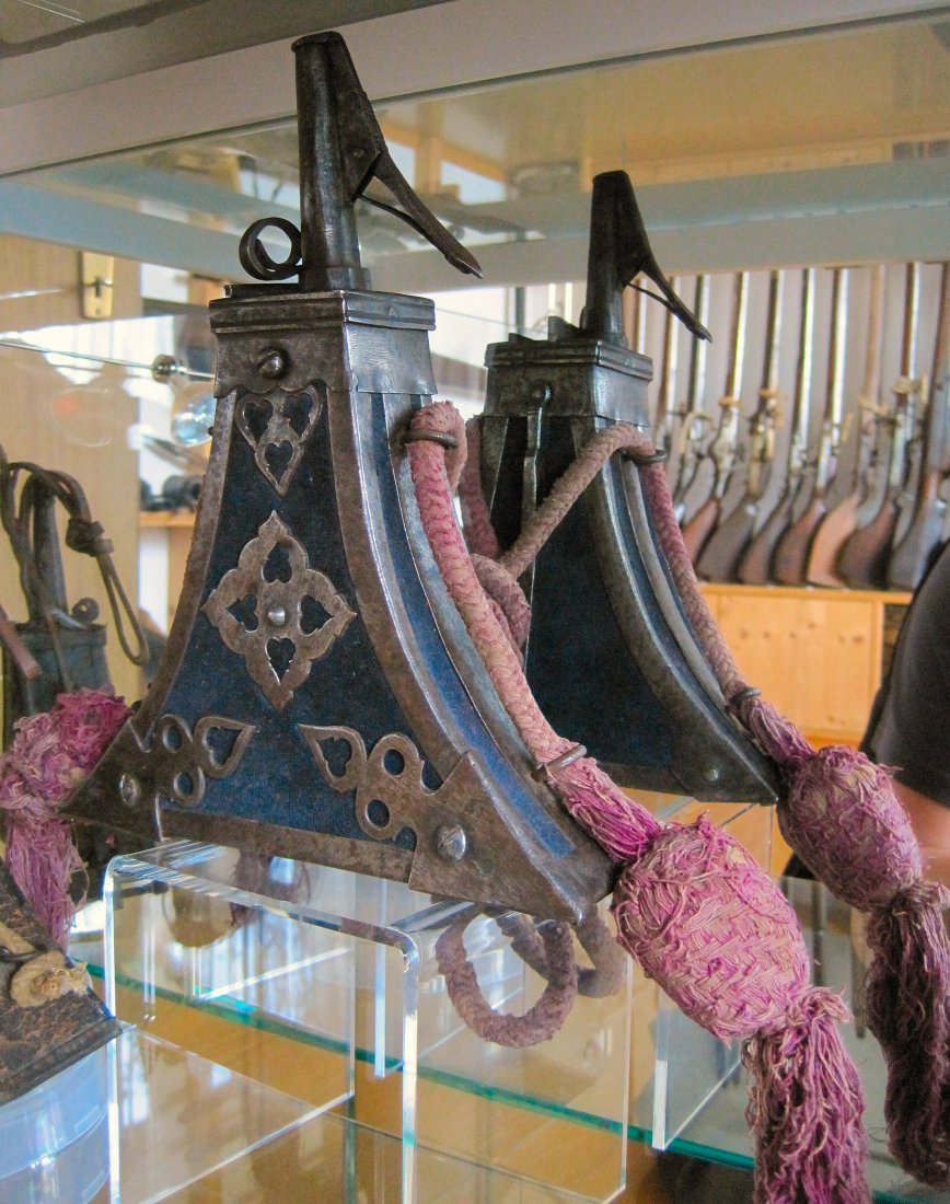

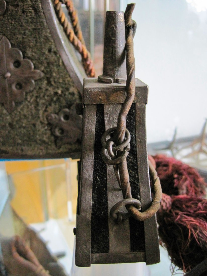

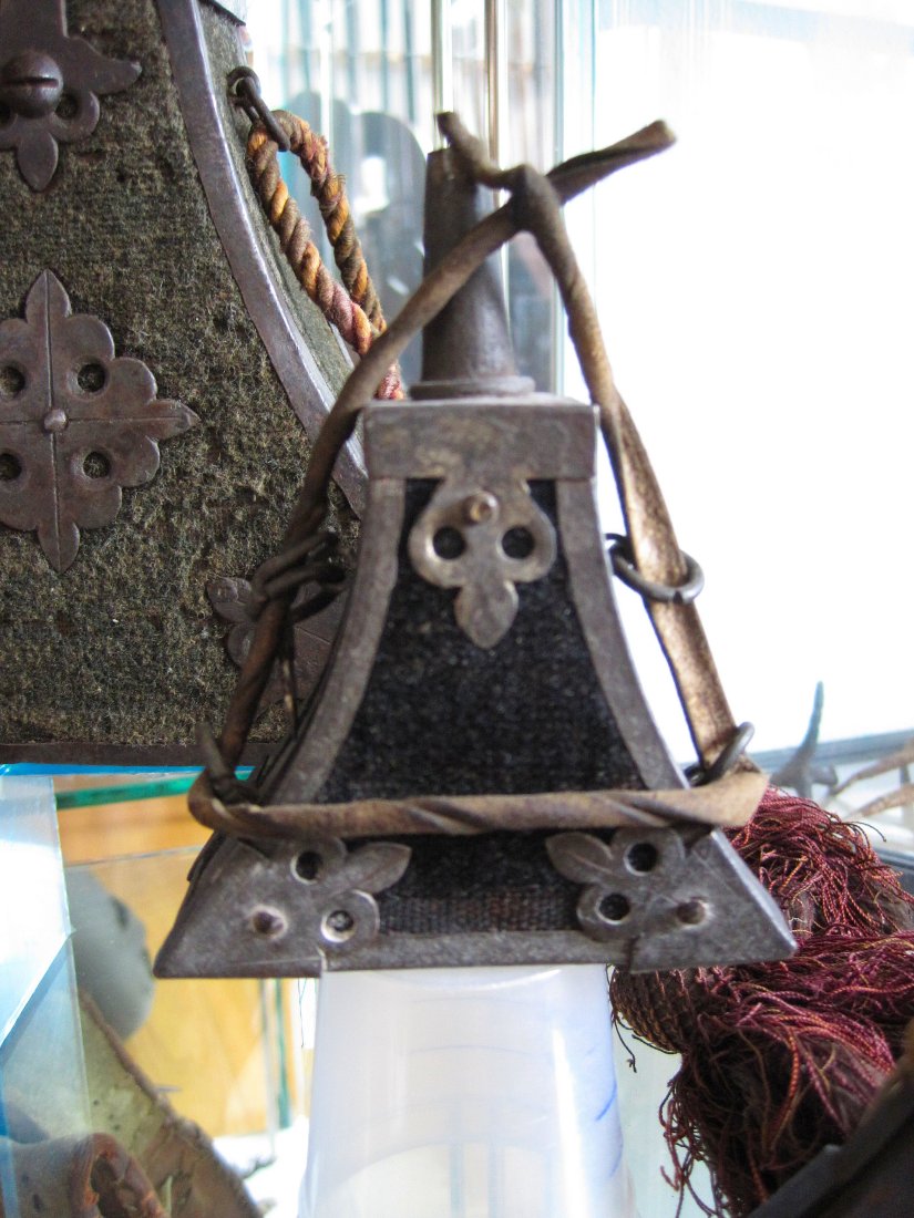

Another early musketeer's flask, Nuremberg, 1577-78, from one of the Graz deliveries, the body covered with green silk, the nozzle complete with its rare small top lid secured by a delicate chain, the side rings retaining their fine and original purple, yellow and green silk and wood tassels.

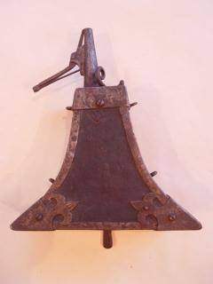

Next a contemporary and matching Nuremberg priming flask, 1577-78, the body covered with black silk, and retaining its original leather string.

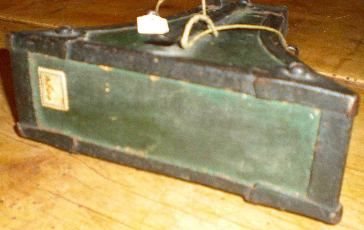

Following an extremely fine and rare Austrian musketeer's flask, ca. 1560-70, the body covered with paper (!) and painted green, the iron mounts originally painted red in the Late-Gothic tradition and overpainted in black in the 17th century, preserved in virtually 'untouched' condition, heaviliy patinated throughout.

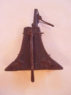

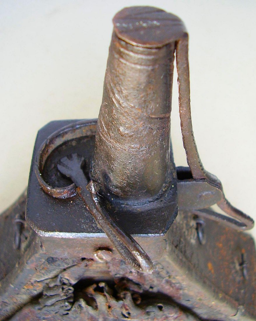

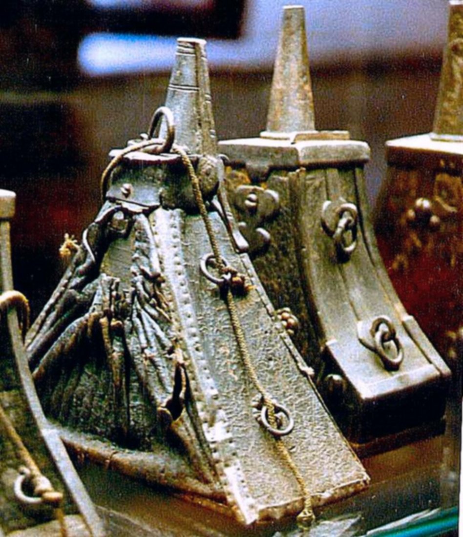

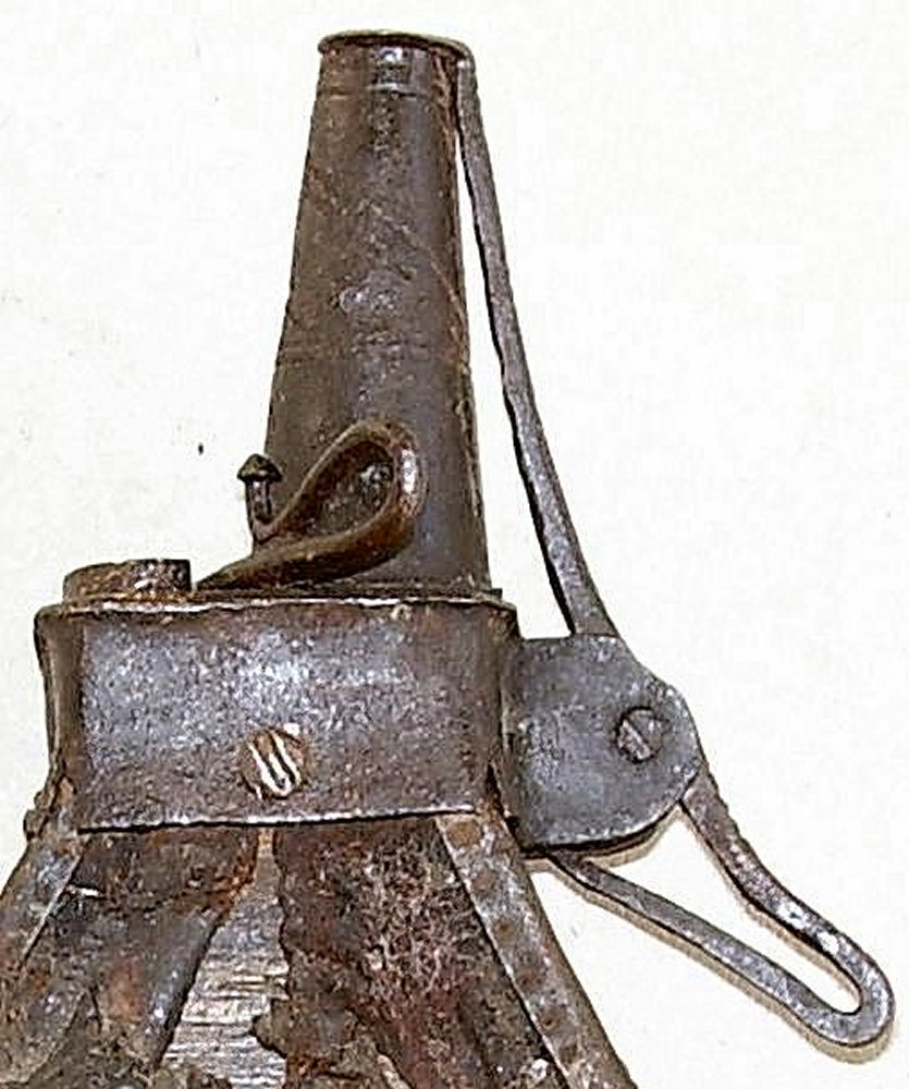

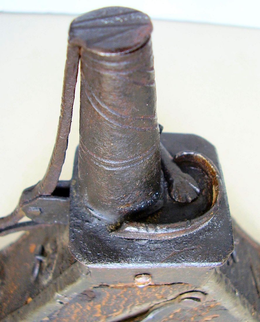

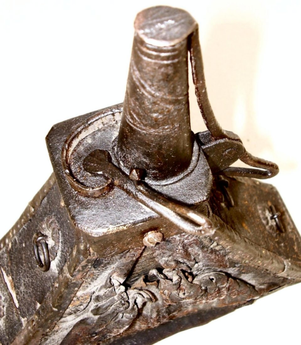

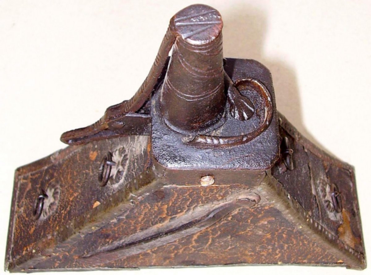

Here is the earliest known triangular type of flask known in private hands, ca. 1540, the body covered with brown corduan leather, the oberverse fitted with a folded leather pouch that is mostly called a 'ball' pouch. Actually it is much too delicate to ever have been able and hold balls; moreover, their weight would have made the very light flask turn over. I guess that this pouch, at a time when garments were not yet fitted with pockets, was meant to receive the small accouterments badly needed by any arquebusier to clean and maintain his arquebus, such as worms, scourers, wadding, etc.:
http://www.vikingsword.com/vb/showth...+accouterments
Engraved running around the nozzle is an early style of line decoration coresponding to barrels of the 1520's-30's, while the serpent shaped scrolled form of the horizontal cut-off exactly corresponds to the grips of pan covers of matchlock arquebuses of ca. 1525-40:
http://www.vikingsword.com/vb/showth...necht+arquebus
The spring loaded grip of the nozzle lid represents its earliest form, wrought integrally with the spring which features the wide and characteristically early bow reminding of the springs on sketches by Leonardo da Vinci and Martin Löffelholz, early 16th c.

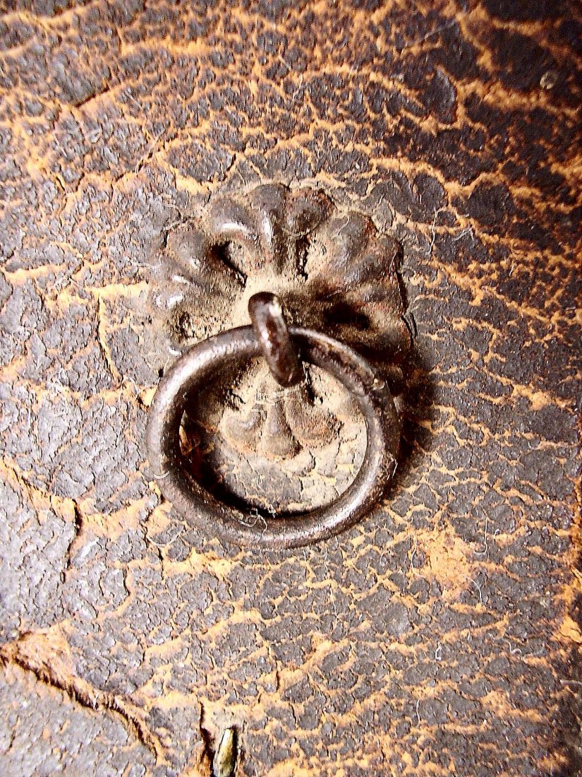

The edges are reinforced by finley nailed and etremely thin tinned iron fittings. The rounded and embossed washers of the side rings are in exactly the same style as decoration on the forestocks of two North Italian matchlock arquebuses of ca. 1540 in the Vienna colection. The belt hook on the reverse is mounted askew, which also is a very early criterion and does not show up on powder flasks after ca. 1560.
Attached to the rings is the original finely turned dark green cord.
This extremely rare type of earliest triangular flasks is first represented on a painting dated 1529, of the battle of Pavia, 1525:
http://www.vikingsword.com/vb/showth...t=pavia+heller

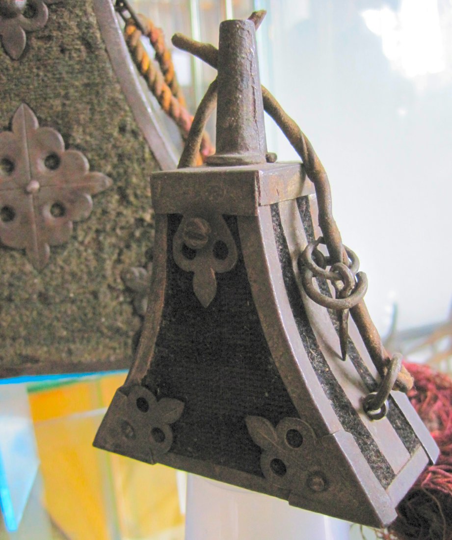

The only other four surviving examples are preserved in the collection of the former Munich Arsenal, which has been closed to the public for almost twenty years. When I was there I took the photo attached last.
Michael

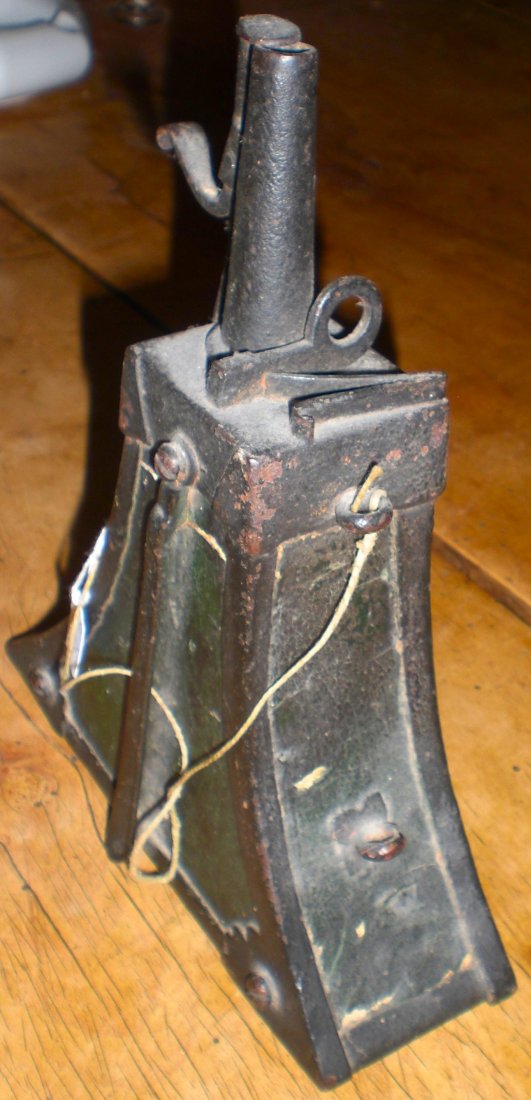

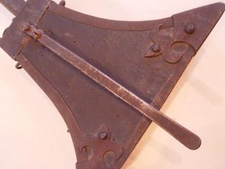

An Austrian musketeer's flask, ca. 1580, the body covered with thin leather, the photo showing the reverse with the belt hook.
One of the framing iron reinforcement parts can be seen sticking out loosely.
The top cap is missing from the nozzle.
Height 21.5 cm.
m
