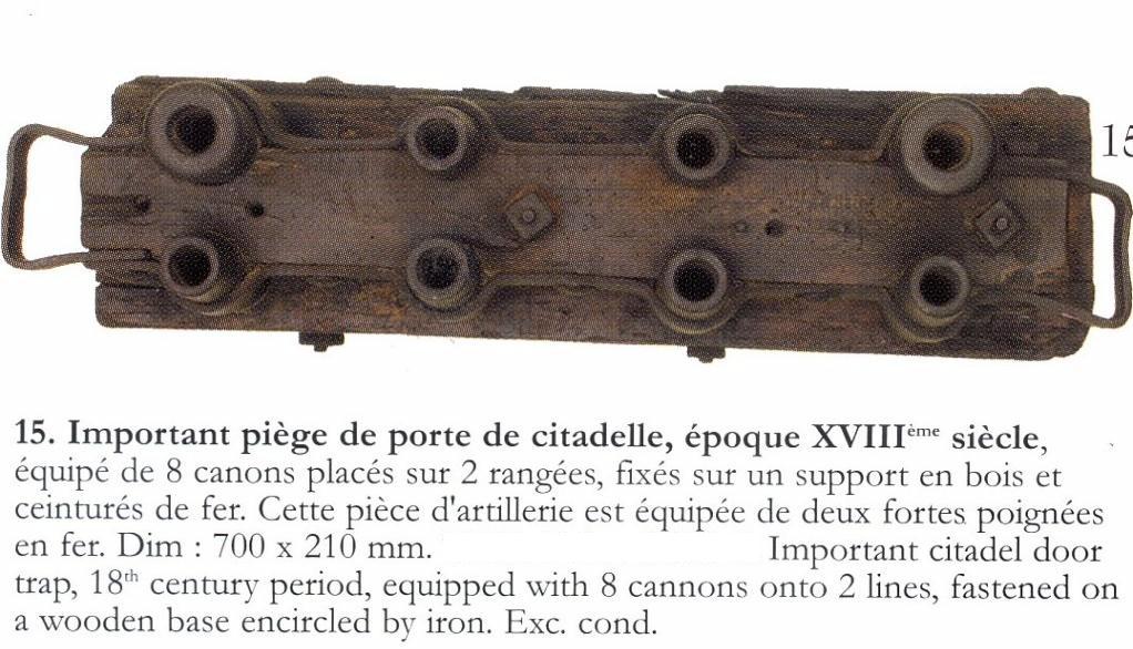

I think that is sound logic all around, however for the sake of argument (and I realize that most of these arguments tend to make things try to fit what we want them to be) at least 2 of the mounted mortars from Castelnaud are similarly ringed and half or 1/3 embedded in a stock or base.
I wish there were a good source for a timeline and progression for these things. I havent been able to find one.
For instance, are there similar examples out there of Castelnaud "baton a feu" type? FYI, I emailed them about that piece but I havent heard back.

I guess that it should be emphasided that the versatility of these things comprehended a vast menu. Just the other day i hear a local seller calling them 'canhões de porta' (door cannons).
This reminded me that long ago i was told by a certain expert that they were indeed used to blast the enemy when trying to brake in the castle gates during sieges.
I haven't yet seen setups similar to those from Castelnaud, although there are similar approaches out there.
