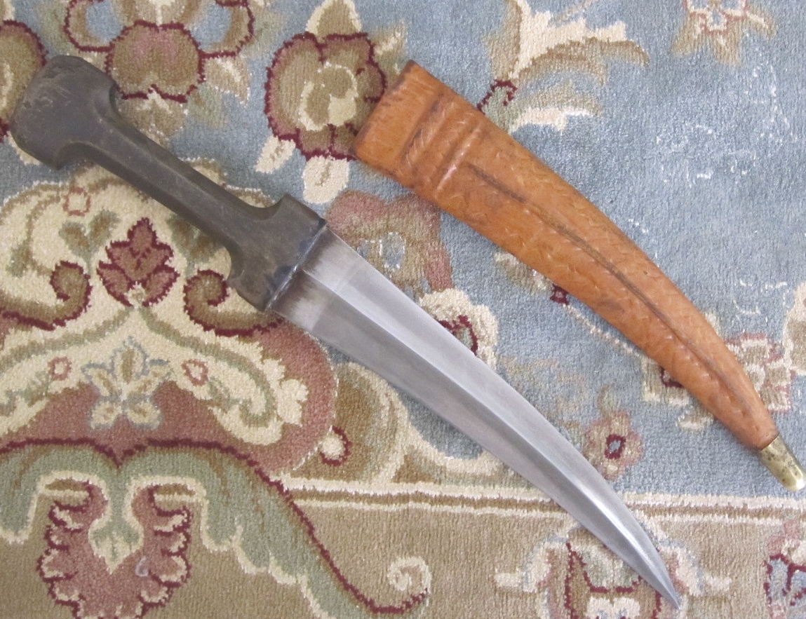

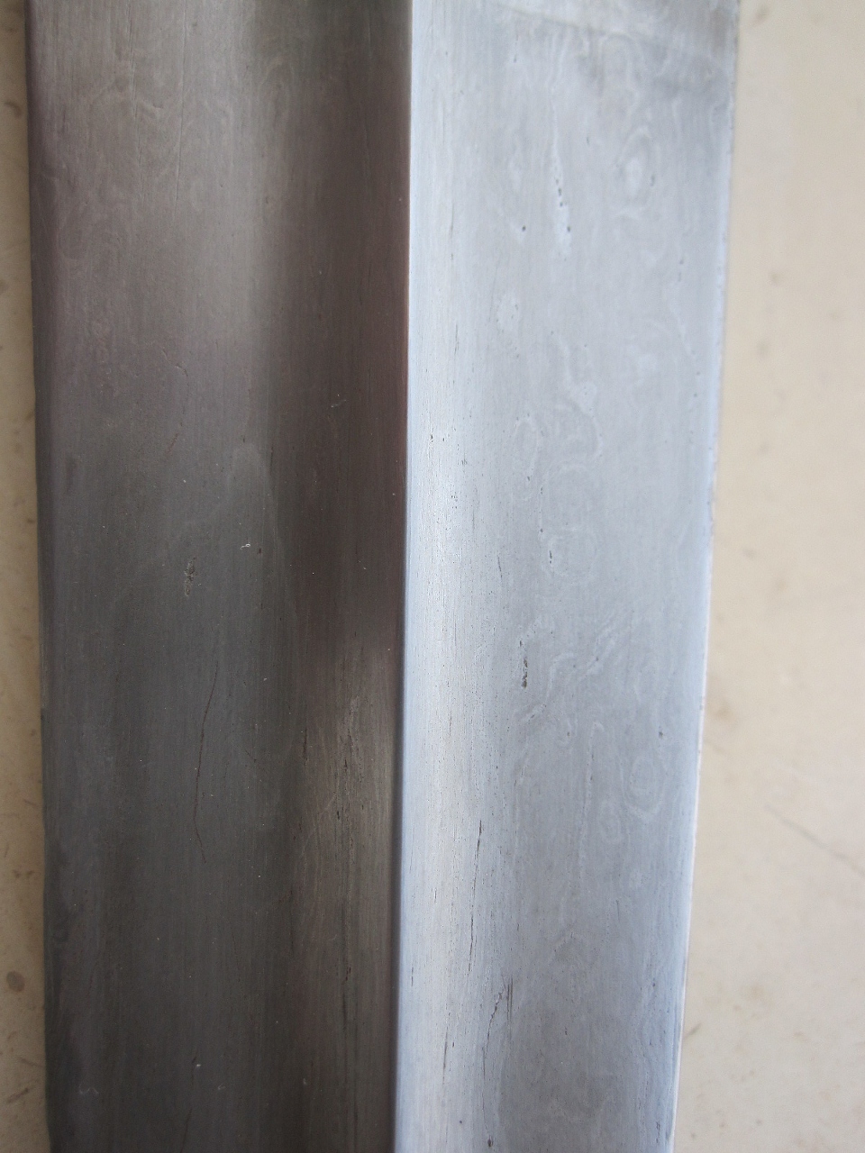

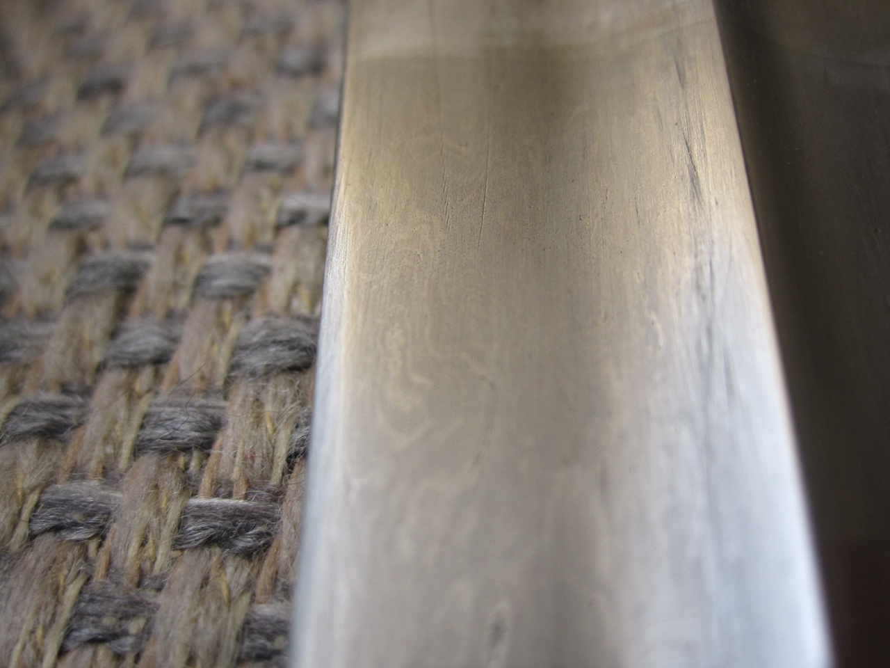

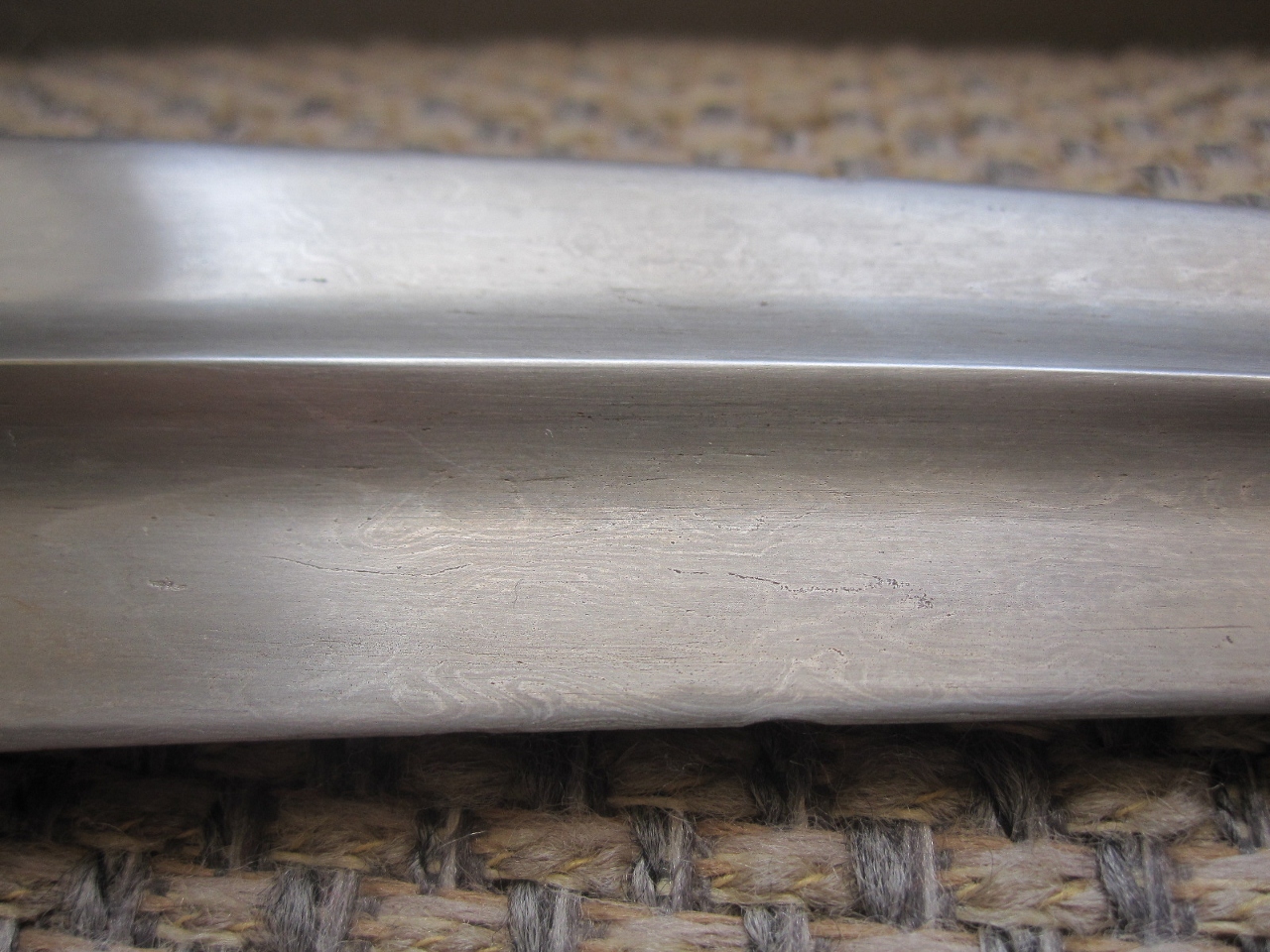

hey guys,
So prior to doing my first etching job I was reading about the process and tried to do it the best I can. I used hot vinegar (almost to boiling but removed it before it boils) before I etched I cleaned the blade and rubbed it with some fine grit sandpaper (0000... or something :P) then I left the blade in the vinegar for about 30 mins and then I cleaned it with some clean cloth.
Anyways, here is the result; please advice if I can improve it, as its very low contrast atm. Or maybe thats how it is?

Hi Lotfy,
On the rare occasion that these are worth etching, it's often difficult to get a pattern to show well.
I've found proper acids and FeCl don't do an effective job and lemon juice seems to work the best.
However, that said, I think you've got a reasonable effect there.

thanks guys!
After etching I used windex (for the ammonia) and then washed it with water. But I am yet to oil it, would vaseline do well?
Guess I wont try to etch it more, would suck to damage it.

Sup Lotfy
The steel on these is pretty soft. You can always repolish with some 2000 wet and dry in a few minutes.
Try it stood in lemon juice for a day or two, then wash off and oil.
