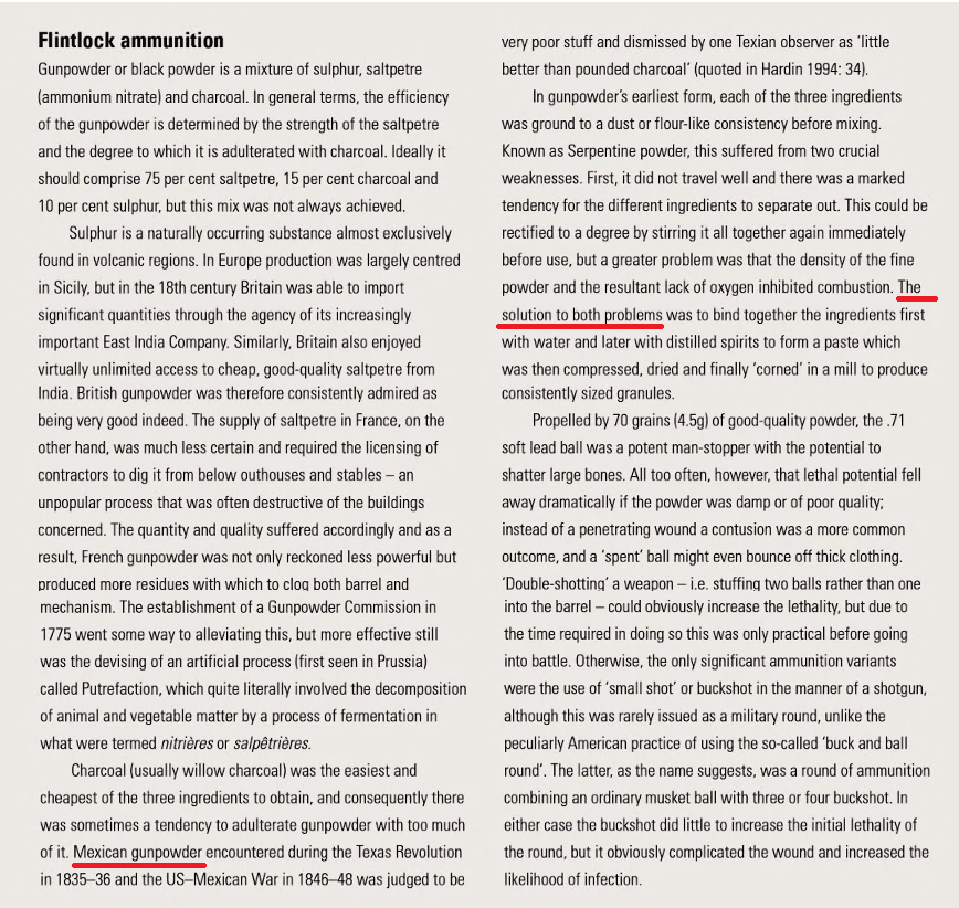

While this sounds like a circumstantial case with poor batches of powder with the Mexican forces, it seems that in 1846, with the Mexican American war, the Mexican powder situation had not improved.
At the Battle of Palo Alto, May 8, 1846, it was noted that Mexican artillery barrages often sent cannonballs bouncing 'lazily' across the battlefield.
Another reference regarding another battle in the 1830s Texas Revolution claims that in that entire day of battle, not one cannonball in a thousand reached the enemy, most fell about half way.
My question is,
Why, in this period of time, with all the attention given to 'Napoleonic uniforms' etc. and the acquisition of all manner of artillery and arms, was there apparently no attention to adequate gunpowder?
The British, who sold the Mexicans tens of thousands of muskets (despite being deemed obsolete) had access to much of the world saltpeter supply from India. Would that not be considered part and parcel to the acquisition of firearms?
The Mexicans had considerable pieces of French artillery, again, France had developed notable saltpeter production.
Mexico itself had notable natural saltpeter resources, near Mexico City as well as others. There were sources for sulfur and of course charcoal.
Yet Mexico continued to produce the absolute worst gunpowder on record, with seemingly no effort for resolution. Why?
It was said the powder was nothing more than charcoal (derisively)..so was it they were inept at the proper concentrations of components? or that they were 'cutting it' with more charcoal due to 'spreading the volume' more?

It's true that black powder was made of just three ingredients. The procurement of sulfur would perhaps be more of a challenge than charcoal (the most plentiful, at least where there are trees) or saltpeter (typically scraped off the walls of livestock stalls and toilets). But aren't there volcanoes in Mexico?
Just having the ingredients is just the beginning. There's the issue of PROCESSING. Saltpeter and sulfur found in nature need to be purified. Having the best charcoal available is as important to a powder mill as to a barbecue chef, so the kiln operator has to really know his stuff. Garbage in, garbage out, as they say.
And just because the expertise is there, there's the question of the will to provide quality. Corrupt governments tend to provide avenues for profiteers taking advantage of lax oversight. A notorious example of government contractors providing substandard ammo could be found in 19th cent. China, where gunpowder supplied to the imperial government was frequently adulterated with sand or sawdust. The cheating was widespread enough for the foundrymen and inspectors in cannon workshops to pass off slipshod castings because they figured that weak powder wouldn't unduly strain a gun barrel anyway. Some excellent cannons and ammunition were made, but in French-run factories in the south of the country (the French trained the Vietnamese to be first-rate gun founders as well, comparable to what native workmen did at Macau and Chaul under the Portuguese). But the pigtailed Manchus who ruled China weren't too preoccupied with the problem -- the military officers' exams still revolved around archery on foot and from galloping horses, à la Genghis Khan, until these tests were abolished in 1905!

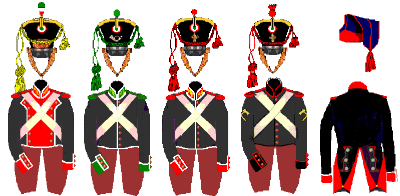

Another question arises over uniforms and while it is clear The Mexican leader was obsessed with Napolionic dress it is odd he opted for British weapons although the Cannon were French I understand. …
The dress question comes up time and again on research on web sources and I point to~
http://johnwayne-thealamo.com/forum/...fcb0&start=160
and offers as a good guide to this entire phenomenon of dress.... Here below is another picture from the same source as to uniforms... It is clear these Mexican soldiers were tough by the fact they wore only sandals for most of their marches... although Sant Anna did try to show an interest in better foot ware for the soldiers later... I note a lot of the soldiers weren't Mexican but Indian and interestingly the point of poor training just keeps popping up.

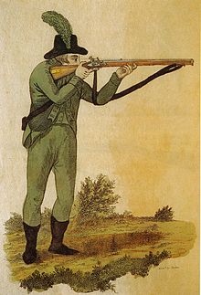

Just to examine the Baker Rifle to some degree~
When it was introduced the weapon was used in special sharp shooting battalions of the British Army...
The accuracy of the rifle in capable hands is most famously demonstrated at the Battle of Cacabelos (during Moore's retreat to Corunna in 1809) by the action of Rifleman Thomas Plunkett (or Plunket) of the 1st Battalion, 95th Rifles, who shot French General Colbert at an unknown but long range (as much as 600 yards (550 m) according to some sources). He then shot Colbert's aide-de-camp, Latour-Maubourg, who went to the aid of his general, suggesting that the success of the first shot was not due to luck. In fact Plunket was using a now famous snipers shooting position lying on his back and the sling in tension around one foot.

Thank you guys for the outstanding perspective which surrounds this topic, and while not of course directly attending to the issues on the gunpowder, the context is certainly pertinent.
The Mexican forces under Santa Anna were indeed widely diverse ethnically, and while Mestizos were broadly considered of Spanish and Mayan mixed ancestry, there were over twenty Indian tribes in Mexico which also accounted for the mixed groups.
As noted, the ethnicity had nothing to do with the efficiency or lack thereof in the tactics and warfare employed by Santa Anna, however it does seem was less than concerned on the well being of his troops, whom he regarded as expendable.
Getting to the guns, it seems that the 'Brown Bess' purchased in huge volume by Mexico (over 400,000) was the Third Pattern M1793 (Windus pattern) designed to replace the earlier Long and Short Land patterns which comprised the two earlier types.
Production of these was temporarily halted with peace with France in 1802, but peace ended quickly, and production heartily resumed. Over three million were produced by the end of the Napoleonic wars in 1815. These were produced under the auspices of the 'Tower' in England, and the term 'India Pattern' was used for them, perhaps due to large EIC orders, of course quite separate from government orders.
Apparently, England decided to dispose of these, as many references deem a consistent reaction of England to peace, so some 700, 000 were sold off to Central and South America as well as Mexico, as these countries took independence from Spain .
So the disposal was not necessarily from poor quality, but from sudden surplus and opportunity to sell them off for profit and restoring the coffers after the long wars. The Baker rifle of course stood on its own merits for its accuracy , it was the ineffective long. heavy and awkward bayonet that was its issue.
I found that the British gunpowder was the 'best in Europe' and they apparently sold much of it to their allies, so I cannot imagine them not selling to Mexico and what countries bought the surplus guns. This was probably (I am assuming) that the tremendous supply of saltpeter coming out of India was the basis for such high quality powder.
This being the case, it seems likely that the powder may have been somehow adulterated or diminished in the also likely corrupt dealings of suppliers handling the Mexican powder.
What I have not been able to find is if it was produced in Mexico, or if they relied on outside suppliers.

If these troops were being supplied with either adulterated powder, or poorly made powder from a Mexican source, then that would explain the heavier charge which caused them to fire from the hip. Not only the recoil, which was powerful as the muskets were initially produced, but the flash and sparks in the face......would have these inexperienced soldiers avoiding such dynamics very quickly.
Could its transport from Mexico have rendered it inert from weather or some sort of alteration to make it less volatile have been at hand?
Jim, here are some tidbits of data that might be germane to your post, put here in no particular order:
1. Yes, black powder can degrade during long storage, or transport in unfavorable weather. Remember the folk saying, "Keep your powder dry!" ? Moisture is the primary threat. In an earlier post on the cannon thread, I mentioned that this propellant has a tendency to absorb atmospheric moisture. In those days, bulk storage was typically in wooden barrels. The best powder in the world, kept for a time in damaged barrels, or those cheaply made from insufficiently seasoned wood, can be compromised by moisture of this sort. As you mentioned, springtime in Texas is pretty wet; I imagine that the whole Gulf region can get pretty damp during hurricane season as well.
2. Degraded or adulterated powder would have been weak (assuming that it did explode) so Newtonian physics would indicate that if projectile velocity were low, recoil felt by the shooter would be reduced likewise.
3. But the ignition of such powder could be more flammatory than explosive mainly due to a sub-optimal burning rate. This would explain the discomforting flash and smoke coming out of the pan and vent. All the more so if the troops were in the habit of overloading in order to ensure the bullet reached the target. Understandable that soldiers would prefer to shoot from the hip rather than shoulder their pieces to aim. Before the advent of metallic cartridge ammunition, shooters often tested powder for freshness by igniting a pinch of it in the palm of their hand. Good powder went off so quickly (it didn't explode unless confined) that the skin would not be burned.
4. Reaction to the force of recoil on the shoulder could be aggravated by negative perceptions generated by the noise and smoke of firing. Especially on the part of recruits who lacked prior exposure to firearms before conscription and who have had insufficient training by competent drillmasters. Have you looked into the standards for musketry training in the Mexican army at the time? (I wonder if it was on a level with that in the Czar's infantry at the time of the Russo-Japanese War, when recruits got to fire just six rounds during basic training because of a chronic supply shortage mainly due to inadequate state funding).
5. We can't go back in time to watch those soldiers shoot and experience the recoil for themselves. So we have to take their word for it, via surviving documentation. However, my experience and that of other modern shooters who have fired replica military muzzle loaders tends to lean towards the perception that the recoil felt on our shoulders (and cheeks) is of a different intensity than that produced by later service rifles using cartridges loaded with nitrocellulose "smokeless" powder. Probably because of the slower combustion rate of black powder, you definitely feel the energy but it comes across more like a robust push than a sharp jolt. Personally, I find the kick of a Civil War-model rifle in .58 caliber to be less uncomfortable than that of, say, a Mod. 1893 Spanish Mauser in 7 mm, or a Mod. 1903 Springfield in .30-06. All three guns are of similar mass, their design makes no allowance for mechanical recoil absorption, and all have straight-wrist stocks. However the bore diameter of the Mauser is half that of the muzzle-loader.

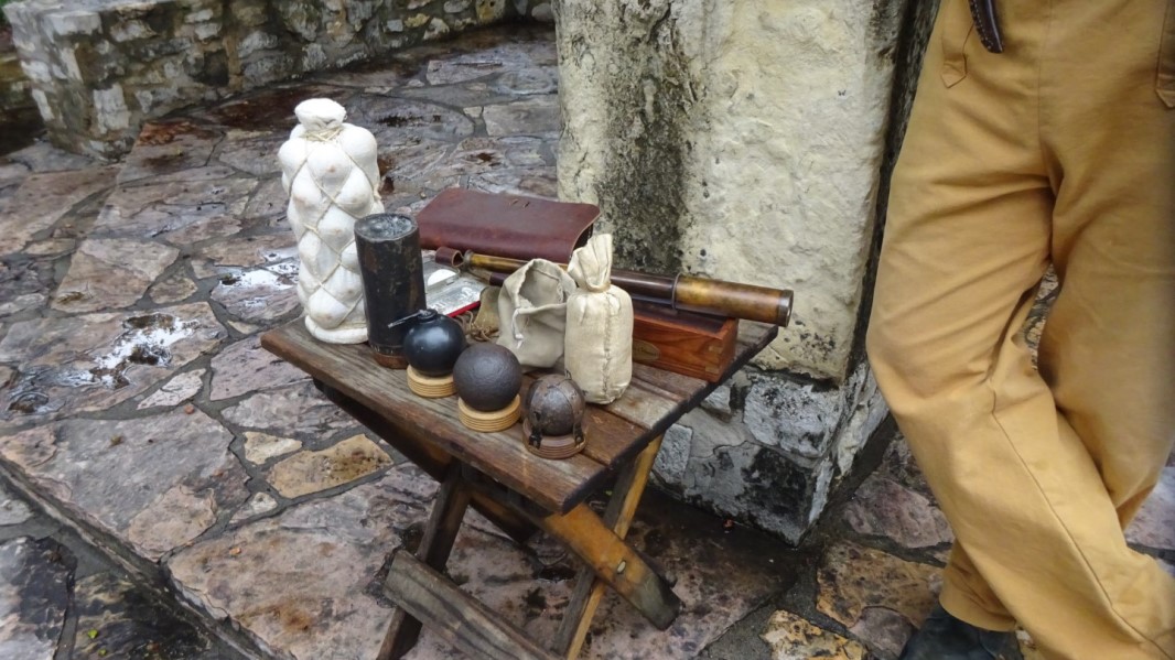

I wonder whether the guy in uniform at the Alamo site went, in his synopsis, as deep as to enlighten the audience on the gunpowder saga. I was too far i couldn't hear him, or understand what he was saying ... a cheap excuse for my lack of patience.

Perhaps the following article by Stuart Reid, not objectively dedicated to the discussed topic, helps cracking the riddle and suggests what the solution to solve the problem should have been; one visibly not put into practice by the Mexican forces.

Fernando, excellent article by Mr. Reid!!! and specifically addresses many of the questions I had toward the Mexican powder issues. In my research I do recognize the anecdotes re: Mexican powder but the specifics Mr. Reid attends to are most helpful. Thank you.
