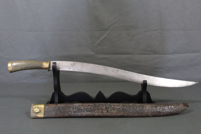

Just 'won' this online, billed as a
"Sword - Brass, Buffalo horn, Iron, Leather - Tjikeroeh Cikeruh style - Indonesia
1st half 20th century ", arriving from France in due course.
LOA is 66cm. (26in.); Scabbard is a bit poorly.
Not too sure about the Tjikeroeh provenance. may have markings I can trace when it arrives. Haven't seen a recurved sosun pattah/yataghan one like this yet. If anyone has any info, I thank you in advance for sharing it.

Hi Wayne,
There's a possibility this one could be from the Philippines (Central/Northern Luzon). Examples of similar recurved blades can be found there, and the full tang hilt with brass ferrules, small brass guard, and a leather scabbard with brass throat are all consistent with that area of Luzon.
If there is a tooled design on the leather scabbard, then it would more likely be Filipino than Indonesian. Otherwise, I think your Tjikeroeh attribution is probably correct. Very unusual blade for that part of Indonesia. Most of the W. Javan Tjikeroeh pieces of European design date from the first quarter of the 20th C, but I have not seen one with such a recurved blade before.

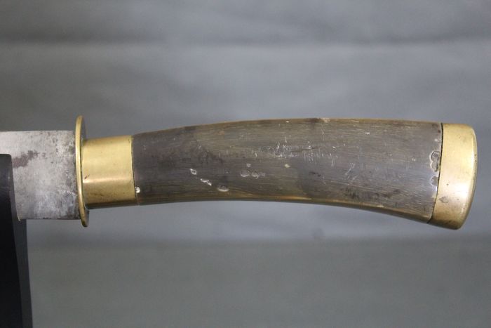

Weighs 358 grams without the leather scabbard. blade is about 51 cm. long, 3.5 cm. wide at the guard, and the flat spine there is about 5 mm. thick. Cross-section feels a bit thicker in the middle, than at the spine or the convex edge. No false edge near the tip. Feels heavy, not a 'machete' type at all.

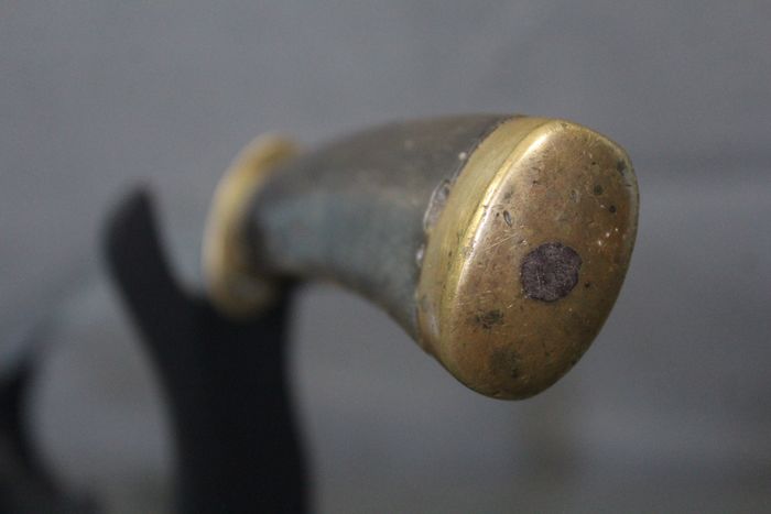

Oval brass guard, 14 cm green horn grip with a brass bolster and pommel cap. No markings at all. Some small bits of insect damage to the horn, shallow and does not penetrate inside. Otherwise tight and firm.

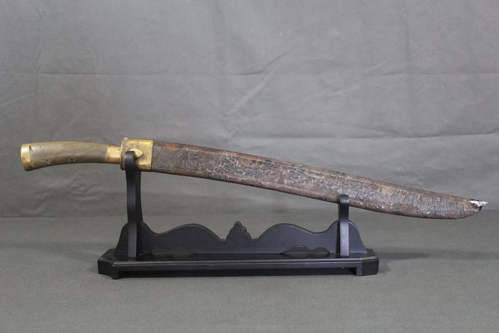

Brass scabbard throat is a bit loose, stitching on the back side of the scabbard is mostly gone, tip is damaged and blade point protrudes a bit. Leather is dried out & needs some care.
