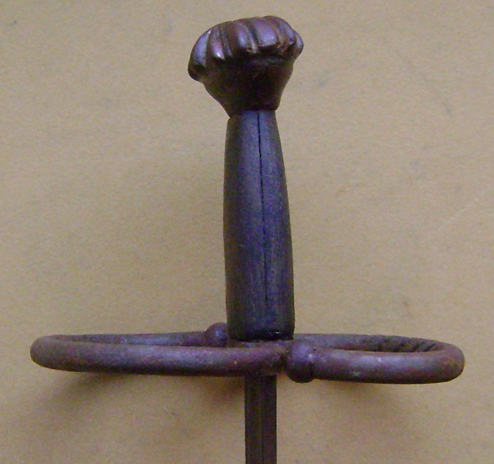

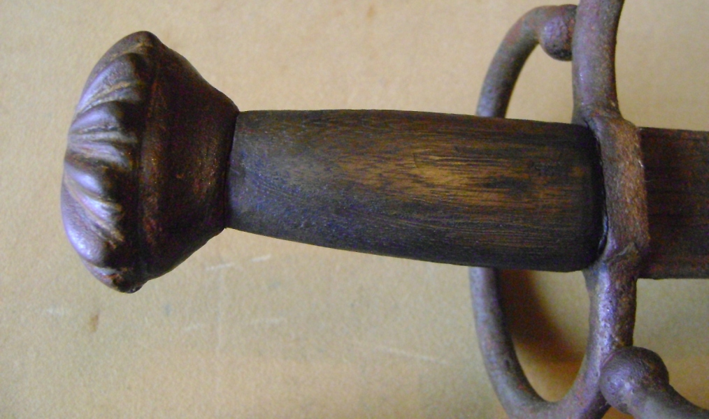

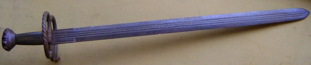

I sincerely hope the knowledge members will give me a help here, in order to correctly situate this sword ... as will also welcome any member to favor me with their coments.

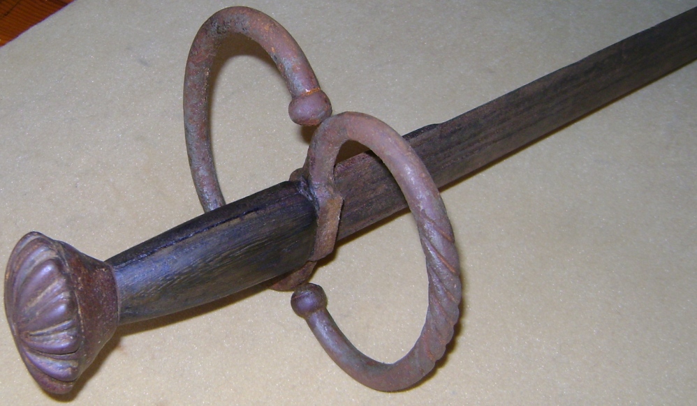

I knew the wooden grip was a (modest) replacement when i acquired this sword, but only now i can check that, who did the work, was wise enough not to dismount the pommel, having applied a grip made of two halves.
My top question goes for the guard; with its 17 cms width, looks to me rather large (unproportional) for what i expected Katzbalger guards would be. Could it be that its owner/user ordered a large guard to better protect his hand?
The seller said that the previous owner called this sword a “composite”; would that be related with the guard provenance?

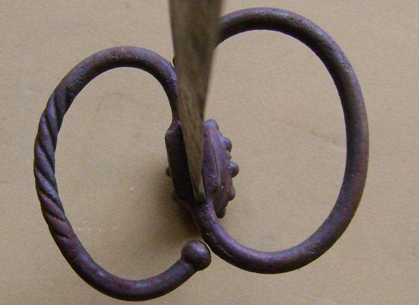

Amazingly only one of the quillons is twisted; is this a typical procedure? i can’t imagine the smith “forgetting” to twist the other quillon.

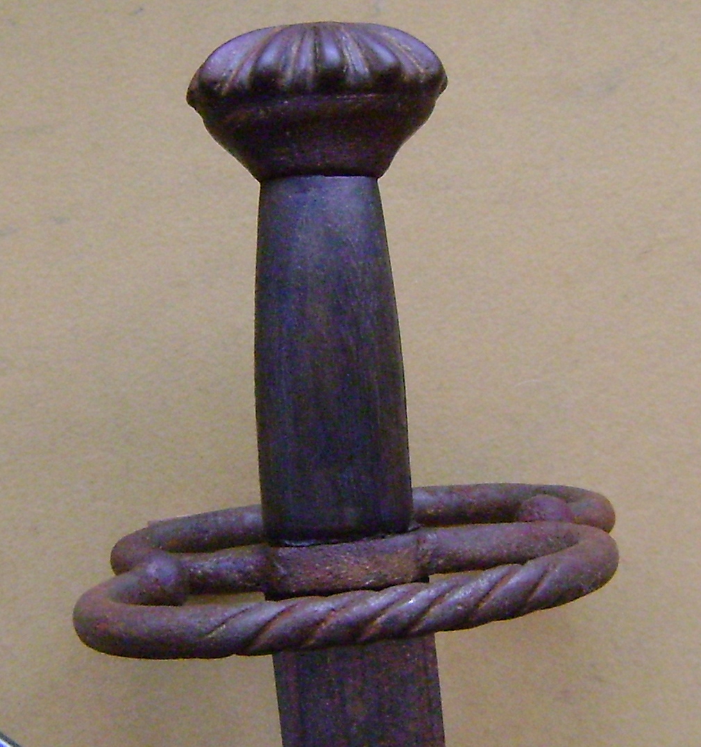

The pommel looks untouched … at least in a recent past.
The blade looks strong and sound, with its 5 mm thickness, 40 mm width and 87 cms length.
Concerning the age, i was told this is a 16th century Landsknecht sword; am i far away from reality?
Any help will be greatly welcome.

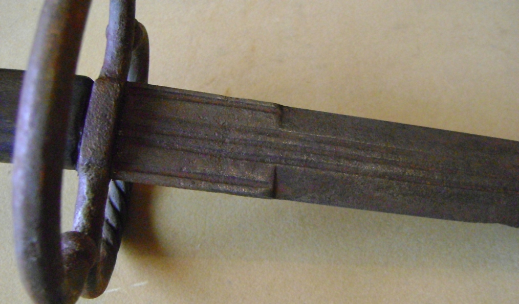

Telling from your good images, I would assume that the blade is the earliest part of the sword. It seems just right in its appearance and proportions, including the short lateral fullers at the base and the central fullers all the way down to the tip, for ca. 1515-20. The patina too is great.

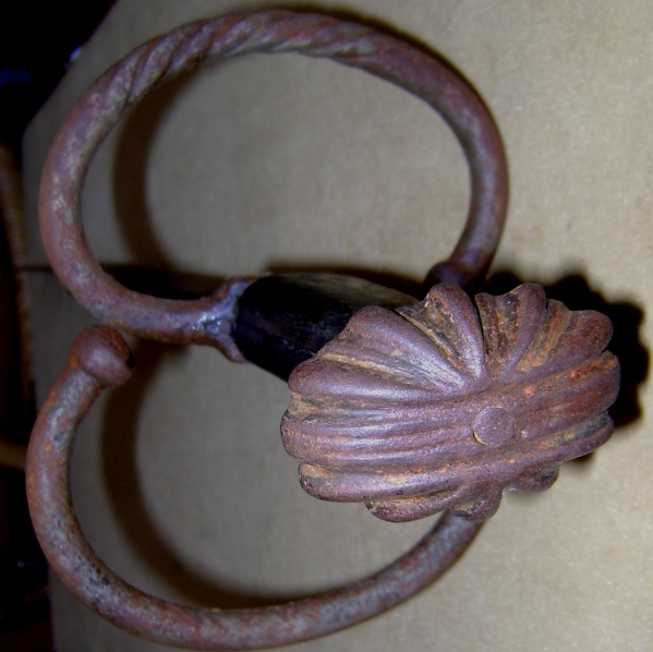

The ovoid pommel with its characteristic bulged shape to me looks like the 1530's, the latest period of Katzbalgers. Though its patina seems consistent with that of the quillons, the latter leave the impression that they might be a later (19th c.?) replacement. The roping, in my opinion, is not explicit enough for a typical period piece; the fact that the roped decoration is only present on one of the quillons might be explained by the surmise that the smith felt it was sufficient just to rope the front part. The general surface of the quillons seem a bit too smooth and 'machine-made' though, at least in my eyes.
Forget about the grip, I would just take off the central bulged area which would add greatly to its impression.
Anyway, I think it is a nice piece and original in at least the main parts which are the blade and pommel. Many of these swords saw secondary use for hundreds of years, and repairs as well as replacements were quite common. Especially the blade looks just as it should, like it saw extensive use.
Congratulations, and best,
Michl

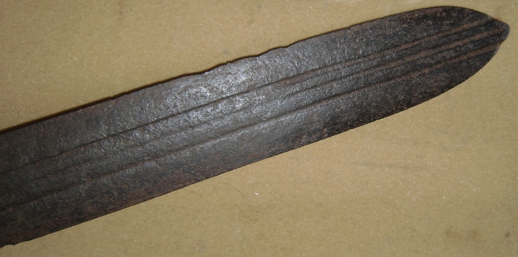

Beautiful example! and the maestro himself, Michael, has well described of course the details of its character. There are few with the knowledge on these that reach the depth of what has been shared by him in his classic thread on these. I think the fullering on this blade is intriguing in that it runs the entire lenth of the blade to the point. I am wondering more on the purpose or convention with this, as of course most fullers terminate far before the point.
Also the configuration of the blade and its fullers overall, the short lateral fullers at the forte, and the triple central fullers correspond well with the Solingen blades in the 17th century which became commonly seen on Scottish basket hilts, along typically with the ANDREA FERARA marking. The triple fullers though of course terminated long before the tip.
In many swords and daggers it seems that decoration and detail tend to apply more to the obverse or outward side of the weapon, as the part of course more visible. Is it possible that the writhen character of the guard may have been done in this manner? It may be a moot point, but worthy of note.
All best regards,

Thasnk you so much for your impressions Jim,
... I think the fullering on this blade is intriguing in that it runs the entire lenth of the blade to the point. I am wondering more on the purpose or convention with this, as of course most fullers terminate far before the point...
I have previously checked this point with someone you know , as also later i observed pictures of some examples out there.
This fullering custom is typical in these swords.
... In many swords and daggers it seems that decoration and detail tend to apply more to the obverse or outward side of the weapon, as the part of course more visible...
As also proposed by Michl ... so, two in one .
