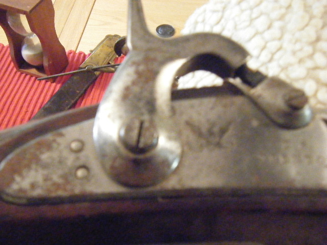

hi chaps, whats the best way of removing rust without wreaking the look of the lock. thanks, michael

Hi Michael,
I've often posted my philosophy that doing less is more. It this were mine I would take out the lock, put a layer of olive oil on it and gently rub with fine steel wool. Never touch the dry iron with steel wool! This way you will get a nice bright polish, with just a few gray stains remaining.

Thanks for that, I just wanted to stop anymore rust forming and kill what was there, will play around later on.

I rely on #0000 steel wool and 3-in-1 oil, working just the area with the 'active' rust with just enough pressure to remove it. I then wipe it dry with a paper towel, wet another one with 3-in-1, and wipe the treated area until I see no more red on the paper towel. Sometimes I have to revisit the spot with the #0000 (again in conjunction with the 3-in-1) and repeat the process.
#0000 steel wool is equivalent to somewhere between 600-grit and 1000-grit sandpaper, so with oil your safe. You would have to try really, really hard to remove patina.
