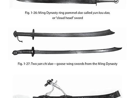

Here's one I found in The Complete Taiji Dao: The Art of the Chinese Saber By Yun Zhang:

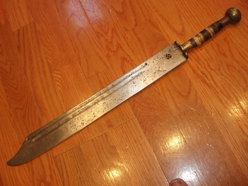

One of the dao types where I most often see clipped tips is in the village “jian shaped dao”, where the clipped tip clearly allows them to thrust as a jian.
Below are some examples:

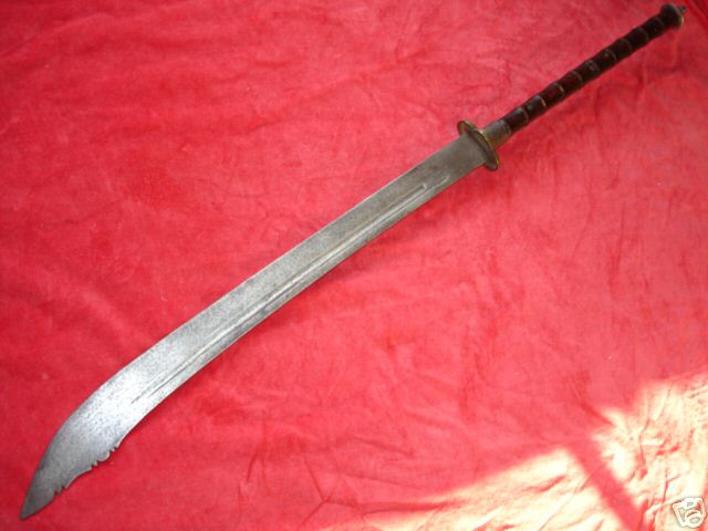

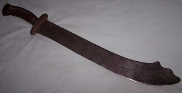

1. A Yi chopper in a style very similar to things seen in Song illustrations. Many minority forms are quite conservative and retain styles from much earlier periods.
2. A wavy tipped dao knowledgeable people have called “demon head”, “yanchi” or “yantou”.
3. A village jian shaped dao.

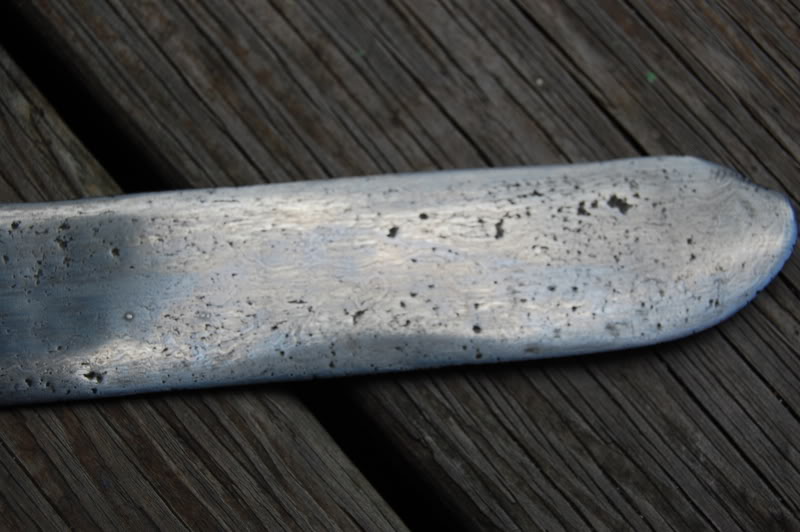

Here is one along the same lines, I think from memory is was listed as an executioners sword now with a New York collector.
To my eye, clearly a cut down pole arm.
