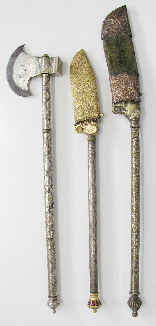

Have a look at these weapons. The axe and the bhuj are decorated in the same way, and are from Kutch. I have never seen a bhuj from this area with another scabbard than the one shown, gild metal with a floral design in relief. The last bhuj is quite different as the haft is of brass decorated in floral design in relief, with a scabbard in velvet, with two mounts of cobber decorated in floral motifs in relief. This bhuj comes from somewhere else in the area.

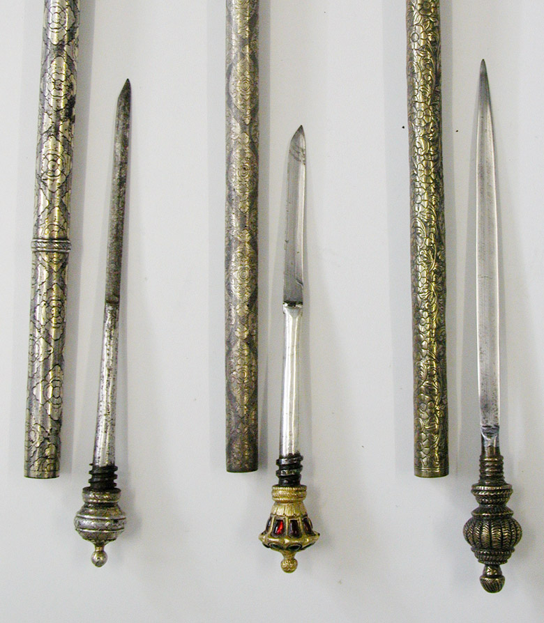

Now look at the concealed knives. The knifes from the axe and the bhuj in the middle are of the same kind, each one has a ‘hilt’, a rather short, and relatively thick, one edged pointed blade. The knife from the bhuj to the right however, has no ‘hilt’ and the blade is a slender two-edged stiletto.
Another thing worth noticing is the screw threads. On the two to the left they are almost sharp at the edges, but on the bhuj to the right the ‘edge’ is rounded.

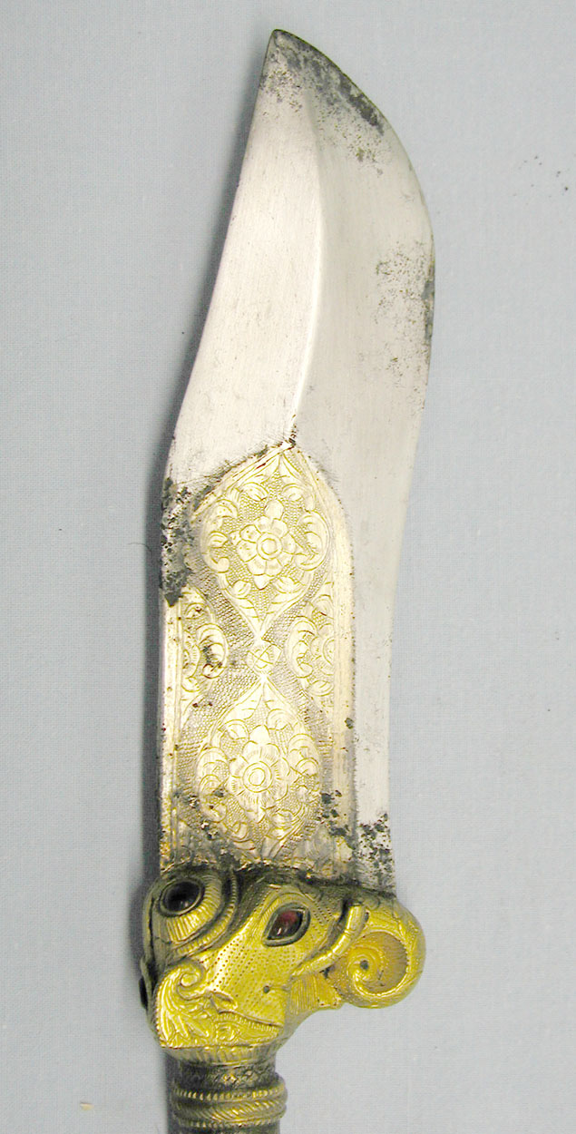

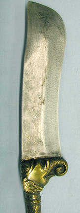

Could we see the blades on the bhuj, please?
Old 24th October 2005, 08:46 PM   #4
Jens Nordlunde
Jens Nordlunde's Avatar
Location: Europe
Posts: 2,718
Here is the first.
Old 24th October 2005, 08:47 PM   #5
Jens Nordlunde
Location: Europe
Posts: 2,718
And the second. Notice the faint silver koft gari.

Gorgeous pieces! Jens, you got my congratulations!
Do we really have to imply that the two Bhujes come from different places with different traditions ? Can't we, in the spirit of Occam, just postulate the existence of two different weapon makers perhaps even living next door to each other? Or two buyers with different tastes?
Old 25th October 2005, 04:20 PM   #7
Jens Nordlunde
Location: Europe
Posts: 2,718
Yes Ariel, you could be right, although I don’t think so. The axe and the bhuj in the middle are from Kutch, and I think the bhuj to the right is from Sind. Two places, geographically not very far from each other, but with quite a different style.
