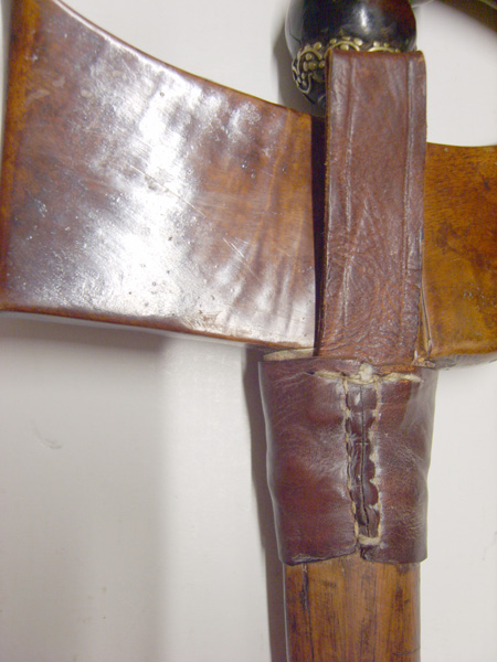

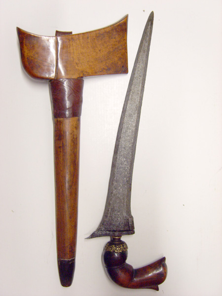

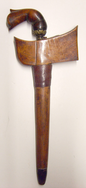

After some cleaning an a pineapple-bath, I would appreciate to hear your comments/information about this keris.
The buntut is made of horn.
There is a leather strap under the warangka, it sits there for a long time I guess.
I do not know if there is damage underneath it, I cannot remove it it’s completely stuck (And I do not want to damage anything).
And I would like to know: is a strap like this original, or is it home made?
Thanks in advance for your effort

Well, belting this keris in this manner seems a bit unorthodox to me. I have some doubts that the leather attachment is original or culturally correct. It may have been added by a Western collector who wanted to wear the blade for some reason or just thought that he would cover damage to the sheath with something utilitarian. The buntut also does not look correct for this sheath form and is probably a collector's repair.
Nice blade...

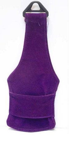

I have one of these made from purple velvet that was given to me by a Collector and friend, Naga Sasra when I visited him some years ago .

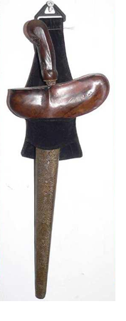

I know there are also versions for hanging on the wall
From which region of the keris world is it from Rick?
That's a very similar one to my example .
Instead of a keris it holds an Afghan sabre .
If I hang one on a wall I use a loop of red silk cord .
Lets you see more of the keris .
I would guess either Jawa or Bali due to his interests .
I did not ask .

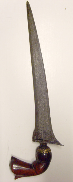

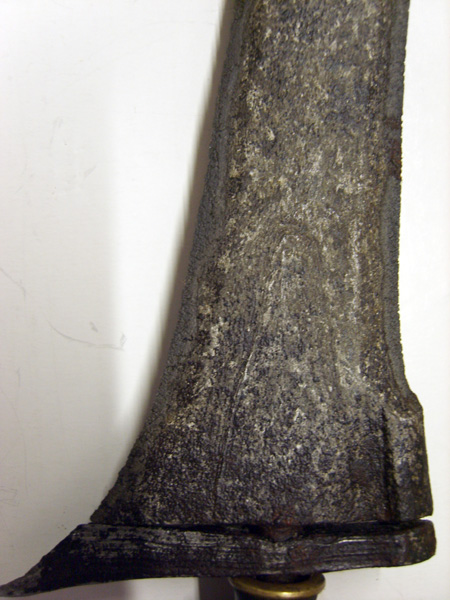

We digress; Sirek, I have a blade that is near a twin to this sepokal .
Does yours have a batu lapak at the sorsoran ?

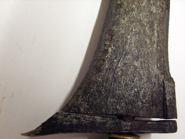

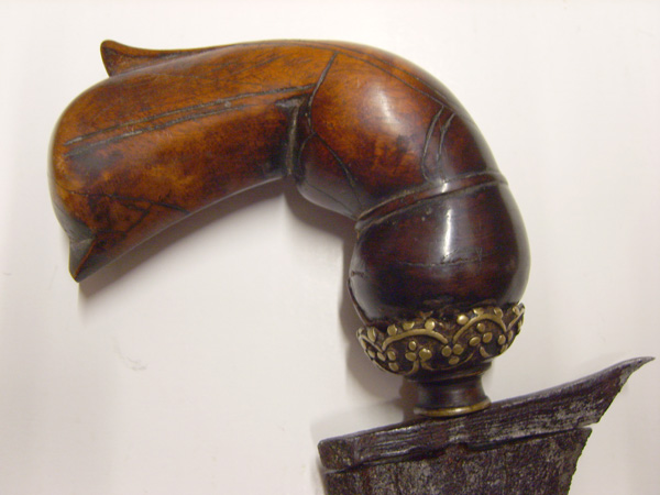

Nice Sulawesi keris. I also think that the leather attachment is not original to the keris. Perhaps attached later for hanging on the wall. The horn buntut form - I've seen a similar one on another Sulawesi keris recently. Thought it was quite unusual, but that other keris was collected from Indonesia.
The hilt looks like it may have had another pendoko with a higher cup in the past, judging from the marks on the buah pinang.
thank you for your comment,
because the low contrast it is difficult to get a good picture
sirek is offline   Reply With Quote

There are two things to take note of in this leather hanger.
First is the probable function as a repair, second is the hanger itself.
I have seen a number of Bugis style scabbards repaired by wrapping leather, cloth, thin metal or cord around a fractured atasan foot. To me, this is a common repair.Not original to the scabbard, but original to the society from which it came.
Similarly with the horn buntut form. I have seen a number of keris with precisely this form, in fact I think I've got a couple at home with this form , at the moment.
The carrying of a keris in a hanger is one of the correct ways in which to wear a keris in Surakarta Karaton dress. The hanger used is similar to the one shown by Rick and the keris hangs at the left front. I do not know if hangers are used in other areas.

Thanks for explanation,
I like the fact that it’s an original repair made in his own environment
as long as it is original and not a recent made I will leave it as it is,
because It has become part of his history.
