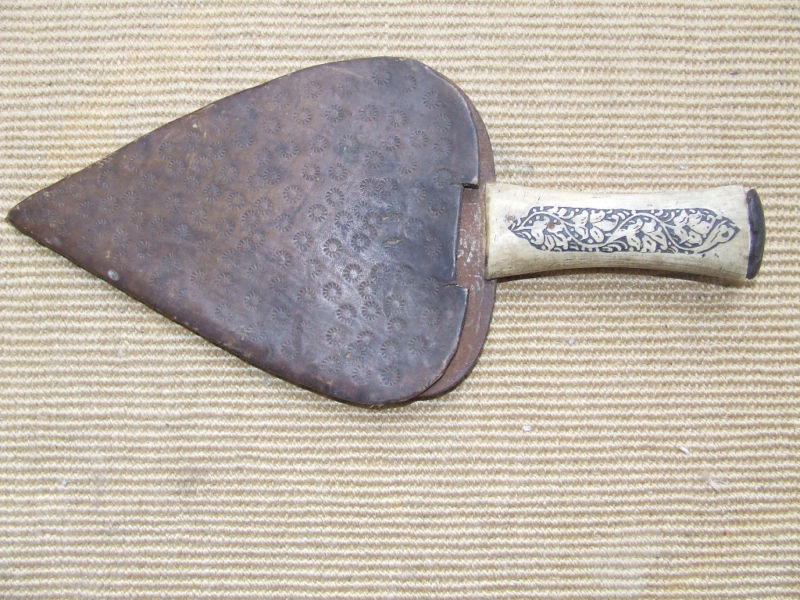

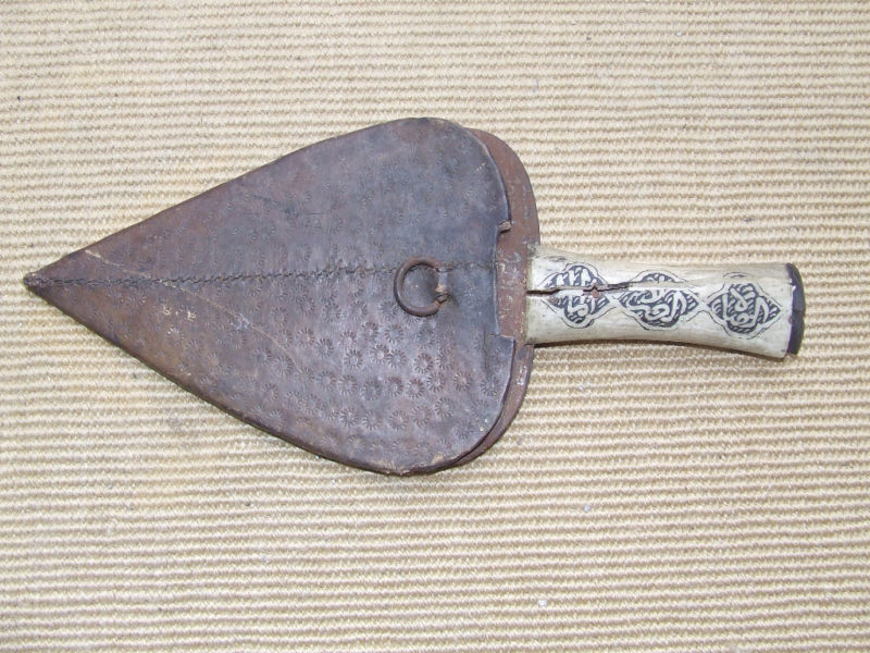

I bought this on a whim, but now after receiving it and seeing the item, cant figure out what it is? Aside from the clover shaped blade, and islamic writing on both side, the leather sheath and hanging ring, the handle is of ivory with islamic writing and design on both sides. Initially one would think it is a ritual knife for possible sacrificial offerings, but i really dont know now.
Any help? anyone see anything like this before.???

The handle looks like bone. Can we see the 'blade'?

Looks like some kind of 'ritual blade' from the 1920's. The blade is etched with arabic writing I guess? Think the handle is not bone but white chalkpaint on wood, possibly to look like (engraved) bone/ivory.
. . . . .or its an early pingpongbat? . . . . . .

This is from the Sudan , Mahdist period. Should have "thuluth" Arabic etching on the blade.
Very nice, especially with the sheath. Quite rare.

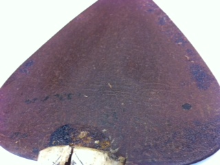

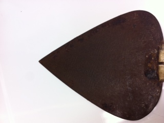

rare, how rare? i have added a few pictures of the blade, sprayed some oil to give it the wet look.

and the handle is not wood. it is bone, now that i look closer at it, it is not ivory i dont think, but definately not wood or a ping pong item as another person stated!!

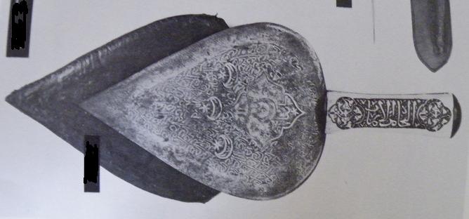

I have seen only 3 or 4 of these over the years, sometimes refered to as "trowel daggers". Here is an image of one similar to yours, from a very old sale catalogue. I've also seen specimens with leather wrapped handles.
As for usage, I don't really see them as serious weapons, more likely symbols of rank/elements of costume. Given the few collected and extant, perhaps they were worn by only senior Mahdists, such as Emirs ??
There seem to be a number of different types of Sudanese weapons that were made from "sheet steel" and with thuluth etching, often copies of Indo-Persian weapons (bichwa, haladie) also Central African throwing knives. Presumably these were all made in the Mahdist period.
Regards.
