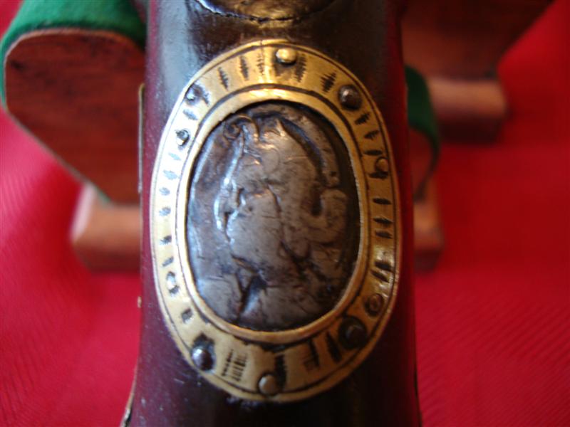

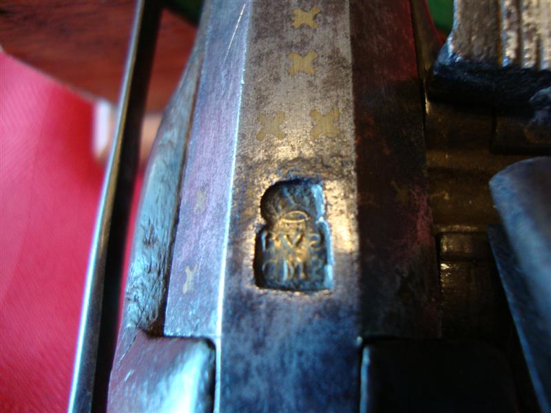

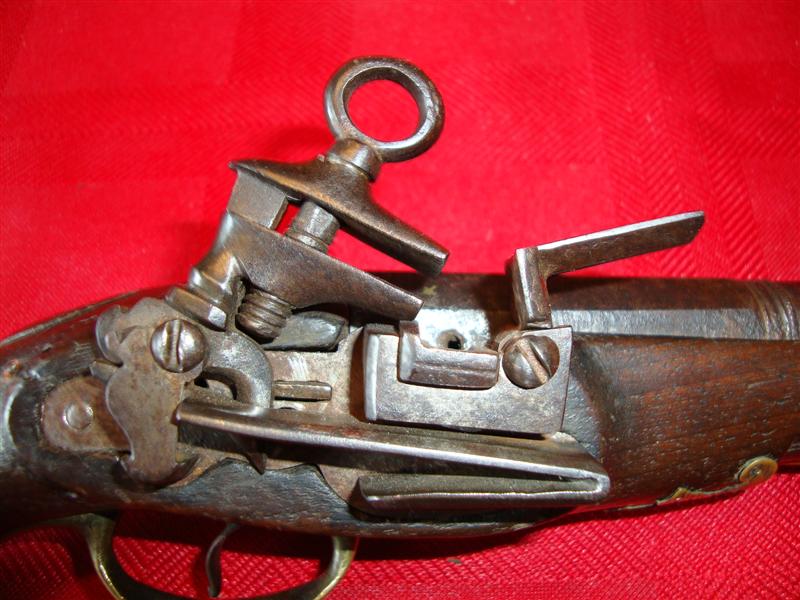

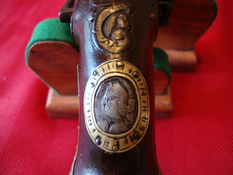

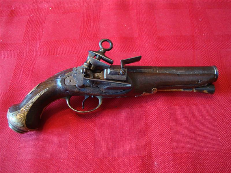

Hello all. My latest aquisition. This Spanish miquelet lock pistol is supposedly the work of one Bustindui of Spain. I know there was a lot of these personal protection type belt pistols made around the turn of the 19th Century. This little pistol is in better condition than most I've seen. Only one small chip on the stock near the muzzle, from a long time ago. And a nice age patina. Anyway, can anyone locate the Bustindui name in their research material? I'm trying to date this pistol. My guess is about 1800?? Any help most appreciated. Thanks, Rick.

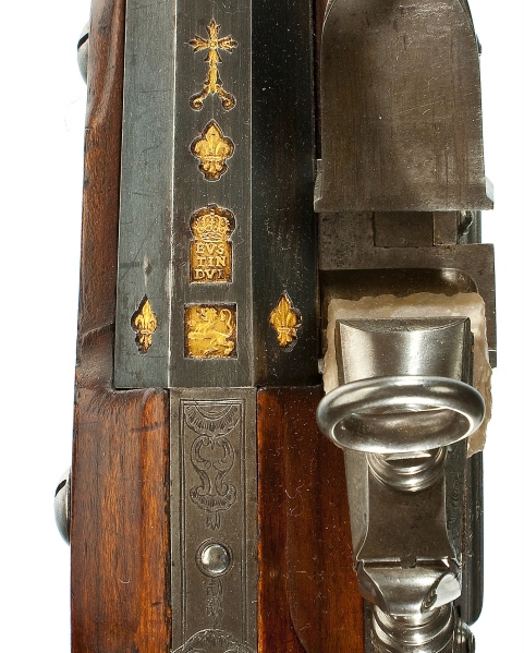

Based on Lavin's book, apparently only Juan Esteban and Santos had punction marks. The crowned initials one on your barrel 'resemble' those of Juan Esteban, but the second punction with a rampant lion is missing right below. On the other hand, the crowned initials should be placed in three rows: BVS TIN DVI.

Hi Fernando. As usual, thank you so much for the information. Interesting family history of gun/barrel smiths. I don't think I'm going out on a limb dating this piece around 1800? Thanks again, Rick.

The four marks shown in the last pic of your pistol barrel are those shown as being used by Bustindui, the top one which looks like a cross sitting on a coathanger, is that of Agostino.

Hi Rick, On looking at the thread again, I suspect that the pistol with the 4 marks is not in fact yours???, but it DOES show the correct marks for Bustindui.

You will notice this is a picture i inserted of a fine fowling piece, attached to my post #2, to show Rick the two Bustindui's punction marks.
The 'cross sitting on a coat hanger' (Latin cross) is a common decor, similar to those used by other masters.

... I don't think I'm going out on a limb dating this piece around 1800? ...
I would certainly think so! ... a few years more, maybe?
