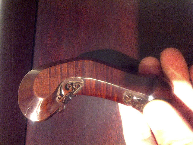

1. Picture# 1: the wood shows "fire" (dont know how to express but you can see the stripes on this picture)

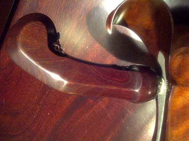

2. Picture#2: they have the "puser" which gives you magical power....
This location was told "good" for man.... One friend show me he got 4 puser in one hilt.

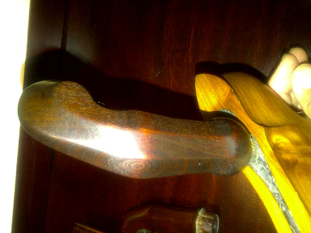

3. Picture# 3: Shiny, crystall clear and no marks. (so no magical power?? )

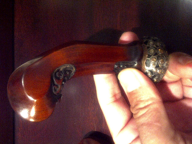

4. Picture#4: Silhouette / Shadow?

When I have to choose between all I get my problems, the one with the "puser" is very nice, the last one have a beautiful grain and the one with selut is nice since the selut is as well from very good quality.

The flame grain in the bottom handle could be called "chatoyant" in English, "nginden" in Javanese.

Maybe you can post a picture of the sheath from the keris to which you want to attach the hilt? I think that this is very important that the hilt matching together with the sheath. I personal like the one with nginden but like I write, this hilt maybe don't look good together with the sheath.
