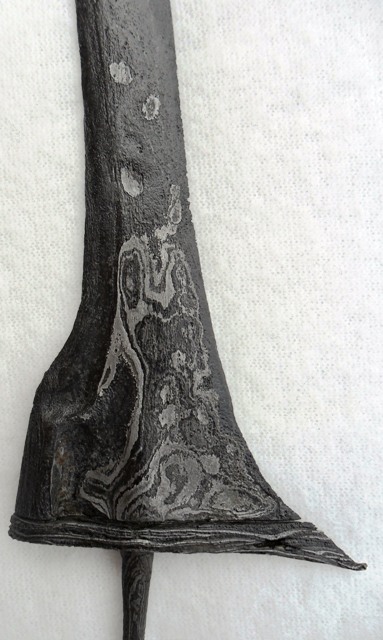

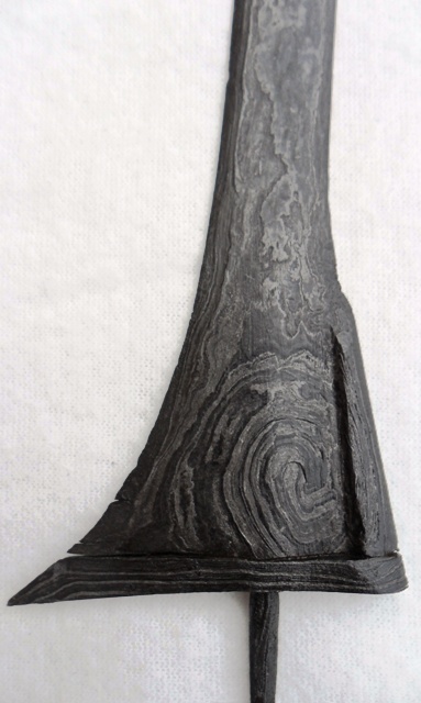

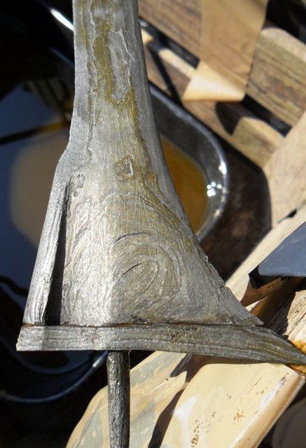

One of the things i enjoy the most in collecting keris is trying to bring blade,s back in a reasonable condition .
Yesterday i did take some picture,s during staining some blade,s and thought it might be fun to show them here on the forum .
Of course comment and tips are very welcome , because i.m still learning and trying what will give the best results .

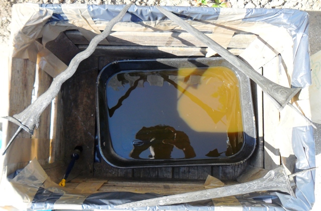

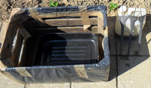

The method i used was the ''soaking '' method in realgar with lime .
i also use sometimes the brush method but the soaking is more easy to do more
blades in one time .
Photo 1 : my luxury washing tube The blade are drying after cleaning
with detergent and lime .
Photo 2 : Drying and heating up after the first soak .

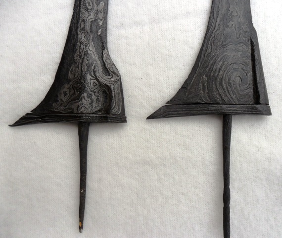

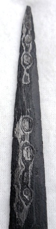

Photo 3/4 The pattern is coming up .

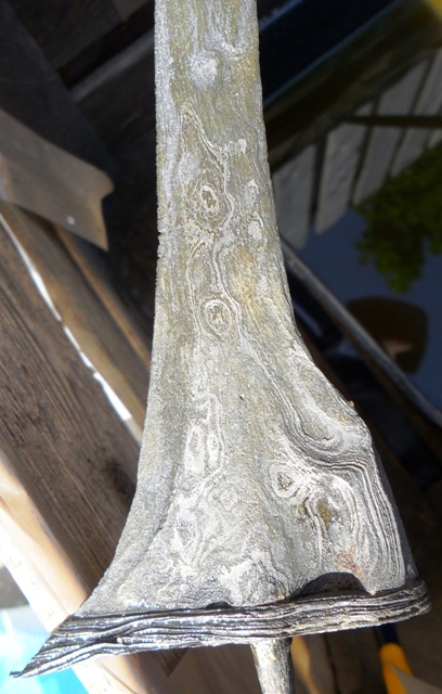

Photo 5 : Finished the soak and drying in the sun before oiling .
Result in the next post .

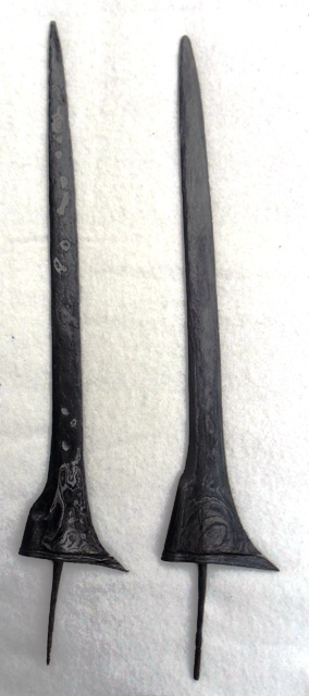

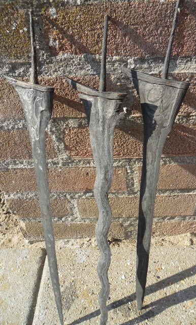

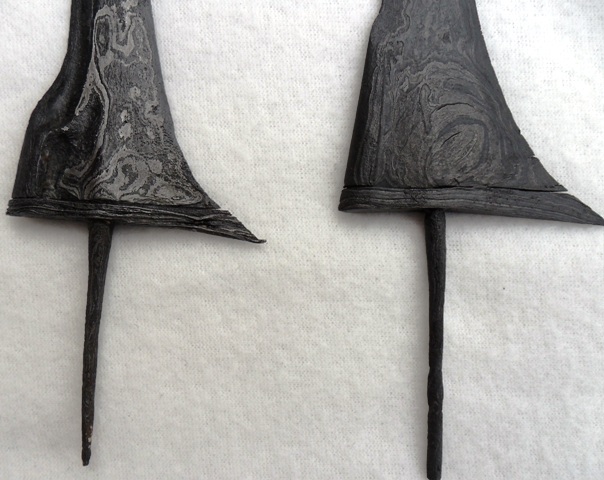

And the result .
After a night drenched with WD 40.
You can see clearly the differences in color of both blade,s because
the using of material and the time when the were made.

@ Sajen.
Thanks , yes the blade,s are old and the are a gift to me from the daughter of the previous owner so even more special because of that
the blade with pamor batu lapak has a twisted part in the middle of the peksi , that is one of the things that always make me think why the did that on this blade ,in bali blades i did see it more often.
