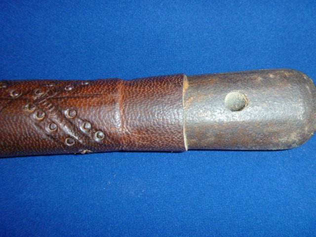

I recently acquired this Omani Kattara and wish to know what should be thru the hole in the pommel. I have seen many pics of these swords with and without a hole, but never with anything actually in place.
Regards Stuart

Stu, congratulations on your latest acquisition. My guess would be that the hole was used to thread a piece of cord through, used to secure the hilt to the hand in a loop and prevent the the sword from being dropped. I am sure there is a proper word for this, I just cannot come up with it right now.
The leather on the hilt looks like a replacement.

Hi Stu,
These kattara really are intriguing swords, and actually have become more present in the collecting community in about the last decade or so, before that they seem to have been pretty obscure. I agree with Teodor that the most likely explanation would be for a lanyard type wristknot, which would of course be understandable in combat situations.
It is also possible that this might have been for addition of some type of decorative or perhaps auspicious festoon. On some Islamic swords there are sometimes a string of beads, usually five, added, though I have seen some of these decorative strands with six.
What is important to note is that the Omani's were primary merchants, and affluent and status conscious individuals wore these swords much in the way the janbiyya (termed khanjhar in Oman if I understand correctly) were worn.
While this example seems somewhat simple in its present dress, the newer leather is nicely added, it may have had much more decoration before. Many of these swords had silverwork sheathing removed over time. Perhaps this now seemingly austere example might have been more decorative in times before, and the auspicious addition idea in accord.
Nice sound example of a sword which carried its influence far and wide in Arab trade sphere, from Zanzibar to caravans across the Sahara, and possibly even influencing swords there.

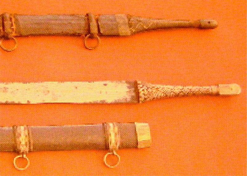

A nice Kattara you have there. Often these have a silver cap but here is a photo of a Sultan with a Kattara that evidently has the hole exposed and unused. You would think that if it was standard to have a lanyard the sultan would have one. It is a mystery.

Yes the leather is a replacement. It looked like this when I got it! A bit of an improvement I think.
Thanks also Michael. I also would have thought that the Sultan would have had something in the hole! The plot thickens!!

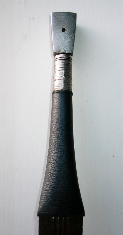

After lots of questions to many different people and several craftsmen khanjar makers and sword makers the answer is ~ its for a wrist strap ! So when you are dancing with the weapon you dont lose it...I think that transposes to the old days since dancing is or was a form of martial art training for fighting.... That the wrist strap prevented total loss of the weapon should it be twisted out of your hand (A common trick with the combination of Terrs shield and Kattara) The tang and pommel are one piece of metal so its not to assist screwing on the pommel and its nothing to do with the devlish nature of Iron nor in fact is it meant to dangle beads from though I can see how that could be used...Phew!!
Salaams Ibrahiim, That DOES answer the original question thankyou. Now for the next challenge......a pic of a Kattara WITH the wrist strap....................

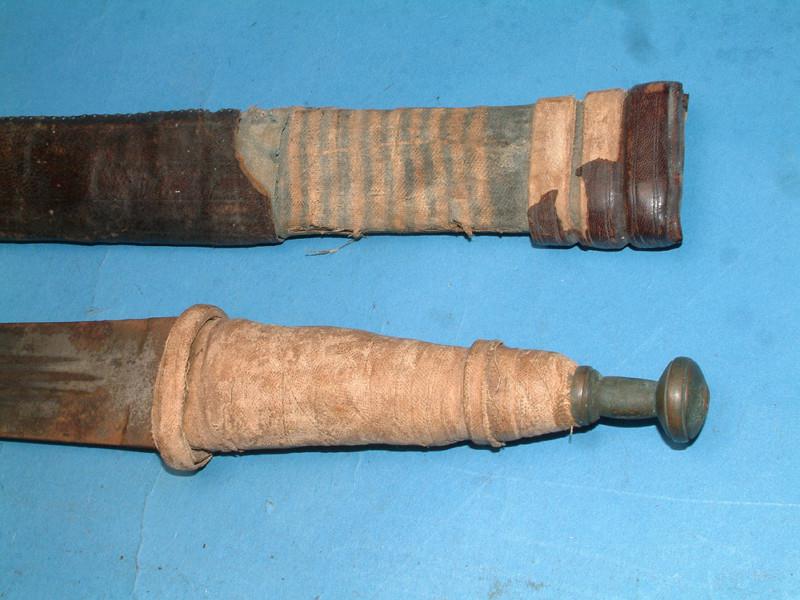

I was going to venture a guess that Since these pommels are of different sizes as are the holes. Could they simply be a fine tuning of the swords balance?
I just purchased one(Omani?) this evening that has a round brass pommel The seller says hilt has original cloth binding. The scabbard is a basket case. Question is what about the round and brass pommel? Thanks, Steve
P.s. Its coming from UK, so it will be awhile.

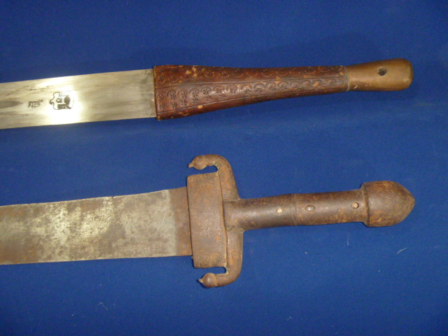

Saw this but not sure that it is in fact Omani. Hilt looks more african to me. Comments from others???????????????

That's a Manding/Mandingo sword - not a kattara. Personally I'm not convinced there's much of a link between the two types, other than using similar trade blades and local copies. The hilt type is simple enough to occur without influence.
Its Mandingo for sure. Its not Omani but as for the influence there isnt enough evidence to not link it to the Kattara design. Personally I think it is very influencial~ my arguement based on Zanzibar which was seized by Oman in 1632 (2 years after they threw the Portuguese out of Oman) being a conduit for weapons from and for Africa the Yemen and Oman etc. My point being that the Omani Kattara didn't exist until that time(or did it?) and the Omani Sword was a short stiff blade with a spiked Islamic Dome shaped Hilt with turned down quillons that I argue could date back to the 8th Century A.D. when Oman adopted Ibathi Islam.
