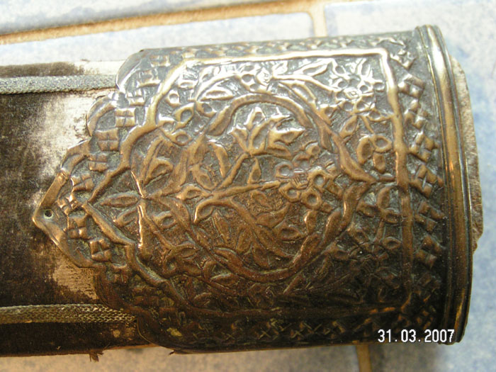

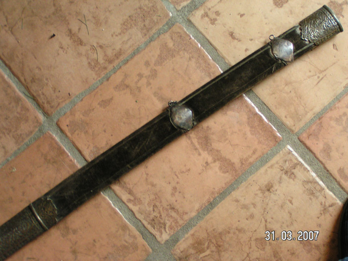

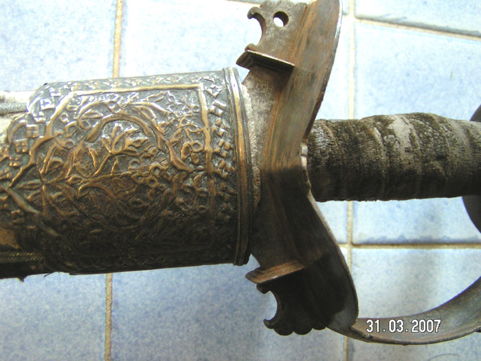

Hello katana.
Tomorrow I would send photographs of my scabbard
galvano
galvano is offline   Reply With Quote
Old 31st March 2007, 10:55 AM   #3
galvano
galvano's Avatar

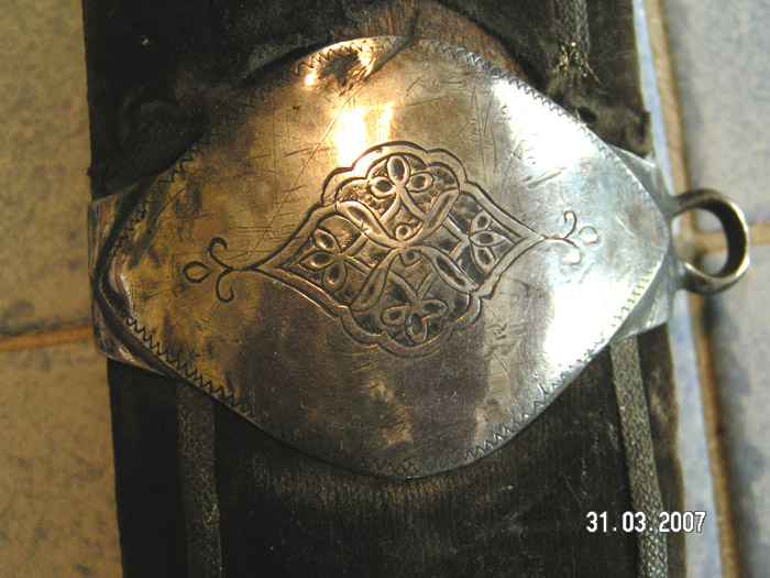

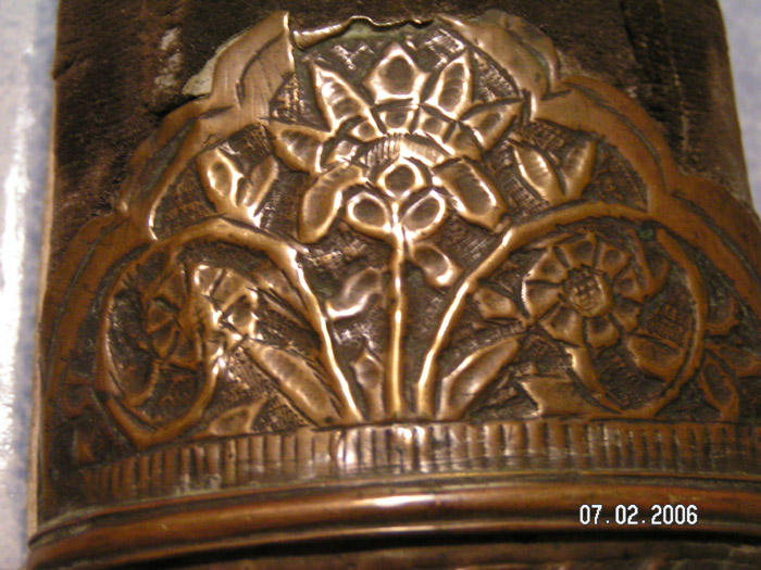

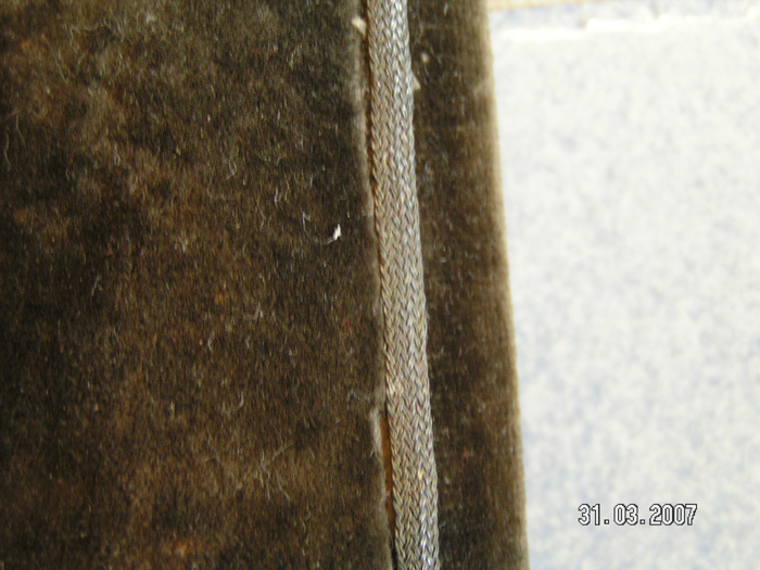

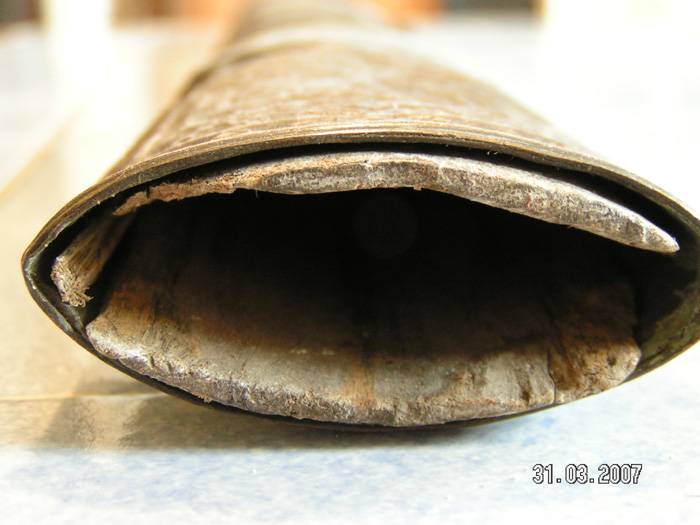

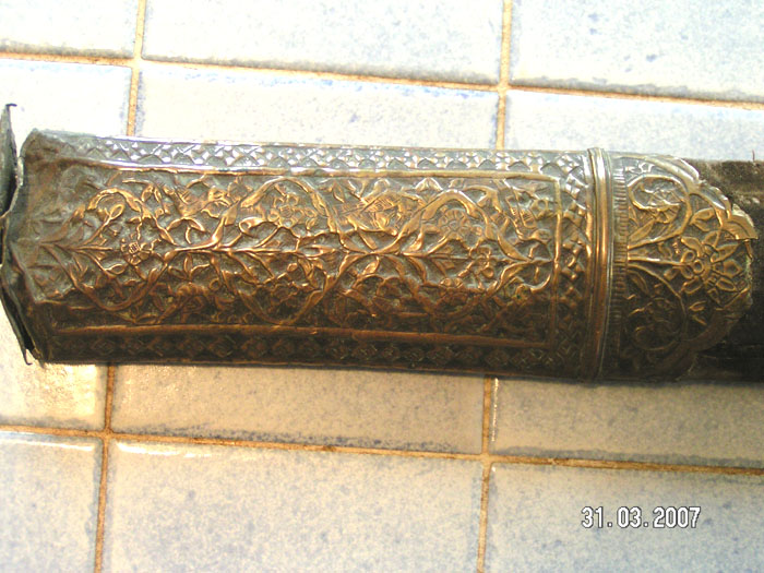

Posts: 178
Default photos
It is covered with velour green

Jens Nordlunde
Jens Nordlunde's Avatar
Location: Europe
Posts: 2,718
Hi Katana,
When making your scabbard, you must decide what kind of scabbard it is going to be, as not all Indian swords were hanging, a lot of them were carried in the hand, or stuck into the belt, but these had no fittings for hanging. If we change from the khandas to the firangis, then I don’t think I have seen a firangi with rings for hanging – maybe be course it was usually too long to draw when hanging from a belt, who knows.
Nice pictures Galvano.

Hi Galvano,
thankyou very much for your time and effort....the pictures are excellent The scabbard certainly has age and is very nice… can't wait to get some decent wood and start making mine

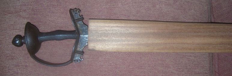

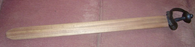

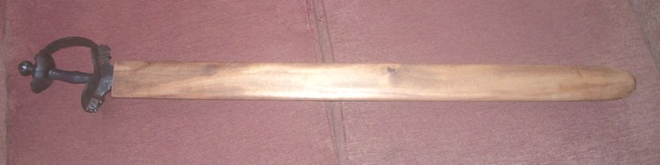

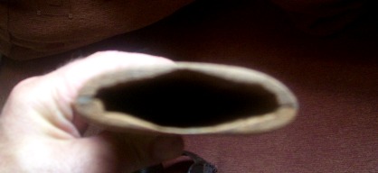

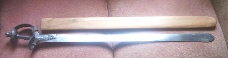

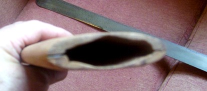

Well. I finally started the scabbard. I sourced some mahogany from a damaged 19th C Victorian chest of drawers, so it is well seasoned.
I am alittle concerned that the scabbard seems to be too wide, especially when compared to the hilt. I can remove more material from either side...but want to keep its structural strength.
Please any comments gratefully received, as I want to get the scabbard 'right' before covering with authentic velvet. Any suggestions as to the colour of velvet. I suspect that there would be cultural / religious / regional reasons for the choice of colour
Old 13th June 2007, 07:25 PM   #7
Posts: 10,857
Nice work on the scabbard Katana! I admire the way you are approaching its construction and acquiring period material and so on. I would note as you asked on the width, it does seem a bit wide, but perhaps once covered and complete not critical. I honestly have seen few of these in scabbards so my opinion probably not well guaged.
On the color it seems that most tulwars have been green or burgundy/red in color, but again not sure on khandas. Interesting thought to consider the symbolic relevance of color on these and I would be very interested to hear more on this. One good source would likely be "Hindu Arms and Ritual" by Robert Elgood. The book on the Figiel collection also has some interesting illustrations of scabbards which I believe were recently furbished for the weapons.
Galvano, nice piece you show there! The scabbard is most interesting as the repousse on throat piece and end as well as the ring mounts seem very much like those seen on saif from Arabia. Elgood has suggested in his "Arms and Armour of Arabia" that the repousse hilt saifs with somewhat similar scabbard mounts were produced for Arabia in Hyderabad. As Jens points out, not all Indian swords were suspended in scabbards with rings, some may have been in a sash carry or over the shoulder belt.

Hi Jim,
nice to hear from you, thanks for the reply and comments . You have re-inforced my feeling that the sheath is too wide. I should be able to slim it down by approximately 1/2".

Katana,
That scabbard looks great. Good job!!!
Look at the pictures of the scabbard Galvano showed, especially the mouth. I also think you can slim the scabbard down like Jim said.
It will do the khanda more justice.

I think that the wood of origin was less hard
Rather a " white " wood.
I believe that the width is good.

Nice work Katana, narrower as the others say would be good, after all velvet will also add quite alot to its width & thickness.

Galvano, I didn't know that most scabbards were of 'white wood', I chose mahogany for its strengh and durabillity. Mahagony was planted in India during the Colonial era.......so there is a chance that the wood I used was grown in India
I have removed more wood from the scabbard and I think it has improved the 'look'. Just need to 'tidy' the 'mouth' of the scabbard
