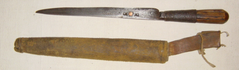

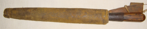

Posts: 432
#7 |
Posts: 5,997
Purple Haze
#8 | |
Posts: 432
to give everything a blue cast to it. Have no idea why or how to not do it. Sorry. Rich |

Posts: 10,858
The edged weapons of these North African regions are as can be seen, extremely difficult to be exact in identifying due to extreme diffusion and hybridization. While this example has every prospect to include it with the 'khodmi' group, it may well be more specifically the common peasant knife known as a 'mous' (mu). In "Knives and Daggers" by Zdenek Faktor (Hamlyn, 1989, pp.30-31) these are described, "...exclusively folk or peasant weapon is the knife known as the mu. Single edged straight or curved blade, usually engraved with quotations from the Koran and simple wooden handle. The sheaths of Moroccan daggers are equipped with a ring to which a silk cord is tied. The dagger is worn on the left hip and the silk cord loops over the right shoulder".
In the illustrations of these in the reference the handle is simple as wooden as described, and with rounded end as yours, however they are guardless, and the blades are much narrower typically, similar to the Moroccan s'boula. Certain features on your example suggest Algerian influence, including the guard, which seems more prevalent on certain Algerian knives and edged weapons there. Also, the interesting circular motif which appears actually is possibly associated with similar Central Asian symbols with ancient ancestry that relates to either sun worship or possibly a symbolic shield, either of these remaining uncertain. In any case, these symbols occur on weapons in Afghanistan and especially the Balkans, from where Ottoman association would have carried into North Africa as it did certainly in Algeria. With prevalent Berber tribal movement between Morocco's eastern Saharan regions and Algeria, it would seem that these would be quite likely for the provenance of this dagger. As always, geographic boundaries often have little to do with the identification of ethnographic weapons in most cases, especially in North Africa. ![]() Best regards, Jim |

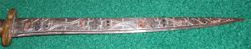

Greetings Everyone !
Here is a closeup digital pix of my Moroccan dagger blade for your review. Any comments are always most welcome and appreciated ! There seems to be several sun shaped ingravings on the blade. Chould the circle desighn be to ward off the 'evil eye'? Best regards, Mark... |
#22 |
Join Date: Mar 2005
Posts: 306
Hello All!
In the book "African Arm and Armour" on Pg.23 first paragraph about the Evil Eye it says "Secondly, to reflect or dazzle the envious gaze by means of a small mirror, or other bright polished object such as a coin or button. An image of the eye itself may also be used in this role." I think that is what the circle design might mean. The outer circle representing the cornea of the eye the inner circle representing the retina of the eye and the dot representing the pupil. Chould the desighns on the blade possibly give a tribal group? Please forgive me if my parts of the eye are wrong but I have not been in health class for a while. Mark... P.S.-Is a Barbary Coast 'Corsair' a type of ship or is it the a crewman, I forgot and now it's bugging me. Last edited by Aurangzeb; 1st September 2005 at 03:44 AM. |
